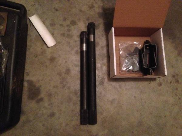

  18. Feb 20, 2015 at 5:45 PM
    #158
    Gear Head
    Gear Head [OP] Well-Known Member
    Oct 27, 2012
    #89921
    4,630
    Jacob
    Winston Salem, NC
    96 Tacoma
    fj60 front, fj80 rear, full hydro, 5.29's, welded, twin sticked 2.28/4.70 duals, 39.5's, inboarded 63's
    Brown Santa finally came. Got my knuckleball gussets, a cone washer, and a short side 30 spline chromo shaft. In the pic the longer one is the fj60 and the shorter one is the mini truck. The long side and birfs are interchangeable.
