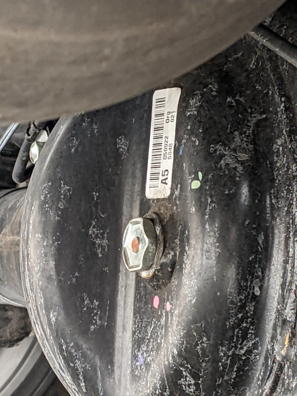

  5. Feb 9, 2023 at 10:50 AM
    #25
    Gerberdude
    Gerberdude [OP] Well-Known Member
    Sep 10, 2022
    #405501
    87
    Alex
    '22 SR5 DCLB
    Mine says A5.
  6. Feb 9, 2023 at 10:53 AM
    #26
    Vlady
    Vlady Well-Known Member
    Dec 20, 2017
    #238986
    4,444
    Issy, WA
    2017 White SR5 DCSB V6 4x4
    Check the code on VIN sticker.

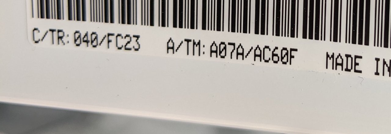

  9. Feb 9, 2023 at 11:13 AM
    #29
    Gerberdude
    Sep 10, 2022
    #405501
    87
    Alex
    '22 SR5 DCLB
    This one?
  10. Feb 9, 2023 at 11:14 AM
    #30
    Vlady
    Dec 20, 2017
    #238986
    4,444
    Issy, WA
    You have 3.91 A07
  11. Feb 9, 2023 at 11:18 AM
    #31
    Gerberdude
    Sep 10, 2022
    #405501
    87
    Alex
    '22 SR5 DCLB
    Tell me what I've won, Johnny!
