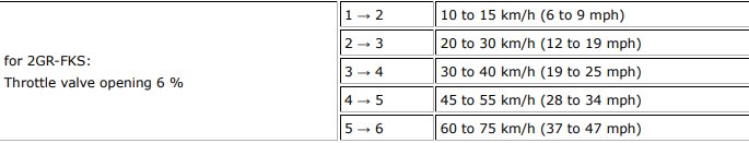

    here are upshift points to illustrate.

    That's not the same for my tacoma. It upshifts later.

    Same here. I suspect you and I are both using more than 6% open on the throttle opening. The way I drive, mine typically will hit 5th gear at 42-44MPH.

    I think there's way too many differences with road conditions, and how you drive (throttle opening) to say that graph would be the norm.

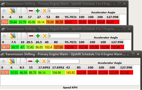

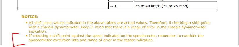

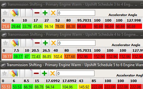

    here is a disclaimer
    BTW. 6% throttle is the accelerator's mid range. Ideally, you shoud monitor Output Shaft speed.
    here is upshift schedule for 3-4.4-5.5-6 from a stock calibration. Speeds are some loose conversions of output shaft speed to kmp

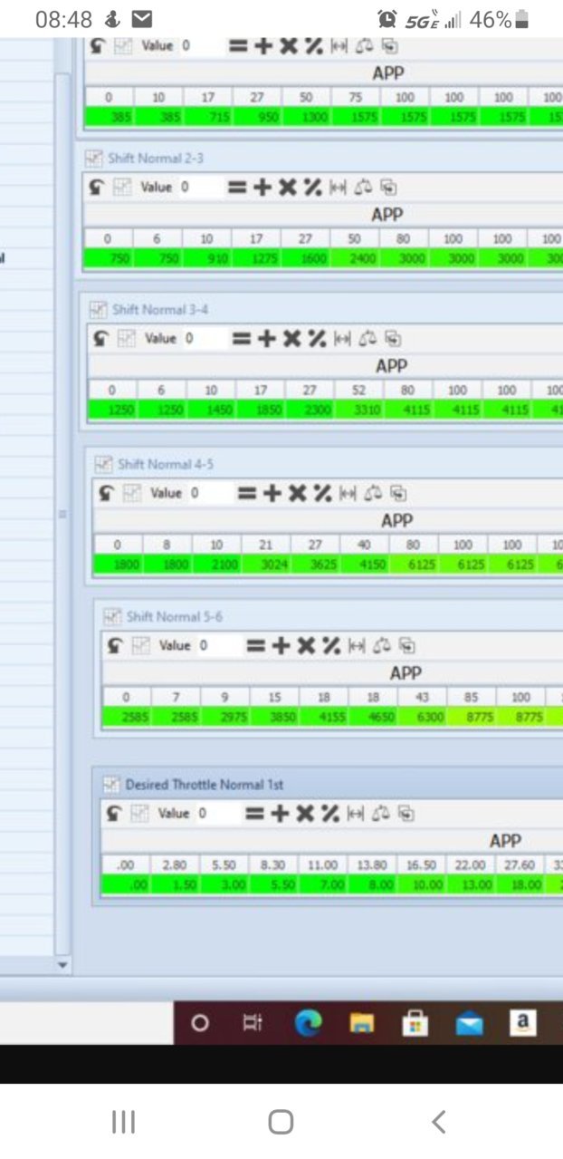

    Here is other software that uses Output shaft speeds

    Can someone process this data into something more presentable?

    why is the throttle only opening 6%? seems like a strangely arbitrary number
