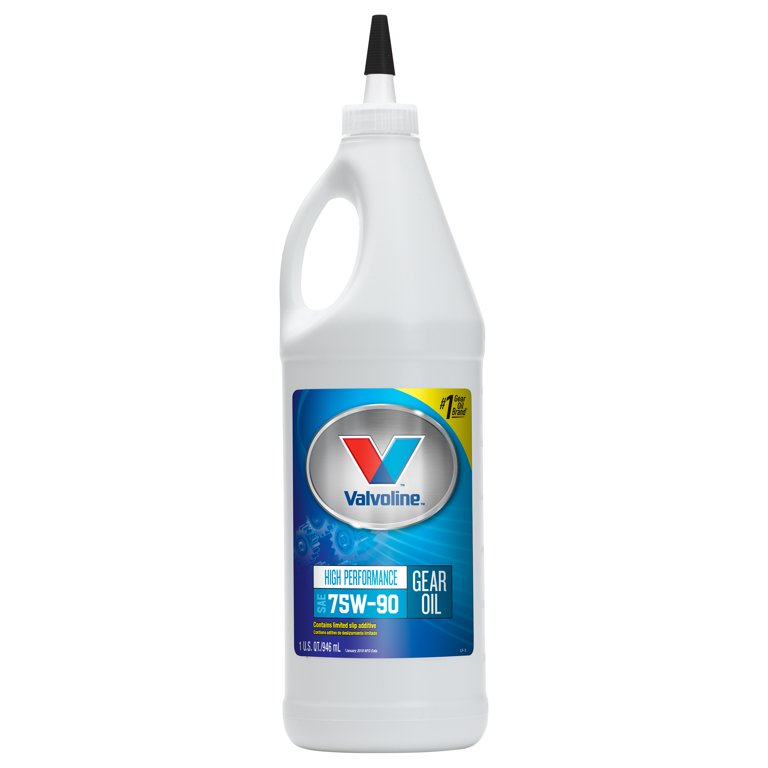

    Just double checking. Would this be okay to use in my 2012? Does having the "limited slip additive" affect anything? Found it for $7 a qt but I'll spend the money for the right stuff if this isn't it

    It wont hurt anything. I've ran it many times and i am at 180k with no issues. No LS on mine either.
