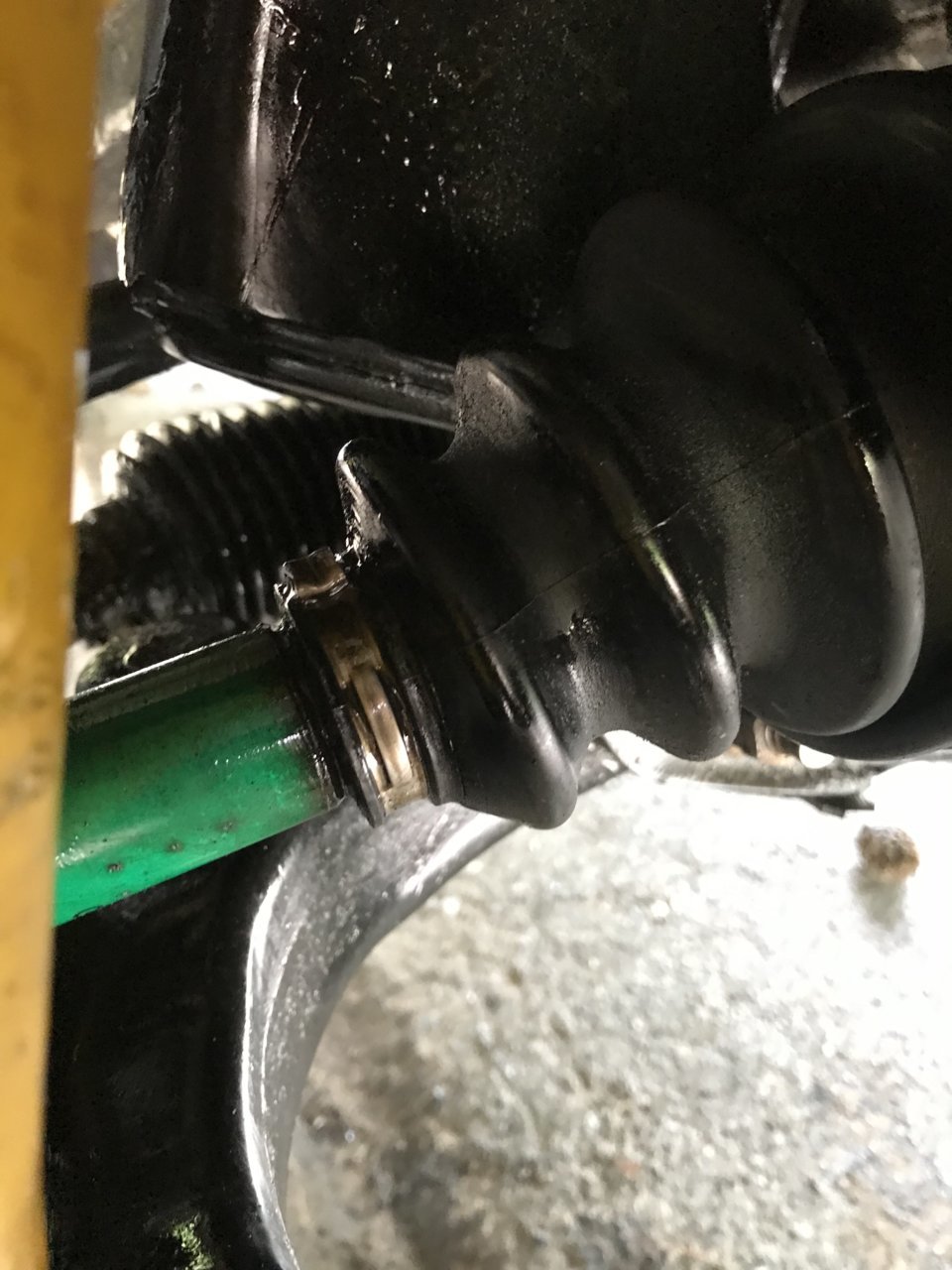

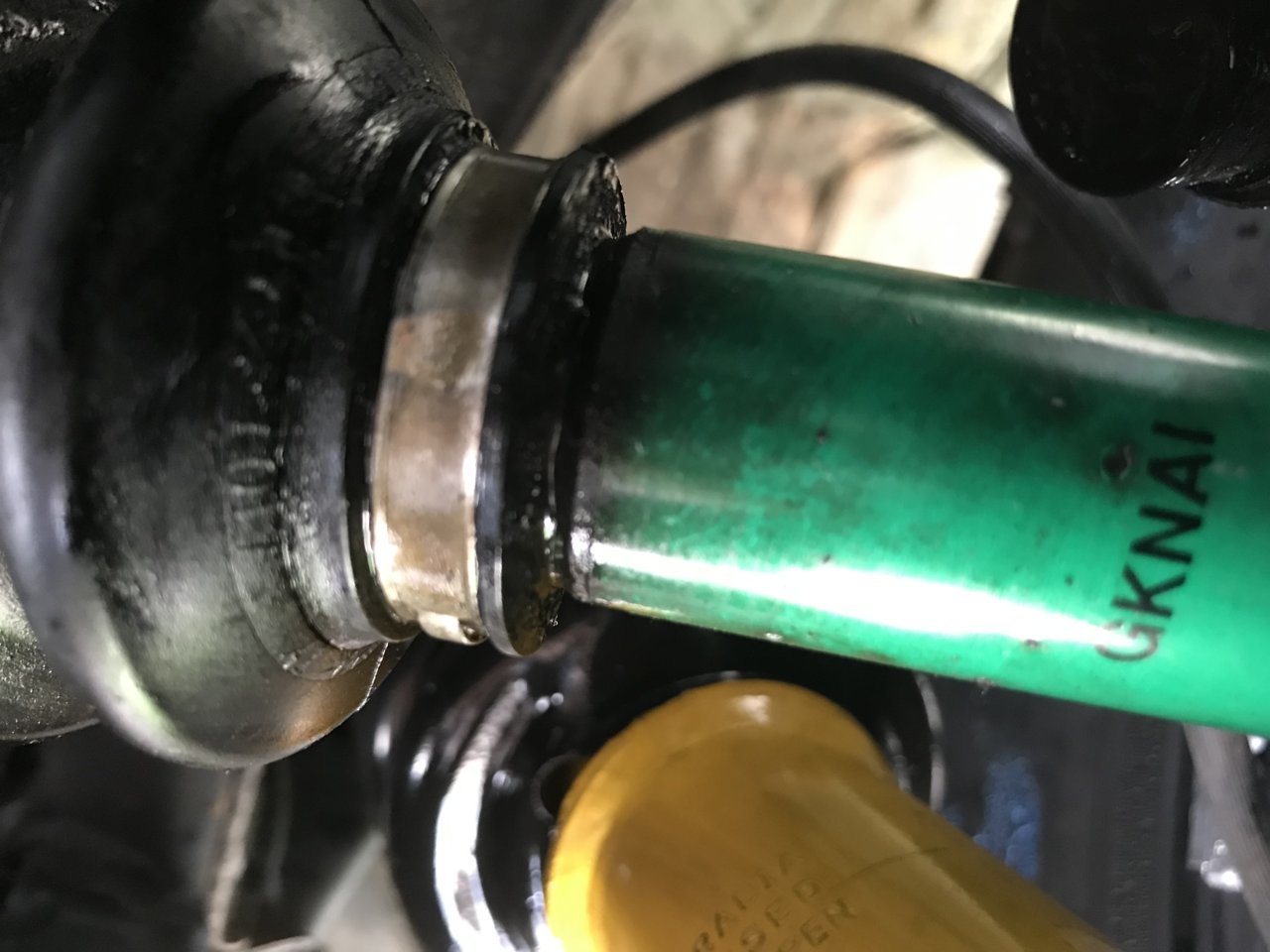

    So I cleaned it up and saw this, is the boot supposed to be this far up?
    Underside:
    From front:
