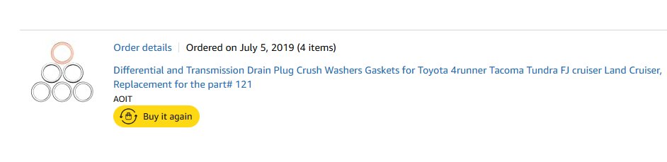

    thanks! i did the job on my 2004 t4r, years ago, and over the years i have a lot of washers for oil changes, ill look to see about the size of ones i have. thanks for reminded on sequence of removing plugs because yeah, dont want to drain if ya cant fill

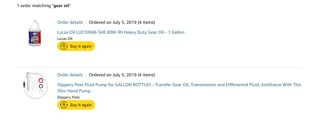

    i love history searches on here, i guess i put this in my 4runner
    tempted to run this same lucas oil!!!!
    never did a front change, but i did tcase, so i want to do front rear and t case on my new to me truck. good point on allen key, tap her in a bit with soft mallet?
