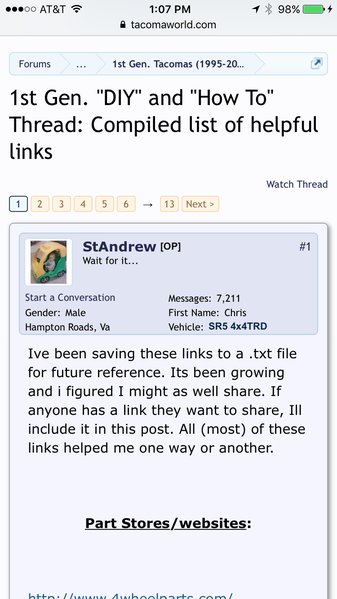

    Check this thread out. It has everything you need to know. Just type that thread's name in
