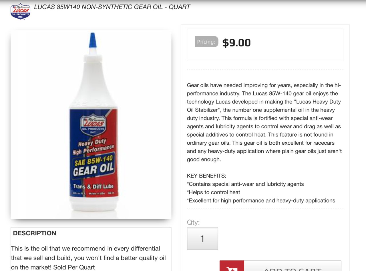

    Direct from East Coast Gear Supply I run Lucas Gear Oil 85w 140 Heavy in both my front and rear with 5.29s and ARB lockers.
