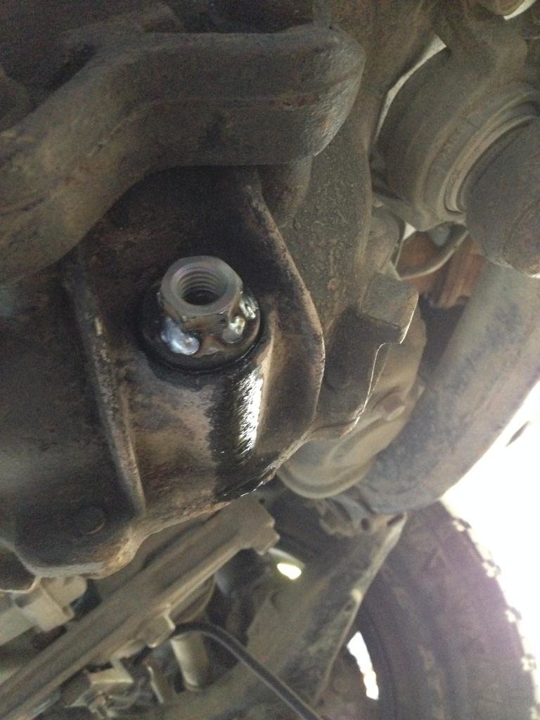

    I've done my own oil changes and gear oil changes before and I've always used AMSOIL synthetic. I was able to change the rear differential oil but the front differential and transfer case drain bolt heads are now stripped. Decided to stop fighting with it and give Firestone a chance. They actually refused to work on it saying that they wouldn't use customer supplied oil and since it's over 100,000 miles they recommended a transmission shop. Something about the sludge build up that could cause other problems if drained. They actually said it could start slipping with fresh oil. Headed to the hardware store to buy a bolt extractor. Before I do this, should I be worried about changing the oil now? Sounded like a load of BS to me. I think they just didn't want to work on my truck because of the stripped bolt heads and customer supplied parts ( I had replacement OEM drain and fill plugs also).

    Just weld a grade 8 nut to the plug and zip it off with the impact.
    E8C5FF8A-C4E2-47DB-AADE-A1AD45163726_zps_87de78d9a50a132ae4c08f1008bf9534ccbd89e3.jpg
    As for the fluids, I would change them, sounds like the shop was just coming up with excuses due to the stripped plugs

    If I could weld this would be a great option.

    Tried this several times before stripping the bolt. Also tried freeze and release to no avail.
