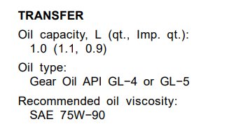

    2012 tacoma 4wd 4l 6cyl.

    As long as it's GL5 probably not gona hurt anything but you may have slightly lower fuel mileage due to it being thicker oil.

    If I told you the transfer case did NOT change between 2007 and 2012, would you believe me?
    And that in 2007 the recommended fluid was 75-90.
