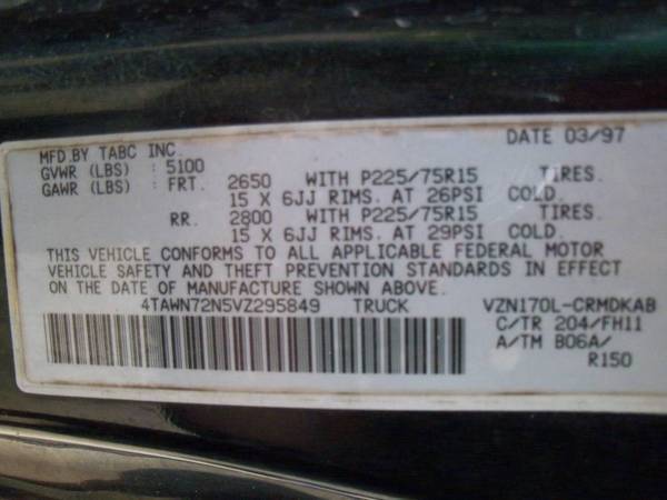

  3. Nov 9, 2010 at 12:04 AM
    WASTE MANAGEMENT
    WASTE MANAGEMENT Well-Known Member
    Oct 17, 2009
    #24467
    184
    Travis
    Umatilla Florida
    97 tacoma 4x4 3.4 w/5 speed
    new 31x10.5 tires, mag wheels, drilled rotors, new sound, and a cb.
    Hey here is a pic of my door sticker, is that the cade in the lower right hand corner?
  4. Nov 9, 2010 at 7:17 AM
    chris4x4
    chris4x4 With sufficient thrust, pigs fly just fine. Moderator
    May 8, 2008
    #6497
    108,048
    FlimFlubberJAM
    Tenoe, AZ
    2013 Rubicon Unlimited,
    4.10 gears, sliders, and lots of buttons.
    Your code is "B06A"
