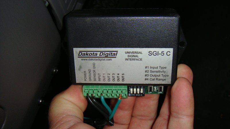

    My truck came with 4.30's new as well. That ratio was horrible even with the OEM 265-70-16's. Hell, I never used the OD.
    If you plan on running 33's from here on out, again, I suggest the 5.29's.
    I turn 2750 rpm's @ 70mph.
    For the difference in the speedometer, I went with the Dakota Digital piece, awesome and quick to install.
