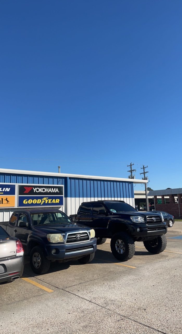

    2008 tacoma prerunner
    So I have a 2008 tacoma pre runner and I’m currently running 37s right now and need a gear reduction it’s a 4.0l v6 6-speed automatic 2wd and I was wondering what gear ratio I should run and I do plane on going with bigger tires in the future since I ordered a bigger lift.
