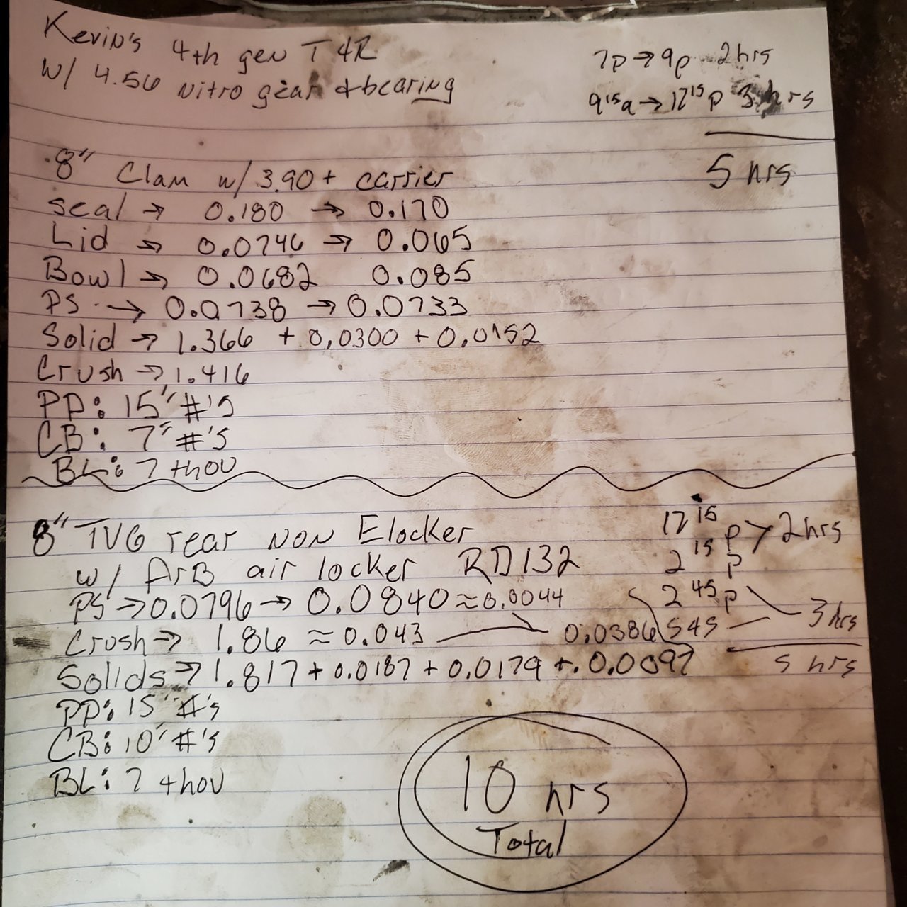

    Ask the shop what size pinion shim they put in. Should be between 0.080" and 0.084". They should be able to tell you especially if they take good notes.

    They said the back lash was set to .009, the pinion depth shim was .076 and the pinion pre load is 12 inch lbs. I asked him about the range and he said they go by the pattern, not the manufacturers general window numbers.
    I'll keep driving for awhile and see if i can live with the sound. Still not happy since i hear the whine at 60 to 75 even with the radio on a bit, but I have perfect hearing so that doesnt help lol.
    You think I should have them eat the labor and cost of a nitro set and hope it gets better? They offered. Last thing i want is for it to get even worse. Heres the pics:

    Whose diff is that? I know for fact its not yours. Thats an older Toyota 8" TV6
