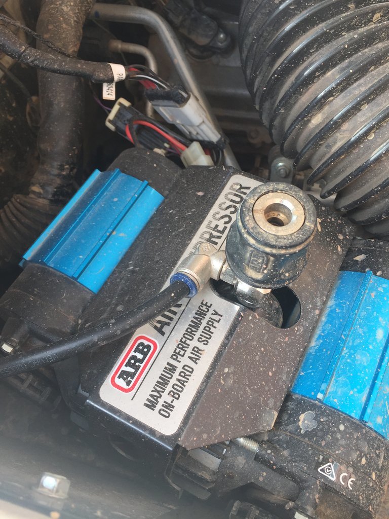

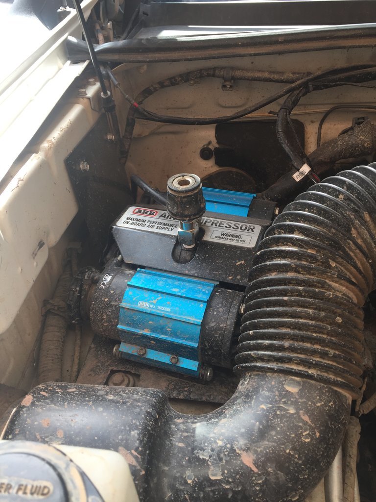

  11. Sep 21, 2017 at 9:27 AM
    #1831
    HolyHandGrenade
    HolyHandGrenade NOOB
    Mar 25, 2013
    #100579
    11,797
    Tim
    Garage Most Likely
    DCFB (RIP)
    Some Stuff
    Mine is 3/8. Looks good.

  13. Sep 21, 2017 at 9:32 AM
    #1833
    Subway4X4
    Subway4X4 Shameless Copy Cat
    Nov 10, 2015
    #169260
    11,647
    Lloyd
    NY/NJ
    05 Speedway Blue DCSB OR TRD
    Everything TW members recommend
    How did you mount the quick connect in the cubby? Is there a bulkhead fitting that I need to buy?

  15. Sep 21, 2017 at 9:34 AM
    #1835
    fatfurious2
    fatfurious2 [OP] IG: great_white_taco
    Jun 28, 2014
    #132884
    48,574
    David
    Ashburn, VA
    2010 TRD OR Access Cab
    I just drilled a hole. The back of the connector is threaded. On the underside i have a 3/8” female air line to threaded. Let me try to get a picture
    MarX likes this.

  17. Sep 21, 2017 at 9:52 AM
    #1837
    HolyHandGrenade
    Mar 25, 2013
    #100579
    11,797
    Tim
    Garage Most Likely
    DCFB (RIP)
    Some Stuff
    I wouldn't trust that plastic line coming out of the compressor. The air gets quite hot coming out. I have a braided line going to the tank from the compressor, then 3/8 plastic to the manifold etc.
    A bulkhead fitting is the proper way to do it.

  20. Sep 21, 2017 at 11:01 AM
    #1840
    fatfurious2
    Jun 28, 2014
    #132884
    48,574
    David
    Ashburn, VA
    I have it clearanced. Its been good so far, dont jinx me.
