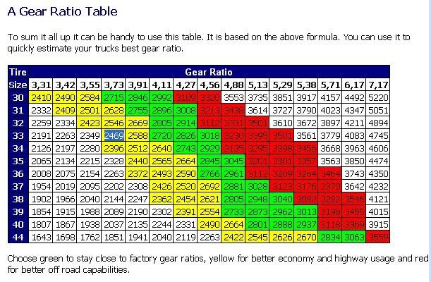

    This chart seems to disagree. Your assumption is that with 3.73 there is serious lugging and with 4.1 there isn't.

    according to that chart I would be in the green

    And you are in the better mpg yellow now right 3.73 and 33s.

    ya in the yellow now and would move to the green if i did the regear
