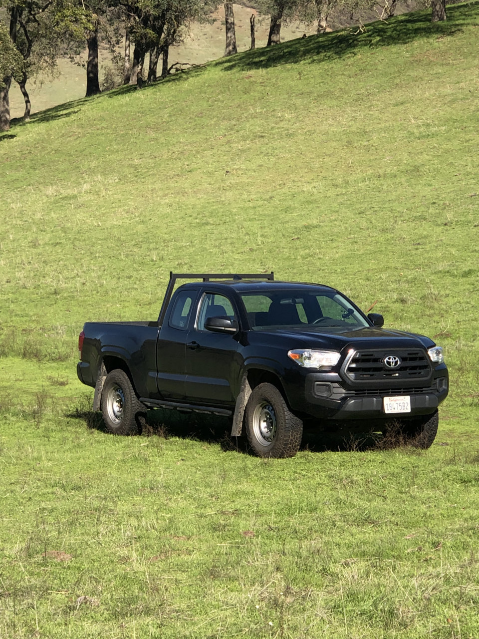

    Here is a picture of my truck to make this post more entertaining:

    Oh, also that's a super cool config. That's a truck that'll last till the end of time.

    Thank you!! The last of its kind.
