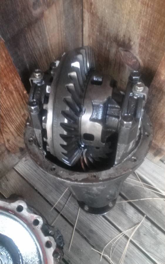

    I pulled a 4.11 rear diff out of a 97 4runner non locker and wanted to bolt it into a Tacoma axle from a 96 non e-locker. I'd did not fit. The bolt pattern was smaller on the diff then it was on the axle housing.

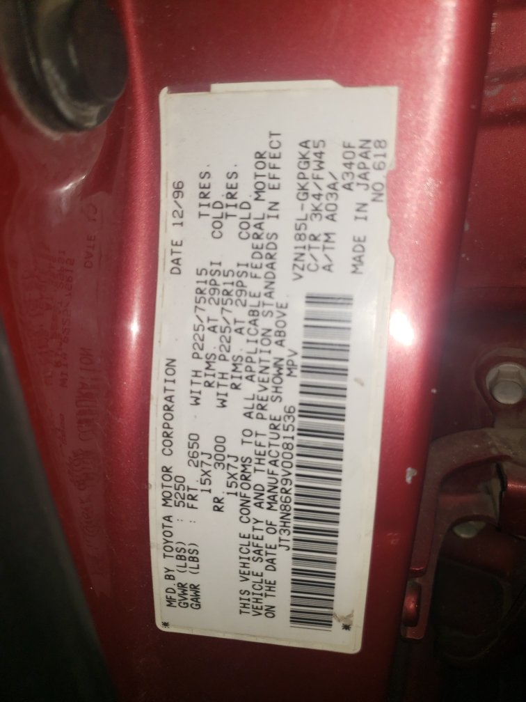

    short of crawling under it and trying to guestimate a measure, is there any code on the door that will say what I should have? The truck is all stock.
  20. Jul 27, 2019 at 8:31 PM
    #20
    Tour991
    Tour991 Supplier of used parts
    Nov 24, 2011
    #67616
    10,702
    James
    South Reno/Tahoe
    97 2/4wd, 2014 DCLB 4x4, 99 T4R Limited (sold) 2024 4runner TRD Pro
    Yes, on your door jam sticker drivers side. It will look like b02a bO3a exc...
    https://www.tacomaworld.com/threads/oem-gear-ratio-chart.365138/
