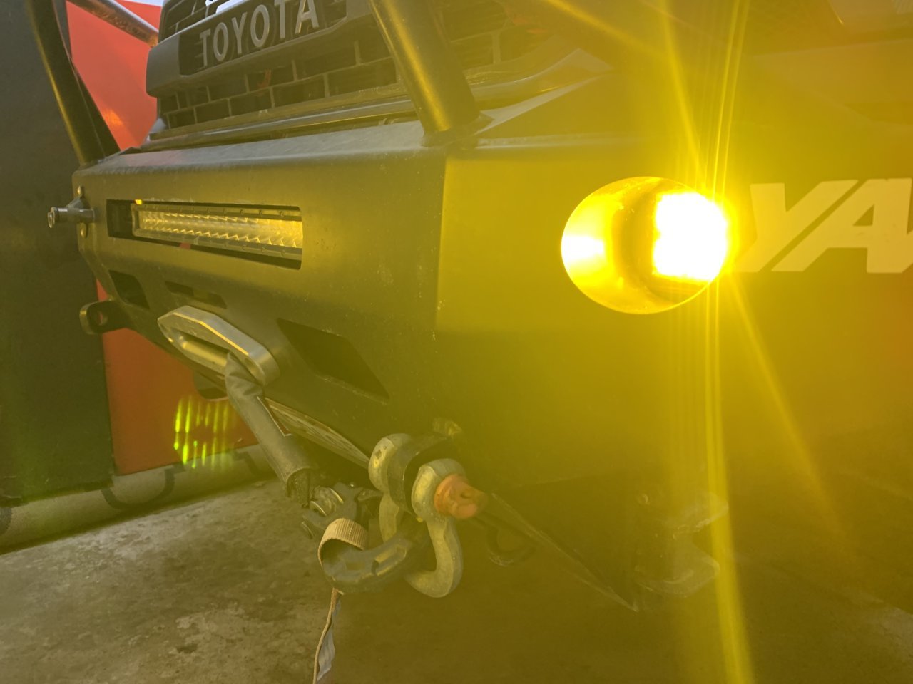

    Foglight issue fixed!! Just in time for a *predicted* 12" of snow to fall overnight. Turned out to the the foglight anytime mod that my brother and I did had a loose connection. No corrosion.
    Extended the anytime wire, spliced in the extended wire to the factory foglight harness and used some of those heatshrink/solder connectors and they work great!! Stopped at the hardware store to get some dielectric grease and splooged some of that into the Rigid connectors to be safe. All good for the storm over the next 24 hours.

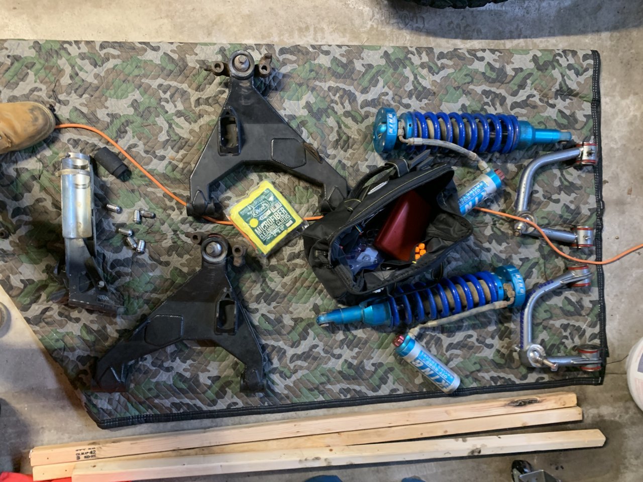

    Last weekend, I lent a buddy a hand with his suspension; went well and made me excited for mine to come:

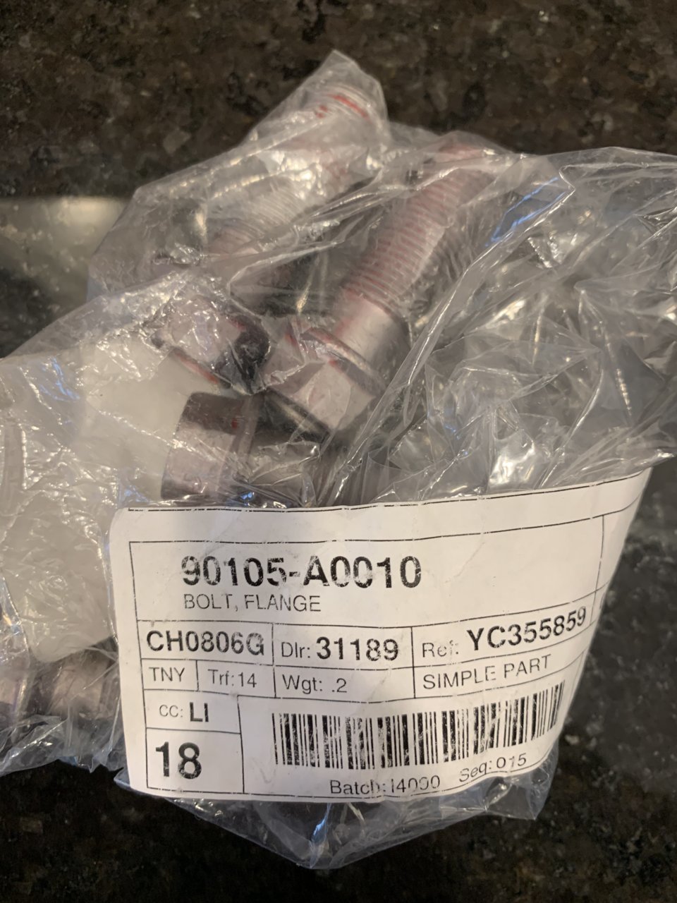

    Ordered up some hardware for the coming mods too. Got the LCA ball joint bolts -- still need to order those "attachment kits" and the new hubs.. hopefully very soon.

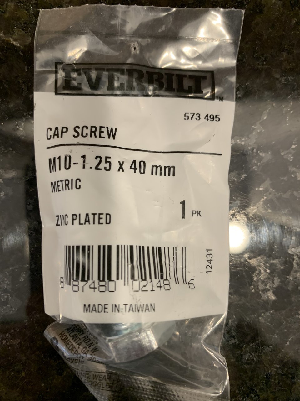

    Also, while at the hardware store today, I grabbed some bolts for the sway bar bracket mounts as well as washers, lock washers and nuts:

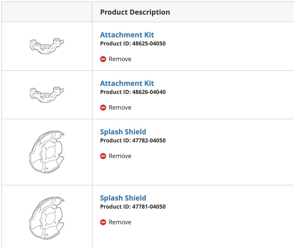

    ORDER PLACED!! :spending::spending:
    Wheel bearing/hubs will be ordered on Friday!! Going to wait for those to be delivered and then head to the 4x4 shop with the knuckles, hubs and LCA's.
    I want to get the battery purchased, but, my schedule over the coming weekends will be chaos at best. Hoping for the end of February (MAYBE) or mid-March (warmer weather).
