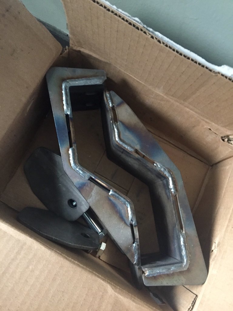

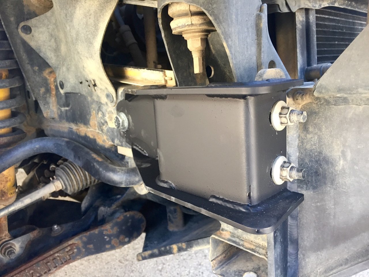

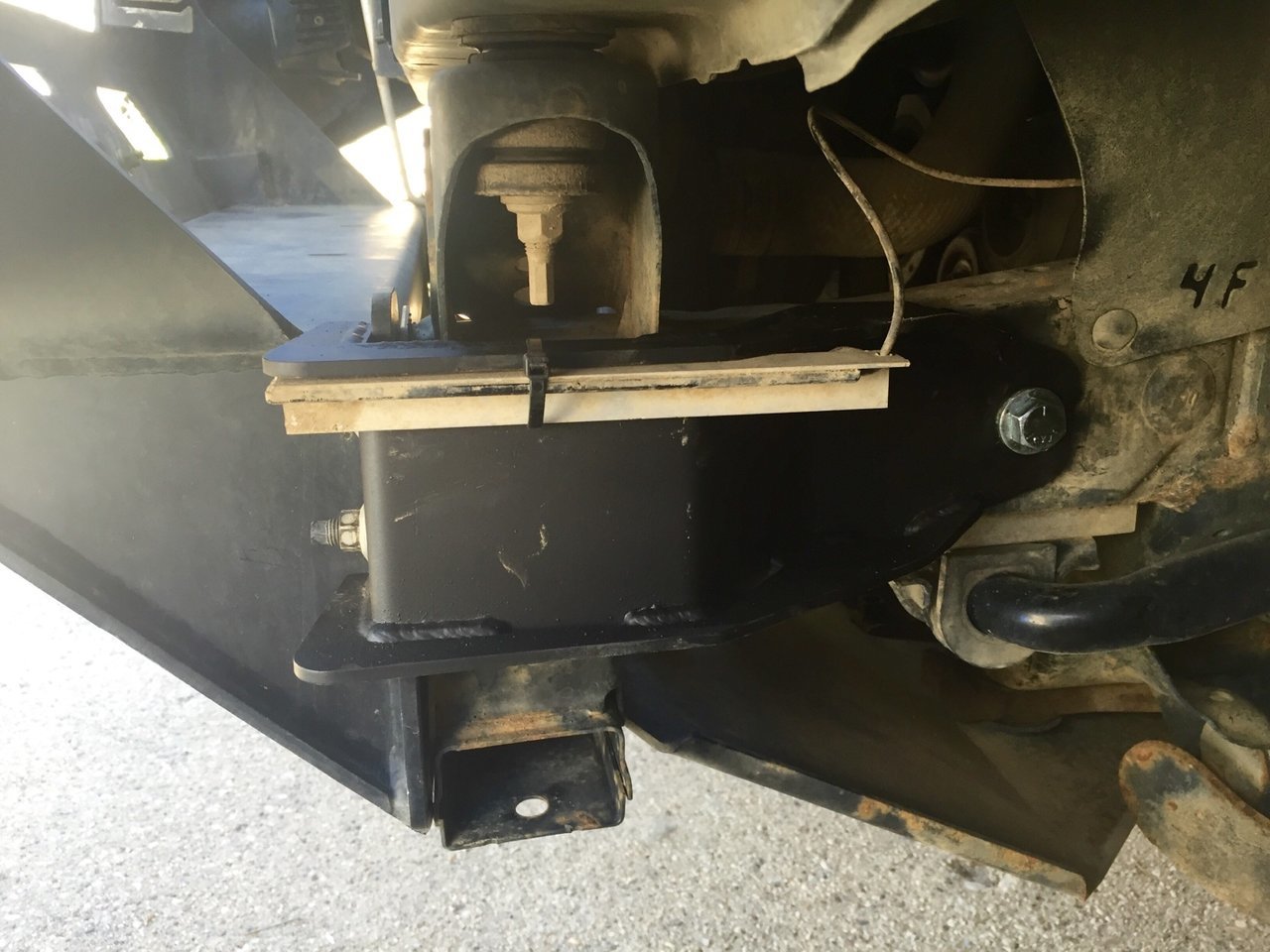

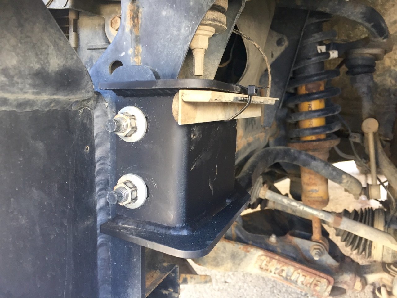

    Didn't receive my bumper support brackets in time for last weekend, so installed them today..

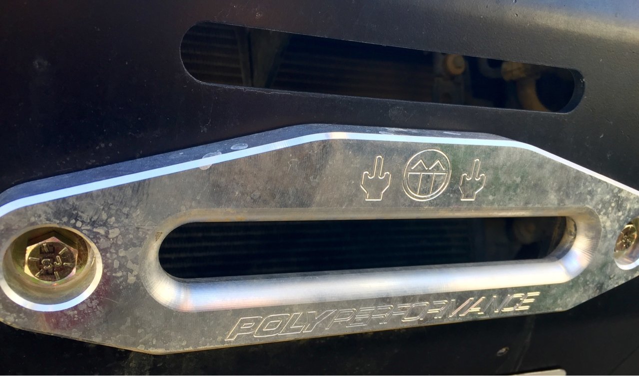

    Swapped out the fairlead hardware to grade 8:

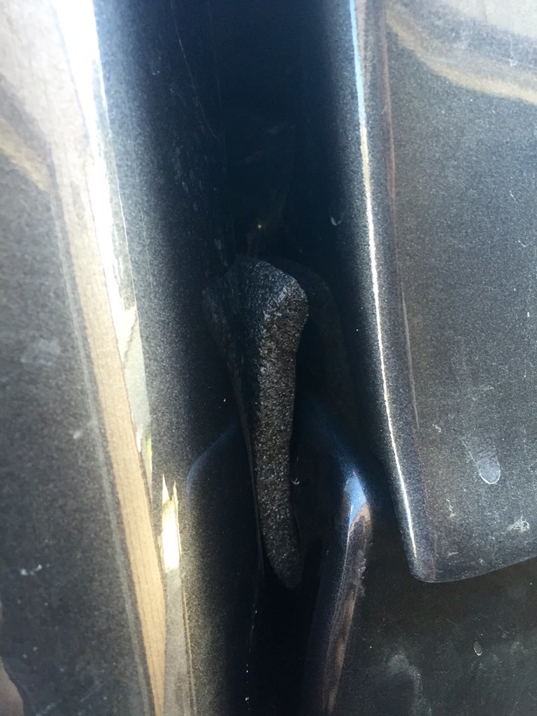

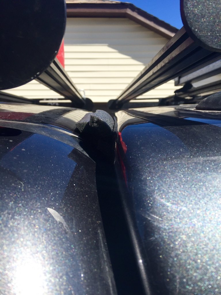

    Grabbed some pipe insulation from the hardware store and cut some strips to squeeze between the cab and cap:
    Not sure if I like it or if I need to rethink the idea..better than the cap kissing the cab :eek:

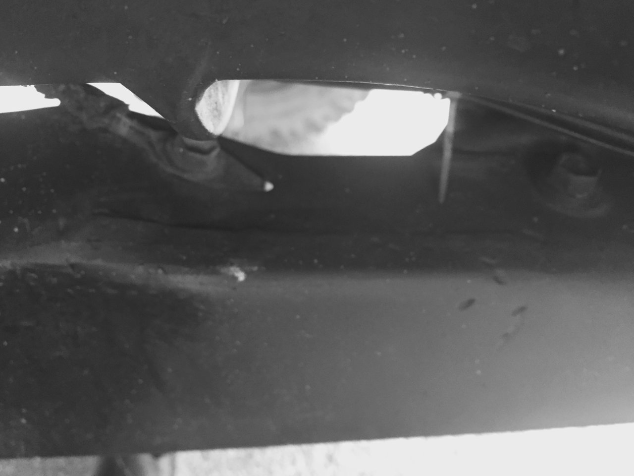

    Here's what someone did for me, so since I noticed I shall do the same for you. Had a pic taken during a mod day with my front bumper off, weeks later it was brought to my attention my radiator/frame mount bushings were shot. They zoomed in the pic and showed me
    Here was mine
    42E9ADDE-8198-43F0-A6F6-7B3027A9983F_zps_8712150e1e340086130136b0eb7d8a310e5123b4.jpg
    Well here's yours
    B81FA9DC-7B4A-445D-9C5C-C35109E53A8A_zps_ccfd0aab12bfd806d817f3db6058f2edd8b0db39.jpg
    Such a cheap easy fix. I've noticed less shake in my front bumper, but turned out to be bumper didn't have the shakes the front end body did..
    There's pics of new bushing install recently in my build. And to make it easy..
    Amazon link
    https://www.amazon.com/gp/aw/d/B000CN9BZ0/ref=yo_ii_img?ie=UTF8&psc=1
    TW write up
    https://www.tacomaworld.com/threads/polyurethane-radiator-support-mounts-cab-also.361346/
    I believe after talking to a few local guys now swapping out theirs, that the OEM bushing are shit and everyone needs to address this with upgraded bushings.

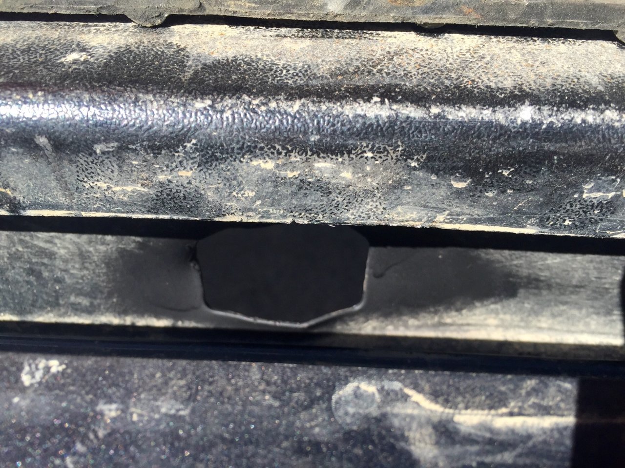

    Was filing up today and I noticed this...

    Your frame?
  19. Apr 10, 2016 at 1:54 PM
    #2119
    geekhouse23
    geekhouse23 [OP] The "Liftman" - @DrFunker
    Jul 14, 2013
    #108251
    15,696
    2GMGMDCSB4WDTRDFTMFW!! TL;DR
    mostly stock, grocery gettin' Prius
    Yes sir..
  20. Apr 10, 2016 at 2:00 PM
    #2120
    2ndGenJonny
    2ndGenJonny Well-Known Member Vendor
    Jan 3, 2013
    #94306
    18,457
    Jon
    Gilbert, AZ
    Is it not normally there?
