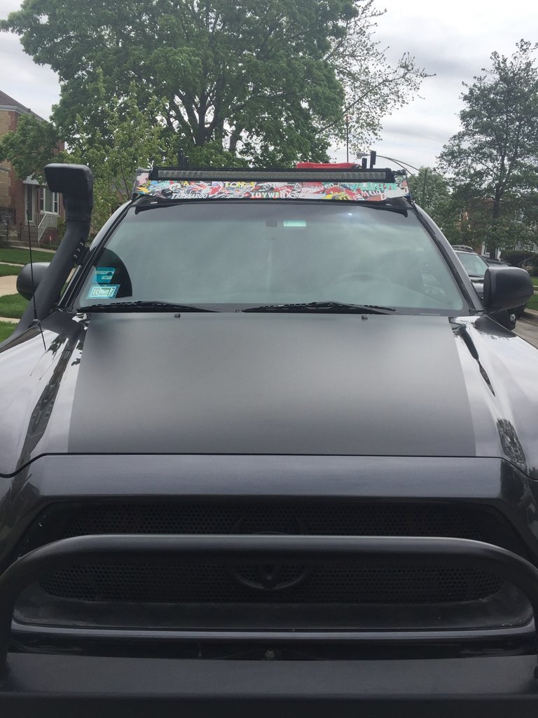

    First up was finally getting my hood vinyl installed that has been sitting in the garage forever!! Kinda pissed how it does not cover the ENTIRE raise part of the hood but still looks good nonetheless!!

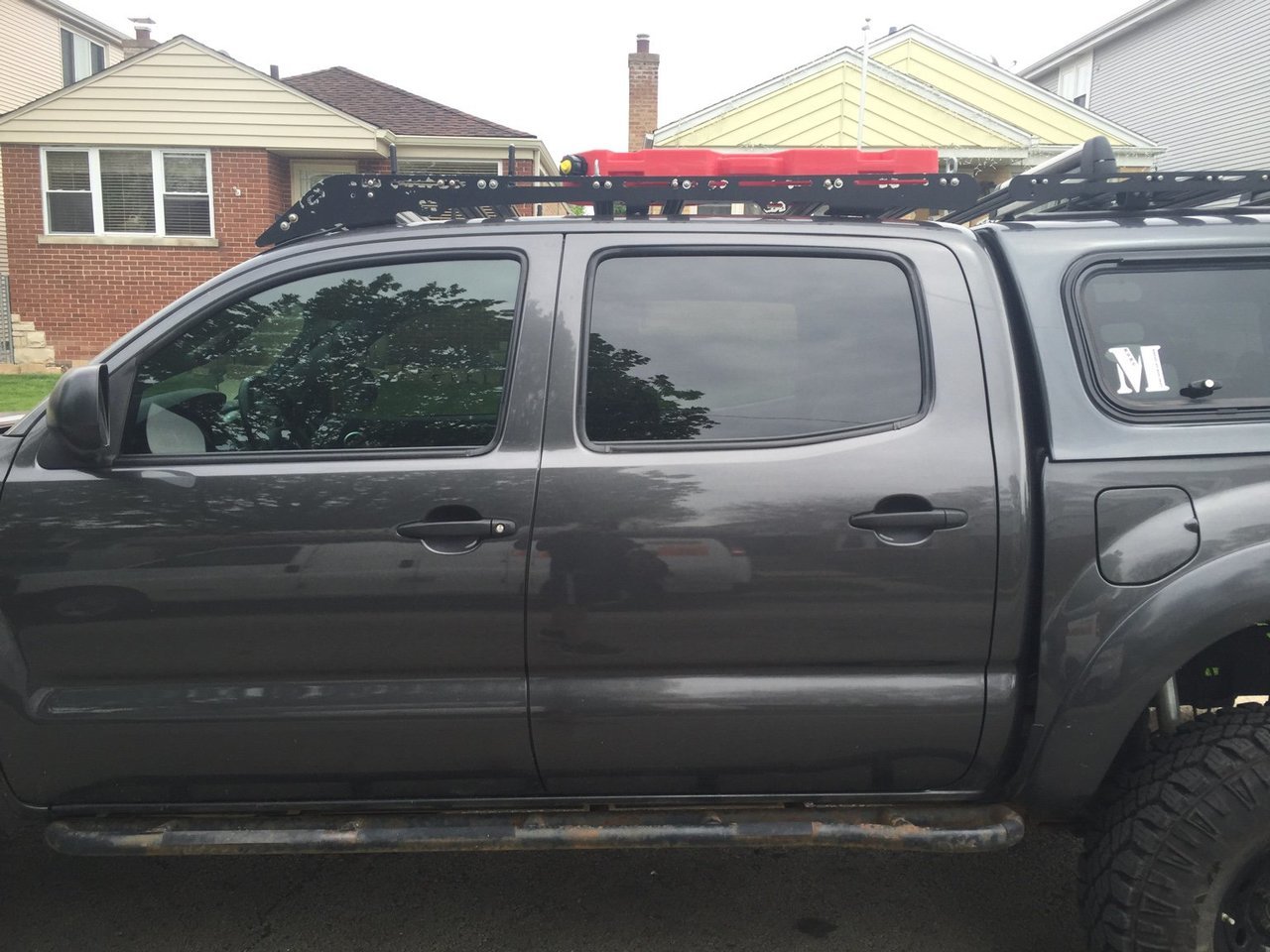

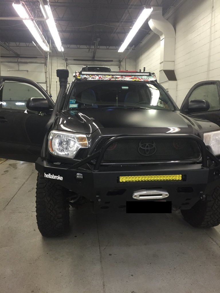

    Next was tint. I was not planning on doing this but I was there and they were having a deal. 33% is matching for the rear and legal is 55%. I went with 38% and I gotta say, it looks damn close without drawing too much attention to myself!

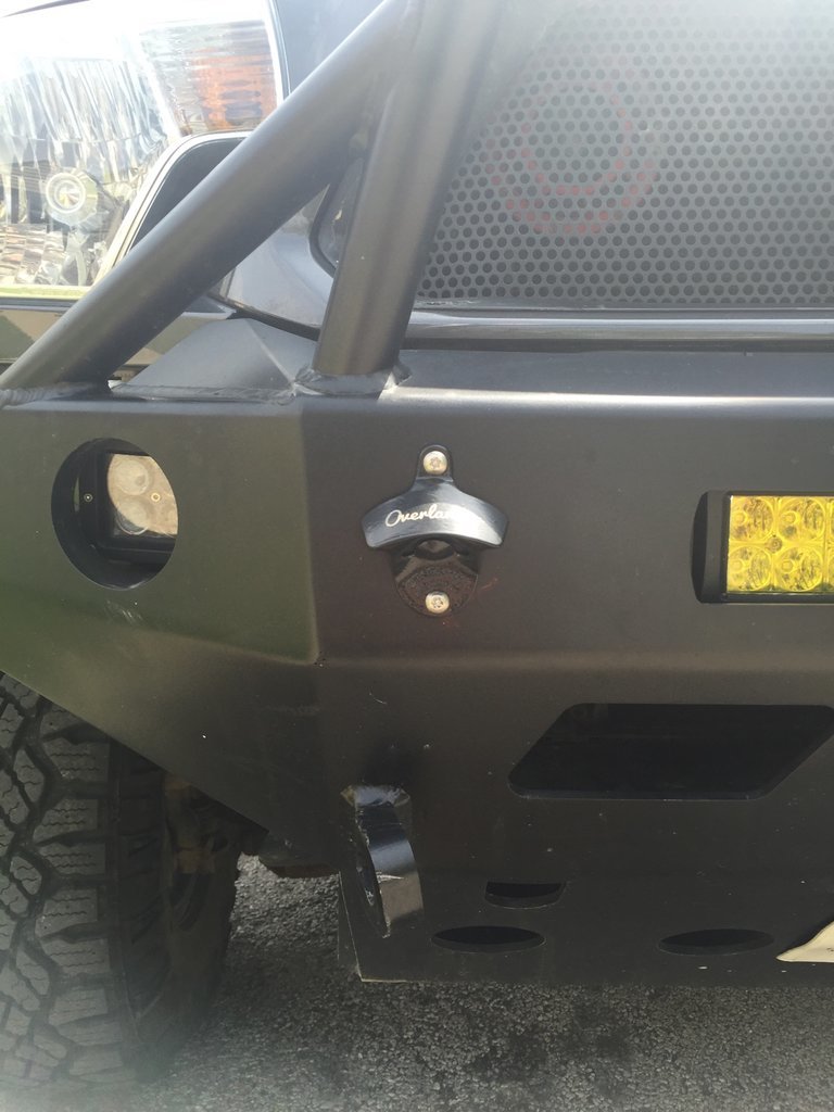

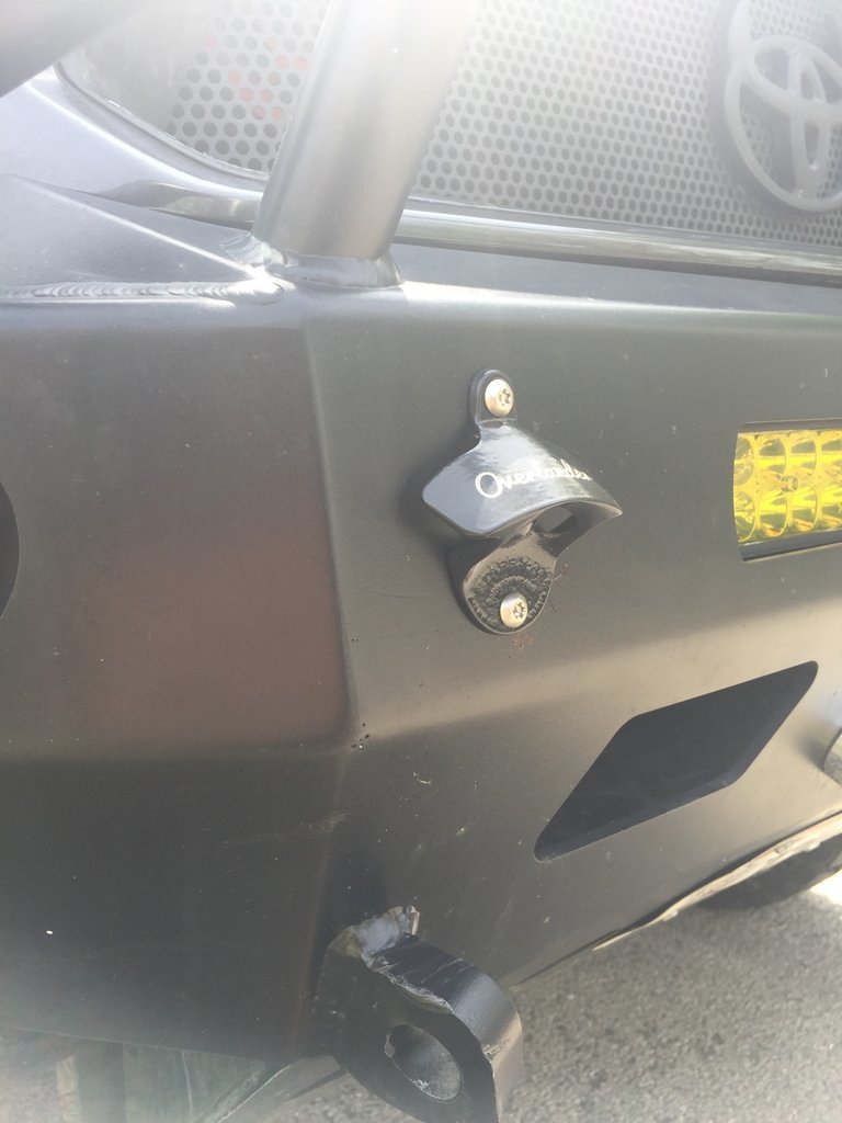

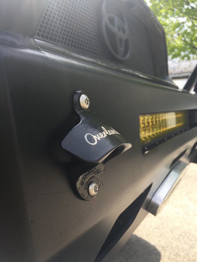

    Last up was installing the bottle opener from Papa Wolf Supply Co! Looks killer!!

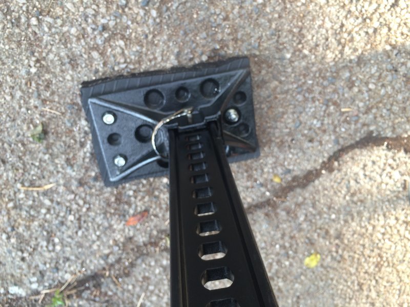

    Last up I was just out in the garage trying to work on the traction of for the hi lift Jack and damn Load E Duratracs are tough it cut through! What did you use @clynicalrider?

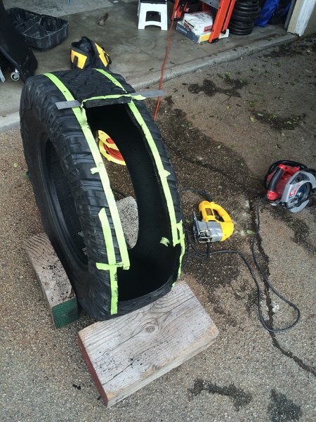

    That shit isn't easy. I started with a circular saw, but the tire smoke was too much of a PITA to work around. I moved to a jigsaw with a metal blade. Works relatively well, but forget trying to cut a straight line. You do have to put some oomph behind it. I found an up-cut blade worked best.

    Damn looks like quite an ordeal! Load E?
    Thinking that a sawzall might be the ticket...

    It actually wasn't too bad honestly. I thought you had done it already since I got the idea from your thread. I just finished cutting three pieces in about 20 min or so. (The first one was the learning experience). If you have trouble, let me know and I'll send you one. The only real issue I see is the metal wires in the tire leave the pad with sharp edges the I couldn't find an easy way to knock down a bit so is wasn't like having saw attached to my hi-lift. I ran it through my belt sander and it helped, but still gotta watch it when I dismount/mount in the bed.

    The smoke is definitely bad. Sawzall definitely works best but you need to start with something else first. I started my cuts with the angle grinder and cut off wheel till they were through the belts in the tire and then used the sawzall to continue the cuts. That method worked great. Even just using the cut off wheels to start, the tire burned through my cut off wheels fast. Once you are through the sawzall cuts like butter. @GHOST SHIP use a flap disc to smooth out the burrs from the belts. I have no sharp edges using that method.

    Thank you, I'll try the flap disc. Hadn't thought of that.

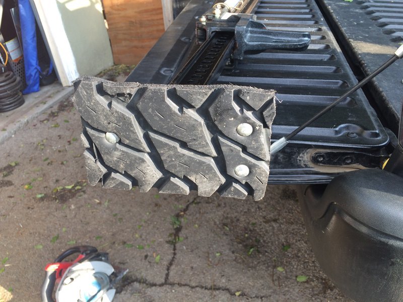

    Also, got my traction pad done thanks to @GHOST SHIP
