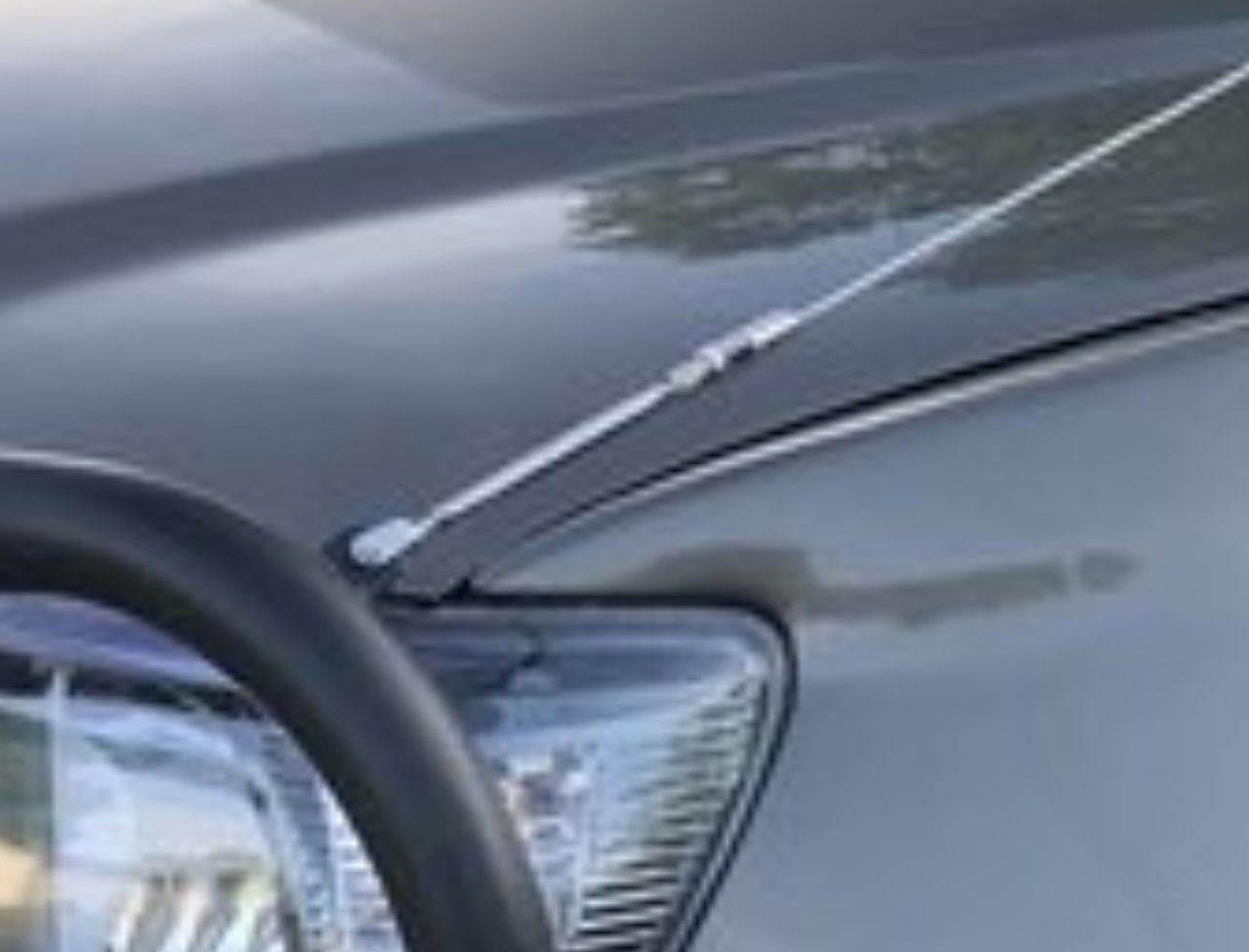

    FYI if you use the same turn buckled as GT you’ll need to cut the radius down closer to the mounting hole. Gonna look sweet with the added hoops
    geekhouse23[QUOTED][OP] and G.T. like this.
  2. Dec 3, 2017 at 5:52 PM
    #2742
    G.T.
    Jul 14, 2010
    #40169
    19,785
    G.T.
    CONUS
    Agreed, remove the jaw from one of the turnbuckles and test fit it, remember that depending on how tight you thread the turnbuckle the jaw will pivot on the tab a few degrees. If it binds the threaded section may bend/crack/break.

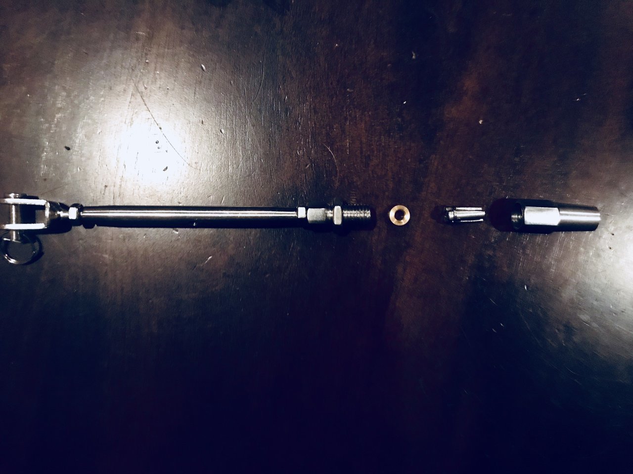

    Got the turnbuckles in so I can finish up the brackets this weekend:
    Can anyone explain how they assemble with the cable? Took one apart and I'm lost. Might be easier once I get the new cable :notsure:

    Thanks. Just seems like there's a few more pieces to the puzzle:

    It's hard to tell exactly how it works but I think Joe is on to something

    +1 thanks Joe!
    Excited to get this done and installed. My version 1's were really bulky and clunky. These are going to be really clean and EAF!
