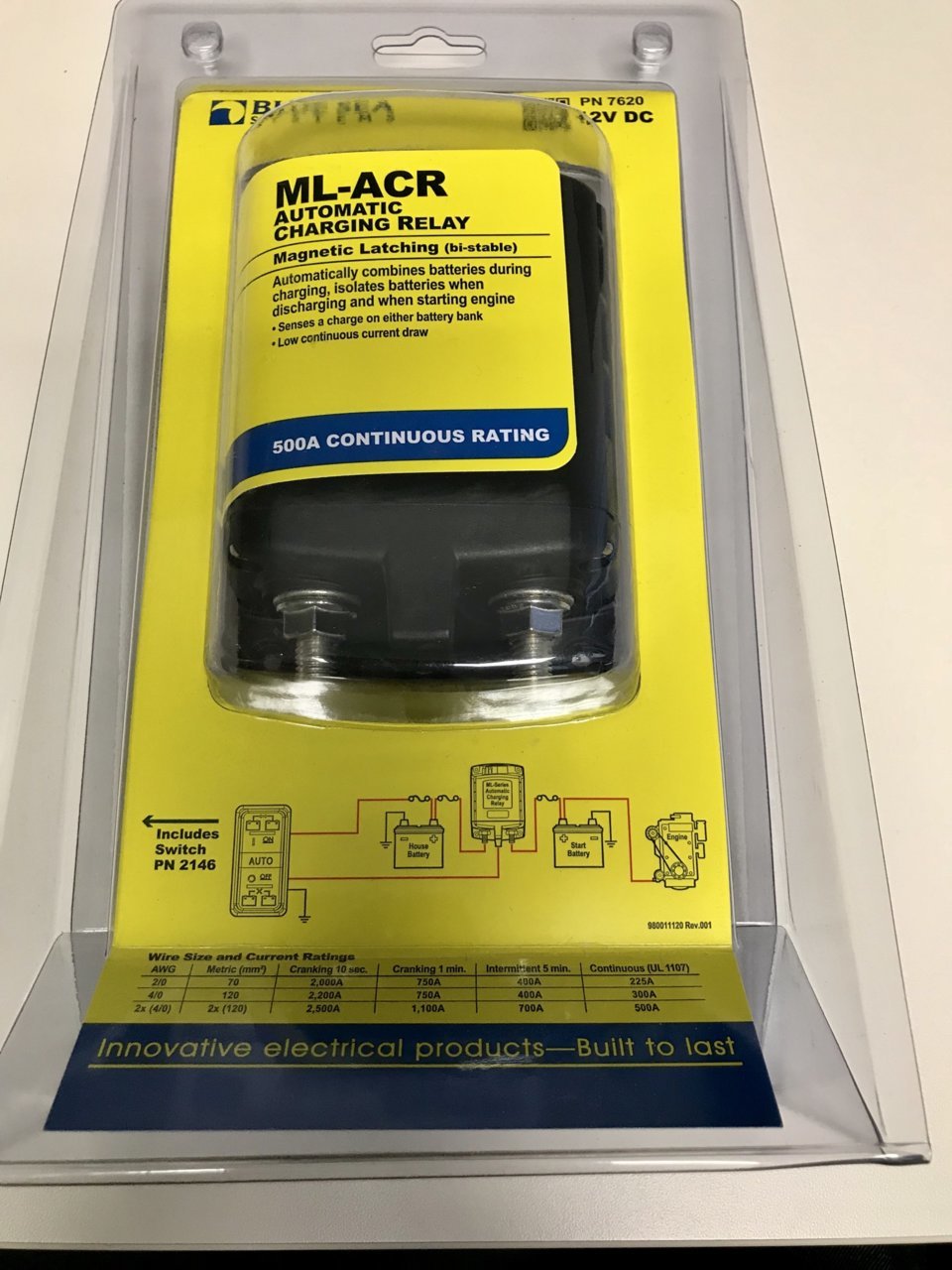

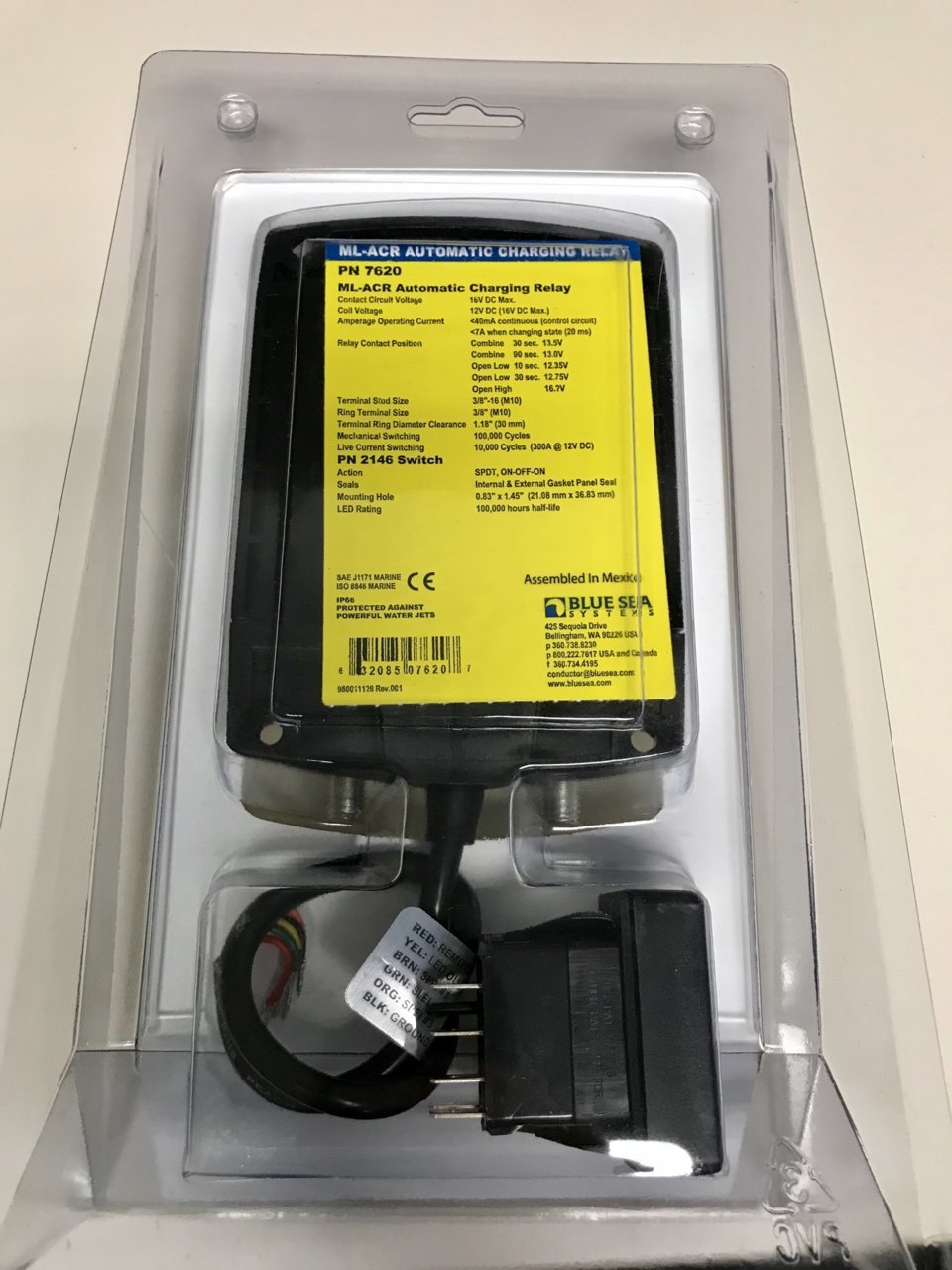

    Told the wife I bought an ACR..
    22D4B0D1-AC35-4CFB-82EC-89228F8F00F1.jpg 86633A44-9401-46F5-87BC-752D01E25A7A.jpg
    This showed up at my desk this morning. Now it's just cables and the batteries..

    Such a nice system, but it's really over priced. He must've had that lying around for a while since they're not making them as a kit anymore.
    For the cost of that kit alone with no batteries, I'll be into it for less WITH the two batteries. I'm planning on doing a full blown cost write up like I did for my DIY CO2 kit and I should be approximately $100 under what that kit costs.

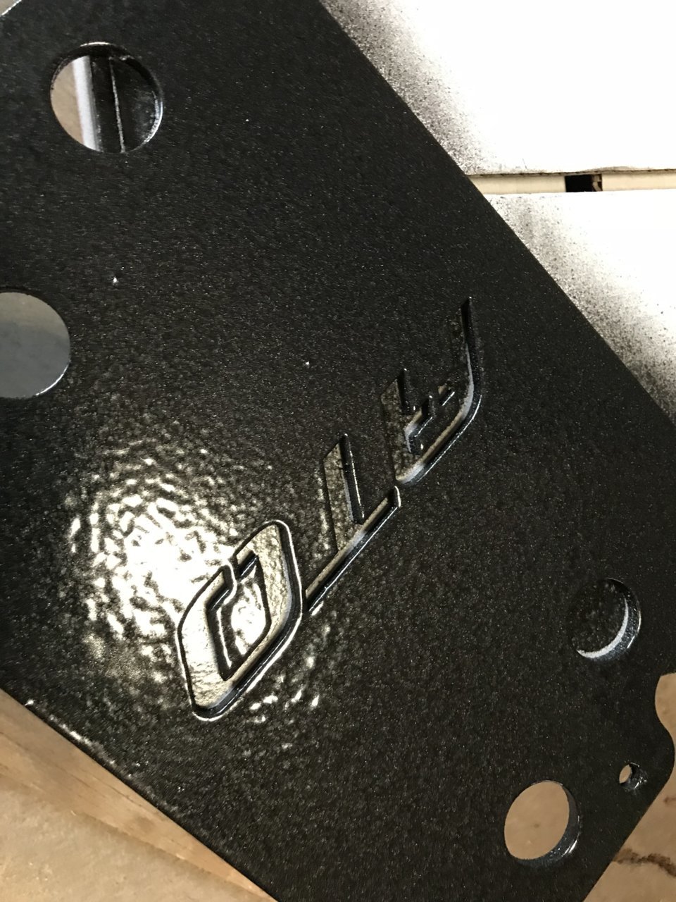

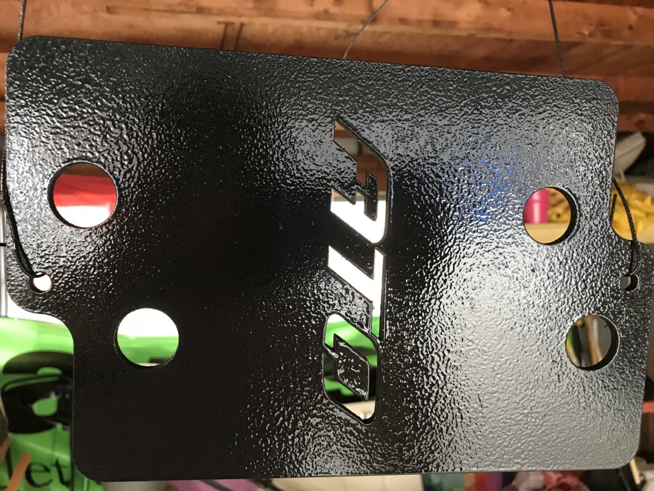

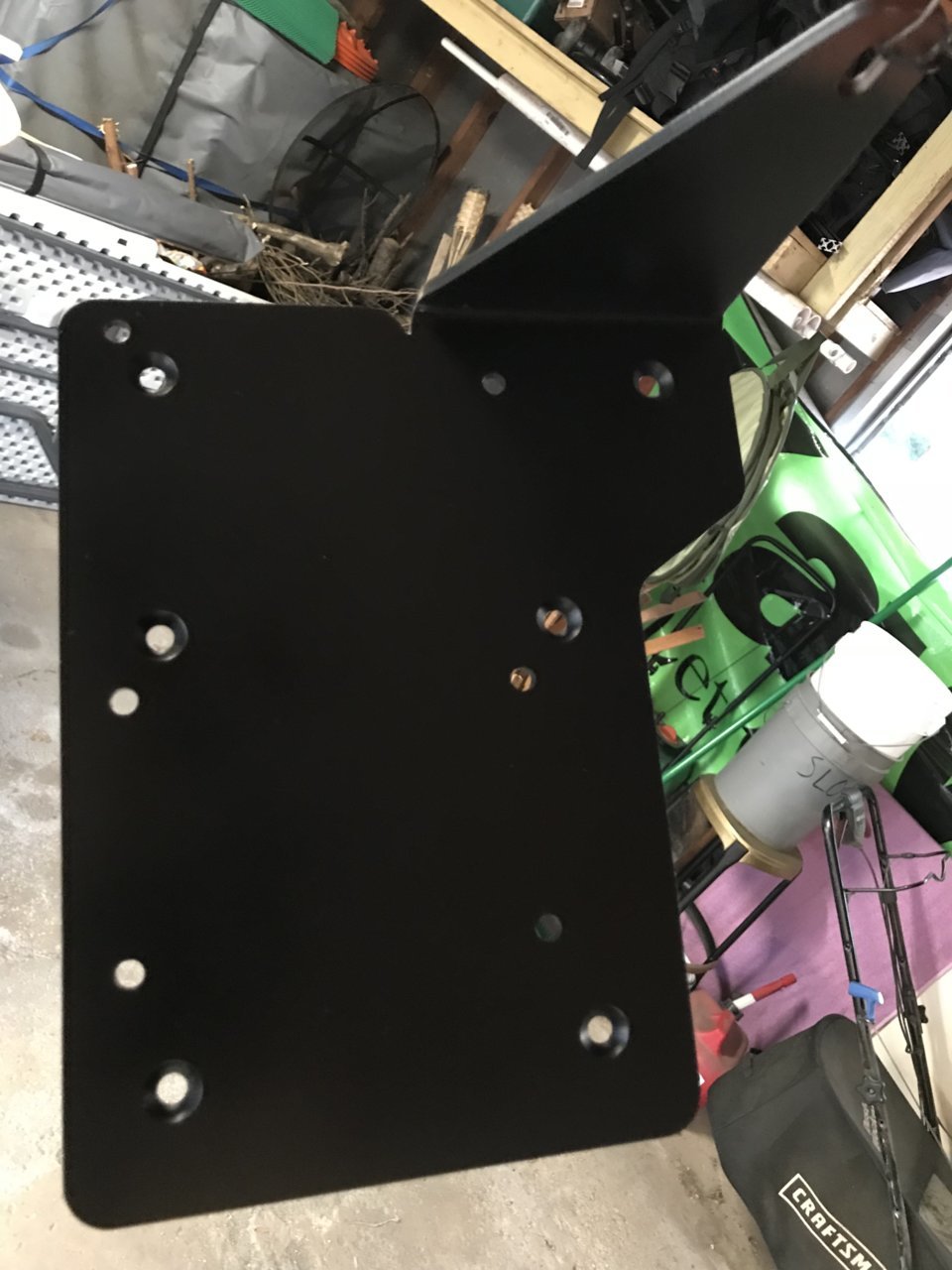

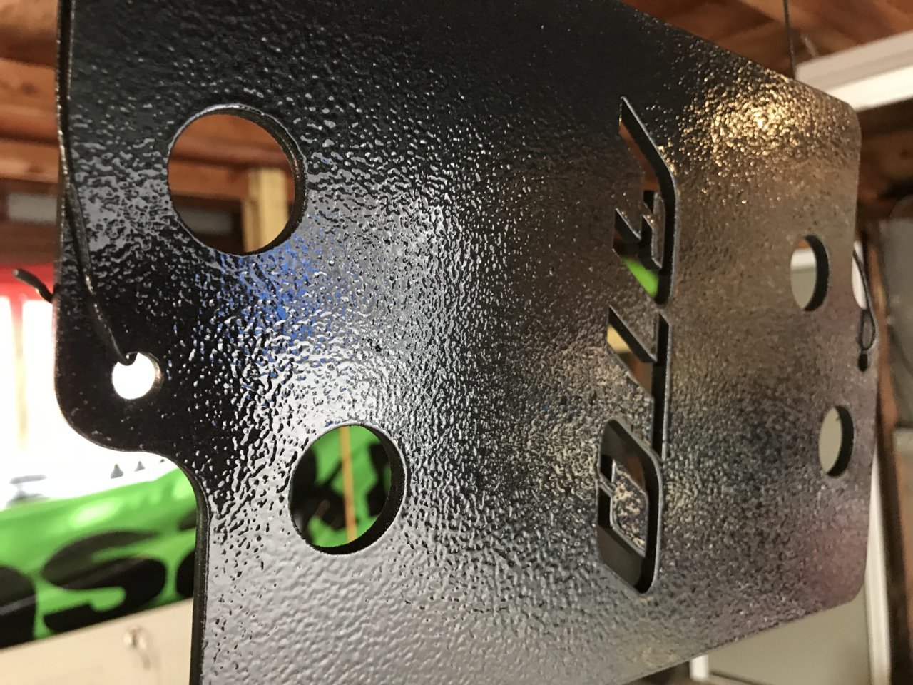

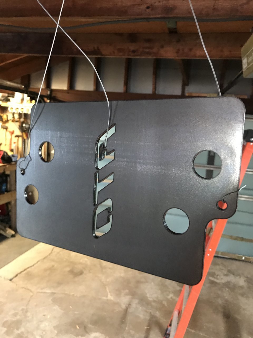

    Correct. I have the ATO kit. But I used the description from their site to purchase and piece together the same kit, just for WAY less. So far, with what I've spent, I'm at $250. Not bad if I do say so myself.
    Speaking of, I laid some paint on it last night and I should have it finished up later today:
    All the components received self etching primer and Rust-Oleum preventative rust coating followed by 3-4 coats of whatever black paint I had available. For the pieces that near the engine, I applied two thick coats of engine enamel.
    For the top of the battery tie down bracket, I used the hammered spray paint and applied 3 thick coats:
    It will be pretty warm today so everything should cure nicely in the garage. When I get home later, I will finish up painting the inside of the tray where the batteries will be seated. Ran out of time last night as I didn't want to "hot box" the garage with spray paint.
