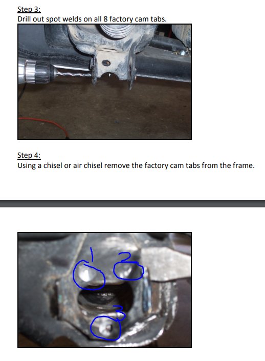

    Nobody wants to touch those cam gussets partially because it involves peeling the old ones off with an air chisel I'm sure. I'm not risking screwing up somebody else's late model frame and suspension pickup points for a few bucks. If it's my truck and it gets messed up then that's all on me, not so much when it's somebody else's in a critical area. Are you actually wheeling the thing enough to really need cam bolt gussets?

    I get it. I reached out to a few welders in the anything welders thread and they recommended to prep it myself with an angle grinder and cutoff wheels and then have a mobile welder swing by and burn them in. With how this search is going that's a good option or just buy my own machine and practice and teach myself.
    This is one of those piece of mind mods that I would rather do now and not have something happen in the middle of nowhere.

    I get it. It's a bunch of work in a shop with a lift and all of the correct tools. Throw in that somebody at home is doing this in a driveway with possibly not all of the ideal tools for the job and it becomes a serious ton of work. Drilling out 24 spot welds would SUCK to do laying on the ground in the middle of the summer. Then throw in any headache if your work is deemed unsatisfactory by the guy you did the work for.
    I don't do any fab work for anybody that isn't free or for a case of beer. The second cash changes hands, the expectations of the work changes and feelings can get hurt quickly. If it's more work than I'm willing to do for free or beer, then I just politely decline.

    Right off the instructions from Wheelers. 3 spot welds per tab

    I've helped do one set. All but one tab was easy. That one made me swear off any possibility of a second set.
    We removed em with an angle grinder.

    Nice. So would you say it's pretty simple with basic tools and nothing crazy really outside of an angle grinder and a welder?
    Out of curiosity, how hard was that one tab? Take a lot of work?
    I've done the frame rivets on the rear of the truck for the shackle flip brackets and that SUCKED. This can't possibly be THAT bad?

    The one tab was the result of being awkward for a right hander that a left handed person would have had little trouble. I removed em and my buddy (truck owner) welded new ones on. 20 years ago it would have been easy. Being old makes simple shit difficult some times...

    That's what I figured. Would a spot weld drill bit help too? I don't see why not?
    The job seems simple enough minus me not being a welder and not knowing how to give a vehicle an alignment (shop/machine/tools). Angle grinder and sawzall make quick work of A LOT of things. Best tools in my arsenal, so far, IMHO.

    Oh and I found someone that did the cam tab gussets recently and they said it only took about 3 hours:
    https://www.tacomaworld.com/threads...d-long-bed-sport.437064/page-37#post-17917361
    Not bad. I completely understand that nothing goes to plan and the instructions advising that the work takes 5-7 or 6-8 hours or whatever is said is for those "unexpected things."
    Still, 3 hours is not bad. I just think the shops overestimate the work to squeeze you for every dime.
