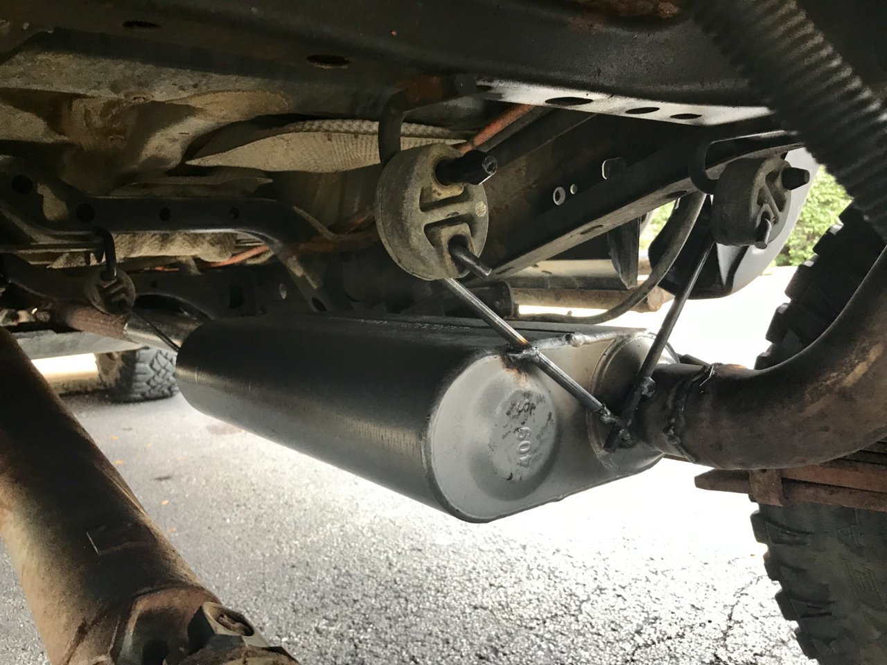

    No worries, thanks for doing that! Are you still liking it? I definitely like the sound of it. As far as installation goes, was it the same input and output diameter and location as the stock muffler? Or did you have to re-route the stock piping to fit it in? Thanks again!
  9. Oct 13, 2018 at 7:17 PM
    #3689
    geekhouse23
    geekhouse23 [OP] The "Liftman" - @DrFunker
    Jul 14, 2013
    #108251
    15,716
    2GMGMDCSB4WDTRDFTMFW!! TL;DR
    mostly stock, grocery gettin' Prius
    Definitely still liking it a lot!
    It's a 2.25" diameter pipe which is what the stock piping is also. Same mounting location as the stock muffler too. Here is a pic and the model and inlet/outlet information is below that.
    Flowmaster 842452 50 series Delta flow 2.25" center inlet/2.25" offset outlet.
    Hope that helps!!

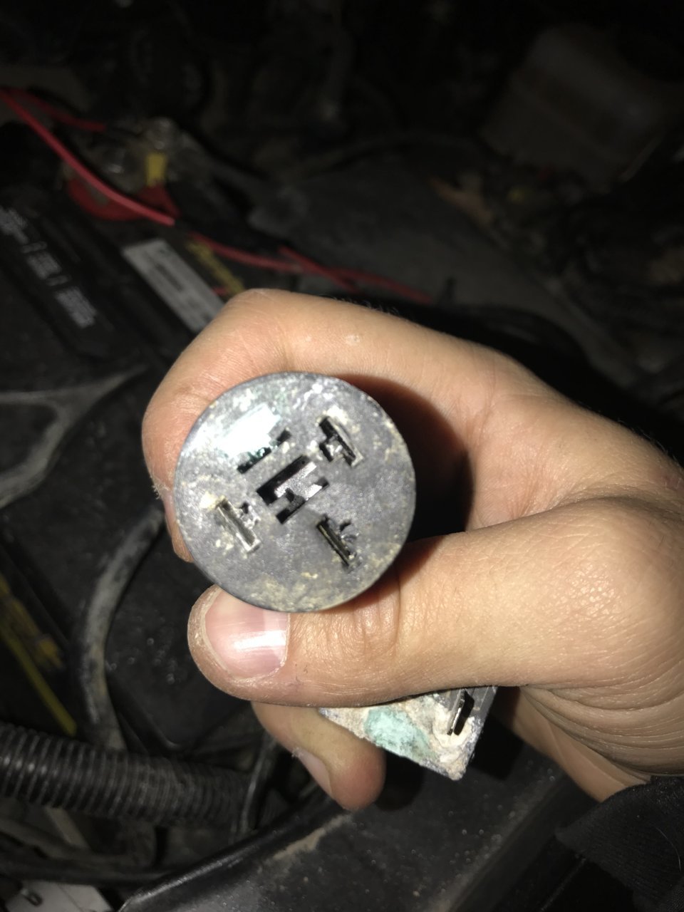

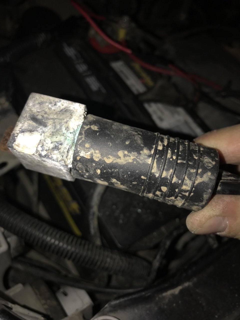

    Good thing I started my checklist a little early.
    Fixed a leaking remote air chuck on the rear bumper. Took longer than I hoped, but it's fixed and working.
    Aired up all my tires another 5 psi all around and went for a test drive. Such an easy thing to over look. Rides much better now.
    Unfortunately, looks like I have some wiring to fix next weekend before the wheeling trip in two weeks. Much like the fog light a few weeks back, I have some corrosion. I checked the fuses and they are not the issue.
    - 40" Heretic
    - rear roof rack Sasquatch lights
    - winch
    Just to name a few. Funny thing is that other items on that same, lower IGGY panel work such as the inverter. IT ALWAYS SOMETHING!

    Guess who just spent $40 for UPS 2 day shipping?
    :spending::spending::spending:
    This guy.
    Got home from work and took a look at the the 40" roof rack bar. Rewired the positive connection as it looked to be faulty and cleaned and relocated the ground directly to the battery (for testing) and nothing worked. Traced the wiring back from the battery to the bar and found this:
    Went to the garage and grabbed a new, spare relay to test and no dice. The bar still won't turn on.
    My guess is that, much like the fog lights from a few weeks back, the corrosion got so bad and caused bad connections.
    I hope that's it. Plan is to work on this issue and install a roof rack on a buddy's Tacoma Saturday.
    :fingerscrossed:

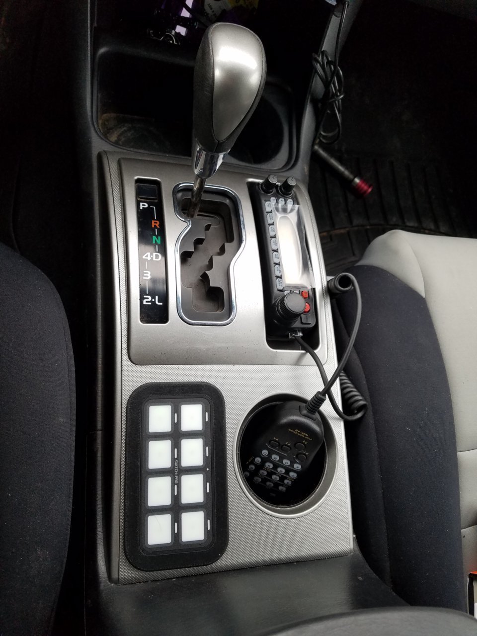

    Switchpro :anonymous: because fuck relays...and paychecks

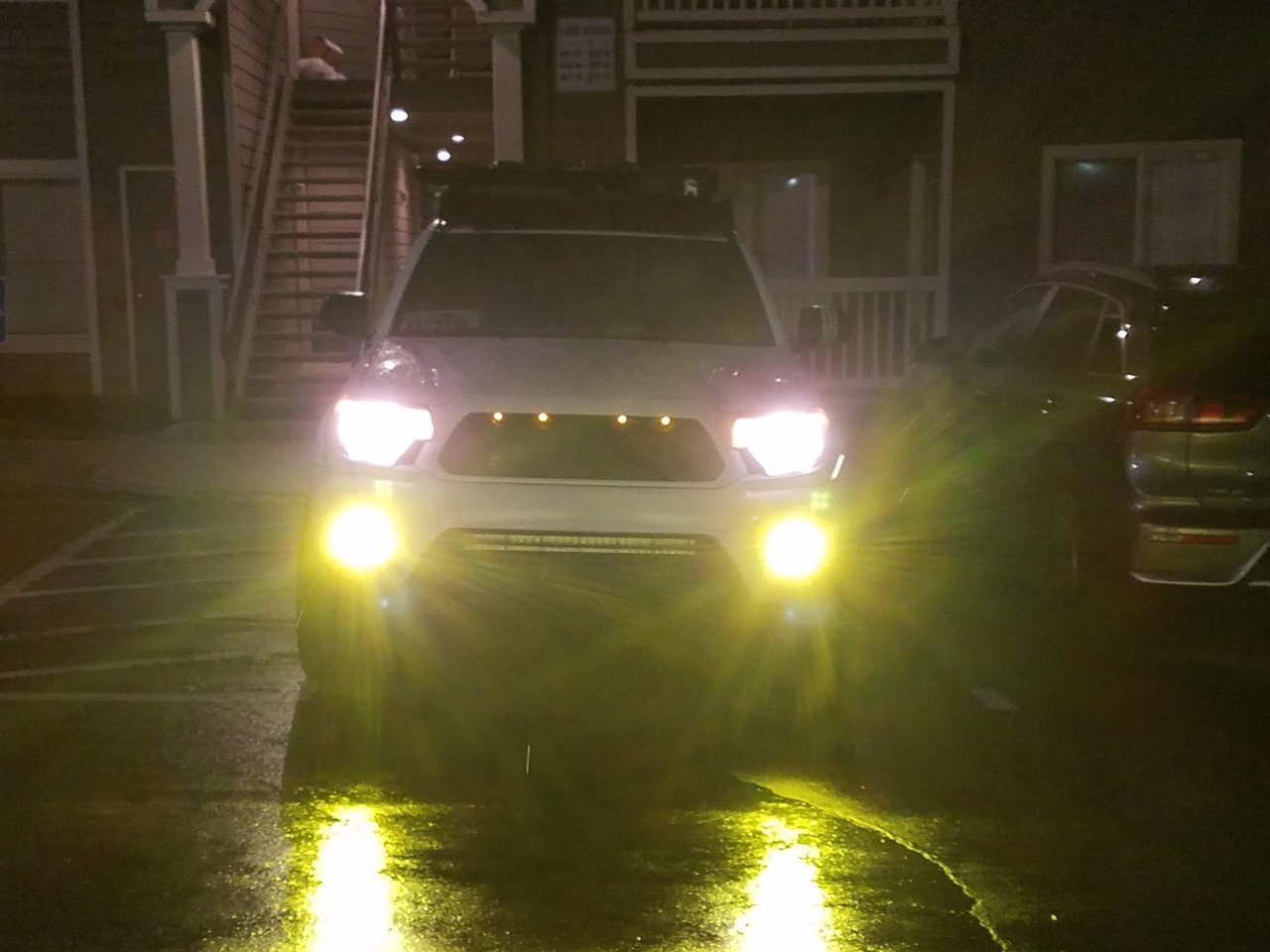

    @geekhouse23 I put in BD Sports in the fog pockets (the older, less bright ones) and unless it is a foggy winter day, I never run them on the street, def not at night. I can only imagine how bright the new ones are. I'd go wide cornering regardless.
    I also added a pair of Pros as a replacement for a lightbar I had to remove to mount a winch, and the mix of the sports and pros make a perfect combo. Except now I'm thinking of Pros in the fogs because ALL THE LUMENS!
    WC Sports:
    WC Sports, Combo Pros (Spooktober edition):

    Might be saving some pennies for switch pros when I go dual batteries eventually. Going to need to sell more patches :playball:

    A lot of truth to this. Only light that comes to mind is the bigger ONX6 lights from BD which has an amp draw in the low 20s I think. I mainly got one because it allowed me to clean up the rat's nest of relays from the days before I knew better, as well as making adding new lights a 10 minute affair wiring wise. I also was fortunate enough to snag one of the last XPOTRPR mounts, so it makes it look nice and clean in the cab, which is a huge deal for me. (yes, the mic is now mounted on a clamp).
