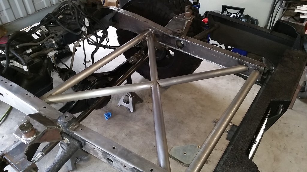

    I think I will be going the 'X' route for the frame bracing; I just need more/better measurements to get an idea of how much tubing I will need. Ideally, I would like to go with something like this pending funds, but, for now I can use this as a guide for the measurements:

    You definitely want an X in the fabbed crossmember. Do a straight bar back near the bumper and one just behind the axle and an X in between as in the picture in your other post. Just 2 straight bars are going to flex like a MFer.
    If you're looking for a source for frame box plates, DMZ has a setup that retains the factory rear crossmember, so you don't need to fab up anything. http://dmzfab.com/product/2005-tacoma-frame-boxing-kit/ You might also want to check if @dirt designs or @DTFtacoma offer anything and maybe pick their brains about what DOM size you should use for the crossmember.
    Strongest shape in an arc.
    Boxing is done. About the only thing done right by the shop that I had do the work. :angrygirl:

    Thanks!! DMZ is nice, but expensive. I figured that removing the stock crossmember and adding the tubing would be better and stronger in the long run.
    The DMZ kit should come with an option to pass on the gussets. Unfortunately I asked them if they would sell me the kit without them, but they won't. Hence why I'm going around trying to piece together a kit.

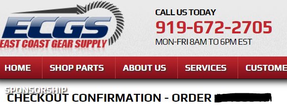

    Clamshell bushing and axle seal - https://eastcoastgearsupply.com/i-8536125-toyota-8-clamshell-bushing-eliminates-needle-bearing.html
    $89.99 shipped to my desk.. :jerkoff::jerkoff:
