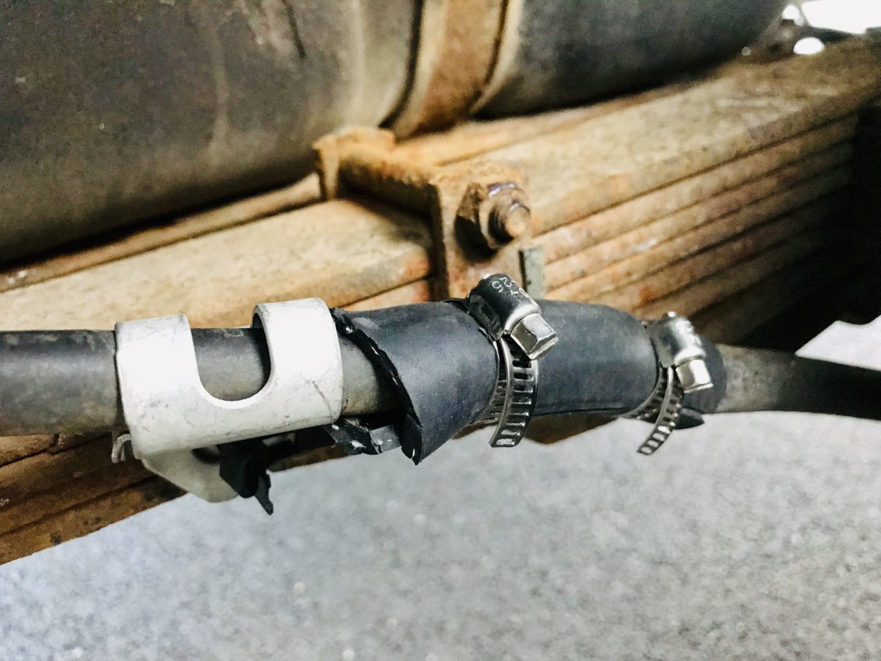

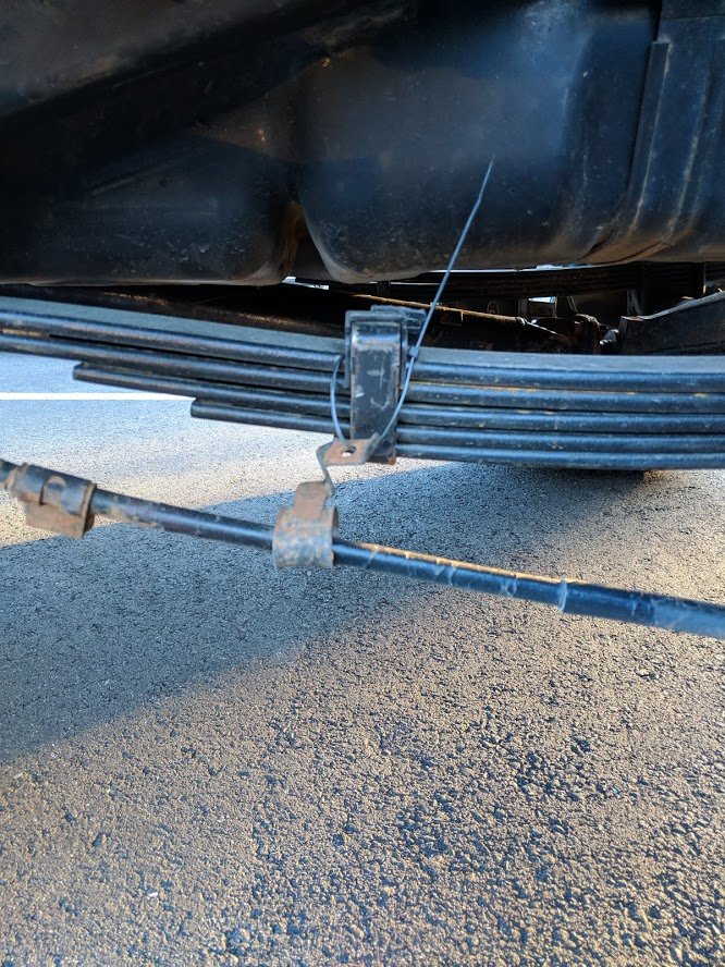

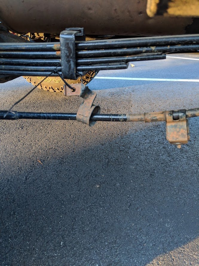

    Got the "@boogie3478 e-brake temp fix" done yesterday. The OEM clamps I ordered were supposedly delivered at work Friday morning but somehow didn't make it to my desk in time. Once I get those, I'll also add them along with some zipties as a double fix measure until I can get a more permanent solution. With how much I'm going to be using the rig in the coming weeks for the move and towing etc, this was definitely a priority to get done.

    3" lift? A.R.E cap 285/70/17 moto metal 955 17x9
    Turn the slit in the hose down so any liquid that gets in can drip out.

    Good call.
    Brackets came in today anyway, so since I was in there, I turned them down and pulled them away using the brackets and HD zip ties from work. Came out well I think. Going to drive around a bit and make adjustments as needed.
