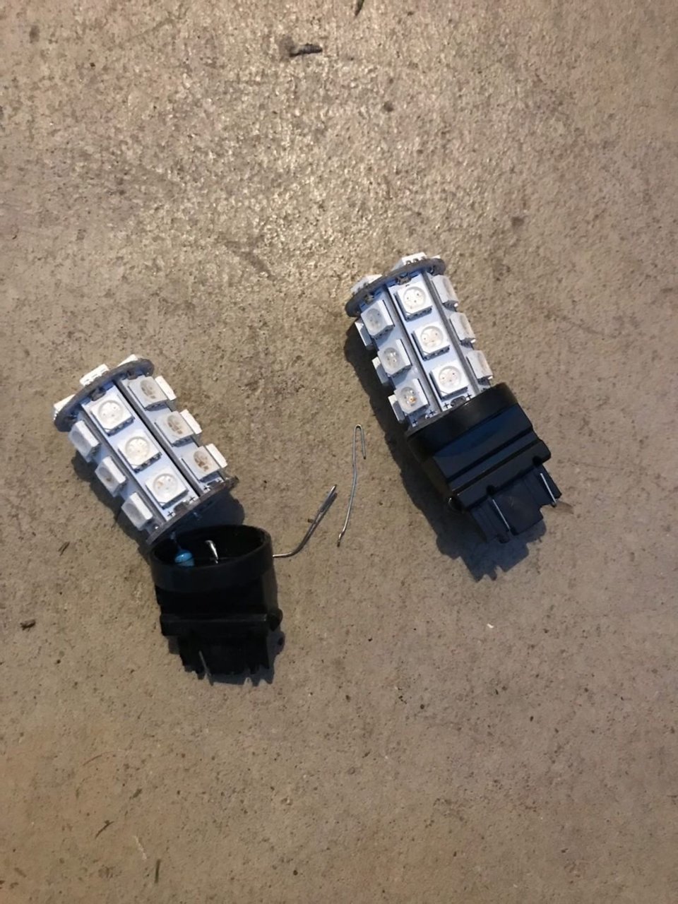

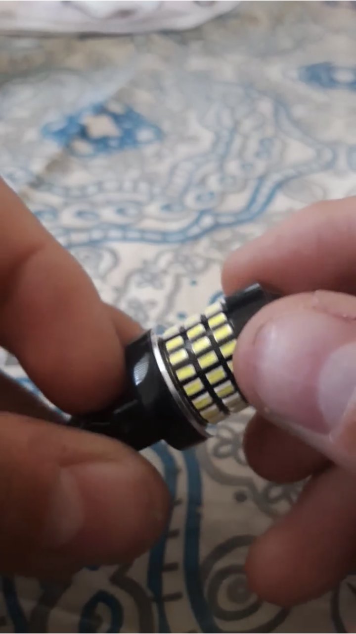

    Tried swapping in some LED DRLs tonight and boy what a clusterfuck! First off they were cheap as fuck:
    Plugged the first one in and it BARELY fit in the harness. Tested. NOTHING worked. No DRLs, no dash lights, no corner lights and no fogs!!! Plugged the stock bulbs in again. Same results. Came inside to eat, regroup and research.
    Found out that the TAIL 10A under the dash near the hood release controls everything I mentioned above that was not working. Sure enough, it was blown. Threw a new 10A in and everything was working again. From the photo, you can see that the fogs failed upon the final time removing the bulb from the harness (tested and retested everything SEVERAL times). I'm just glad everything is fixed and working as it should.
    I've already reached out to the lighting manufacturer. I got dicked on mine since they drop shipped them to me and they didn't come directly from the seller. The ones shown below are only white (not switchbacks) and the ones I got are Amber only. Trying to find out if he can send me some QUALITY Amber LEDs since that's what I paid for and thought I bought.
    PISSED.

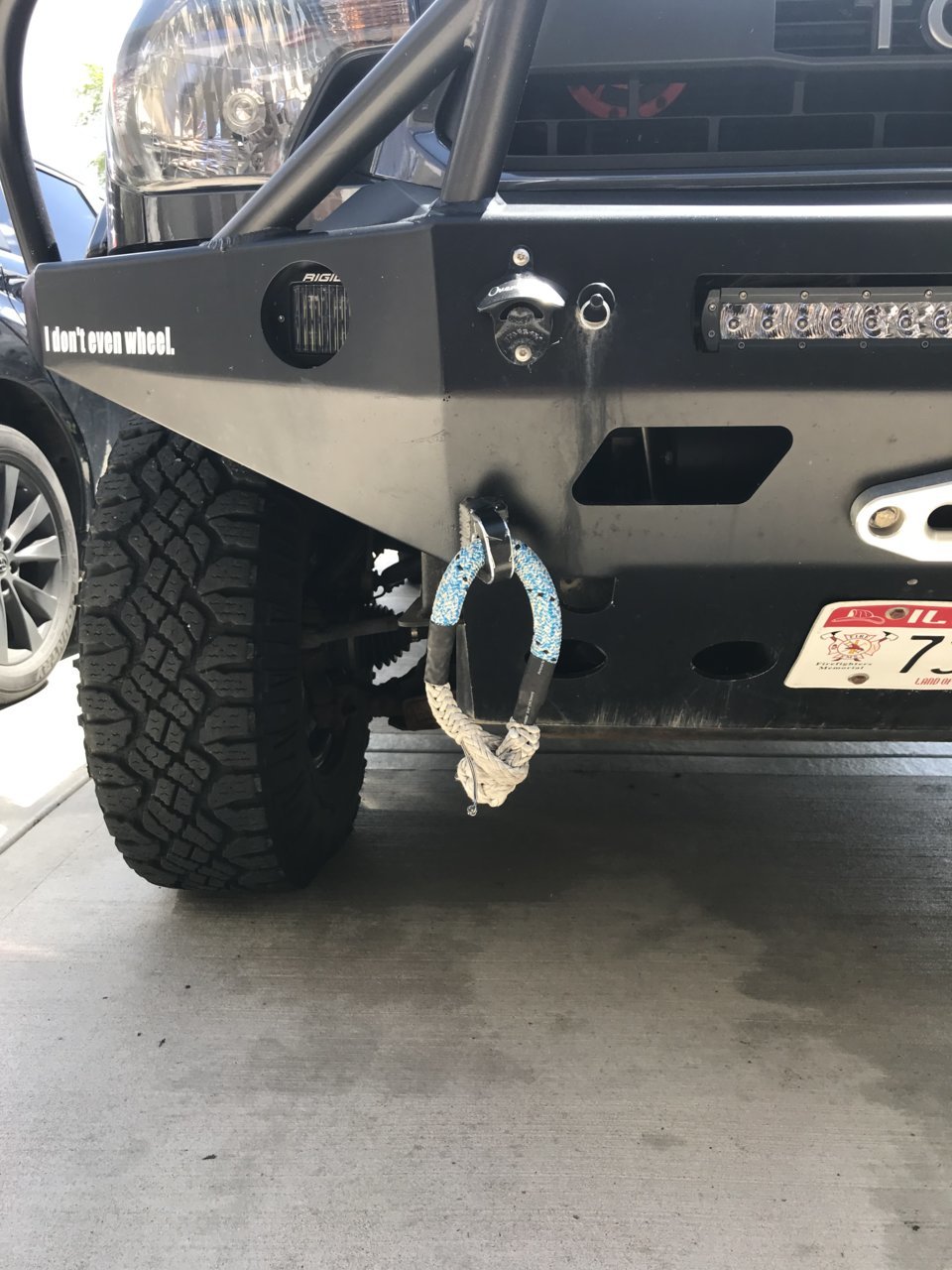

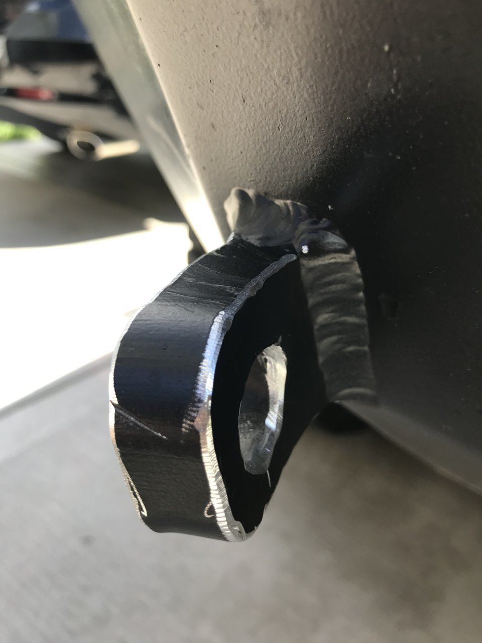

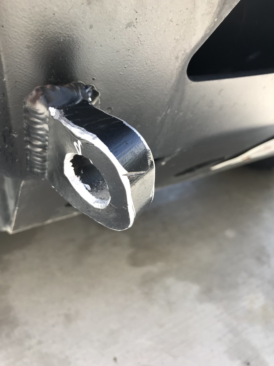

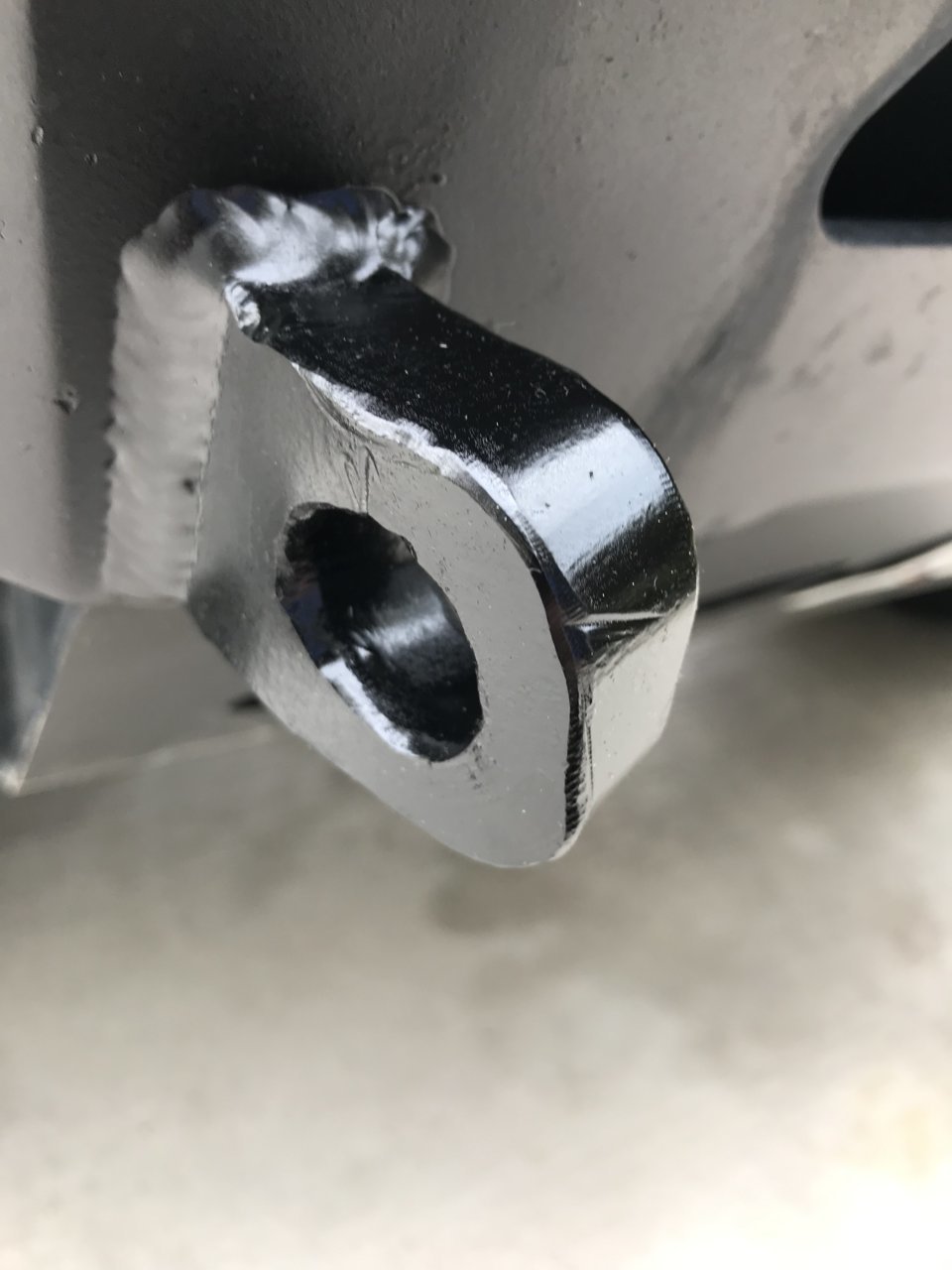

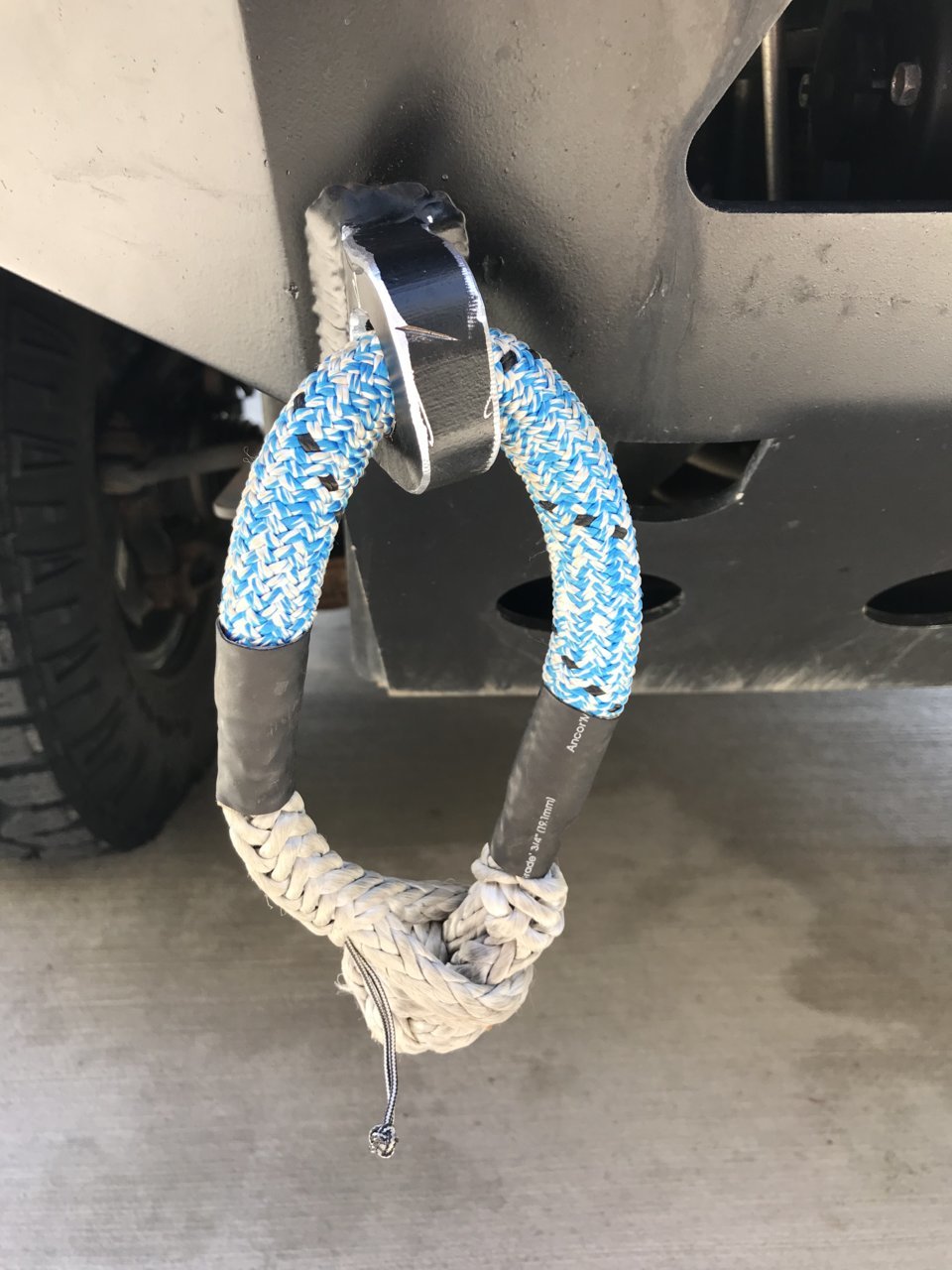

    Next, I worked on the passenger recovery point. Because Chandler massaged some Prius at 40mph, the recovery point no longer accepts a regular d-shackle. I have 2 soft shackles, but with the sharp edges, I needed to round them down so the soft shackle wouldn't fray and fail. Thanks to the link for the Dremel bits from @EatSleepTacos I finally got that done.
    Dremel bits here: YXGOOD 10 Pieces Tungsten Carbide Double Cut Rotary Burr Set with 3 mm (1/8 Inch) Shank and 6 mm (1/4 Inch) Head Size https://www.amazon.com/dp/B01MXURLTG/ref=cm_sw_r_cp_api_i_1zG4CbC4DVS9M
    A little paint because #MallRated
    *DISCLAIMER* Be sure to wear a full face shield and long sleeves. Metal shards fly EVERYWHERE. Especially on a day as windy as today.

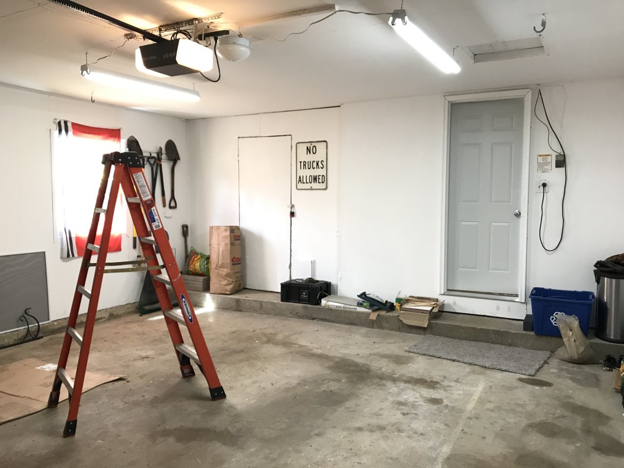

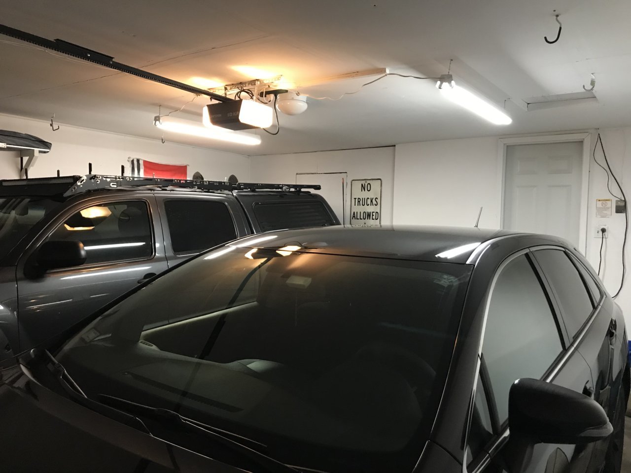

    Lastly, I hung my shop lights. Definitely happy with the lighting in the garage now and I still have one more to hang. I'm thinking on the truck side over the hood if I find myself working on something while the door is closed. Recommendations welcome!
    Test shots were during the day, but I just went out to the garage and can confirm, the light output now is GREAT! Really happy with them!!
