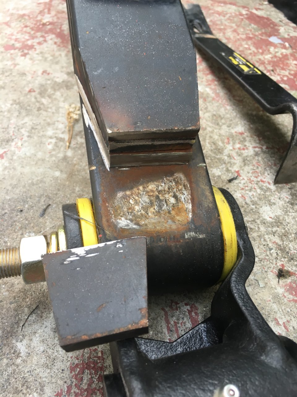

    BAMF hangar install coming in the next few weeks (POTENTIALLY June 8th or 9th)
    Been hanging around the TW thread for the mod (glad I did) and learned a few things:
    - The Dakars rub on the shackles as noted below:
    - second, crossbracing. While I enjoy Jerry's kit, I wanted to beef up the rear (alongside the frame plating and bracing) with a cross brace for the hangers like the Archive kit. Knowing full well that Jerry is planning on "eventually" making a cross brace kit, however, I hope to install the shortly afterwards; need to install and then mock everything up for the welder. I purchased the plates from a TW member here (not sure he wants a shoutout, but not hard to find :wink: ) and they shipped today. I also ordered some more 1.75 OD x .120 wall A513 HREW Round Steel Tube in a 3' section (after confirmation from the aforementioned TW member) for the cross brace.
