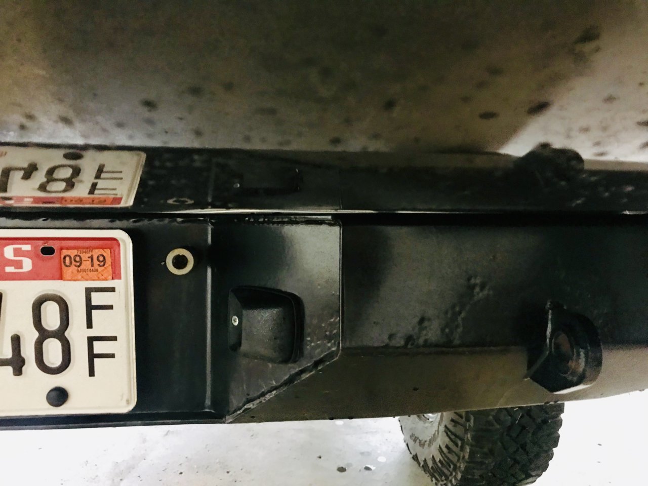

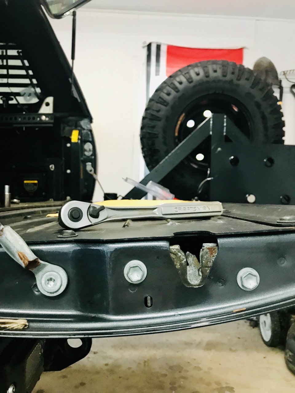

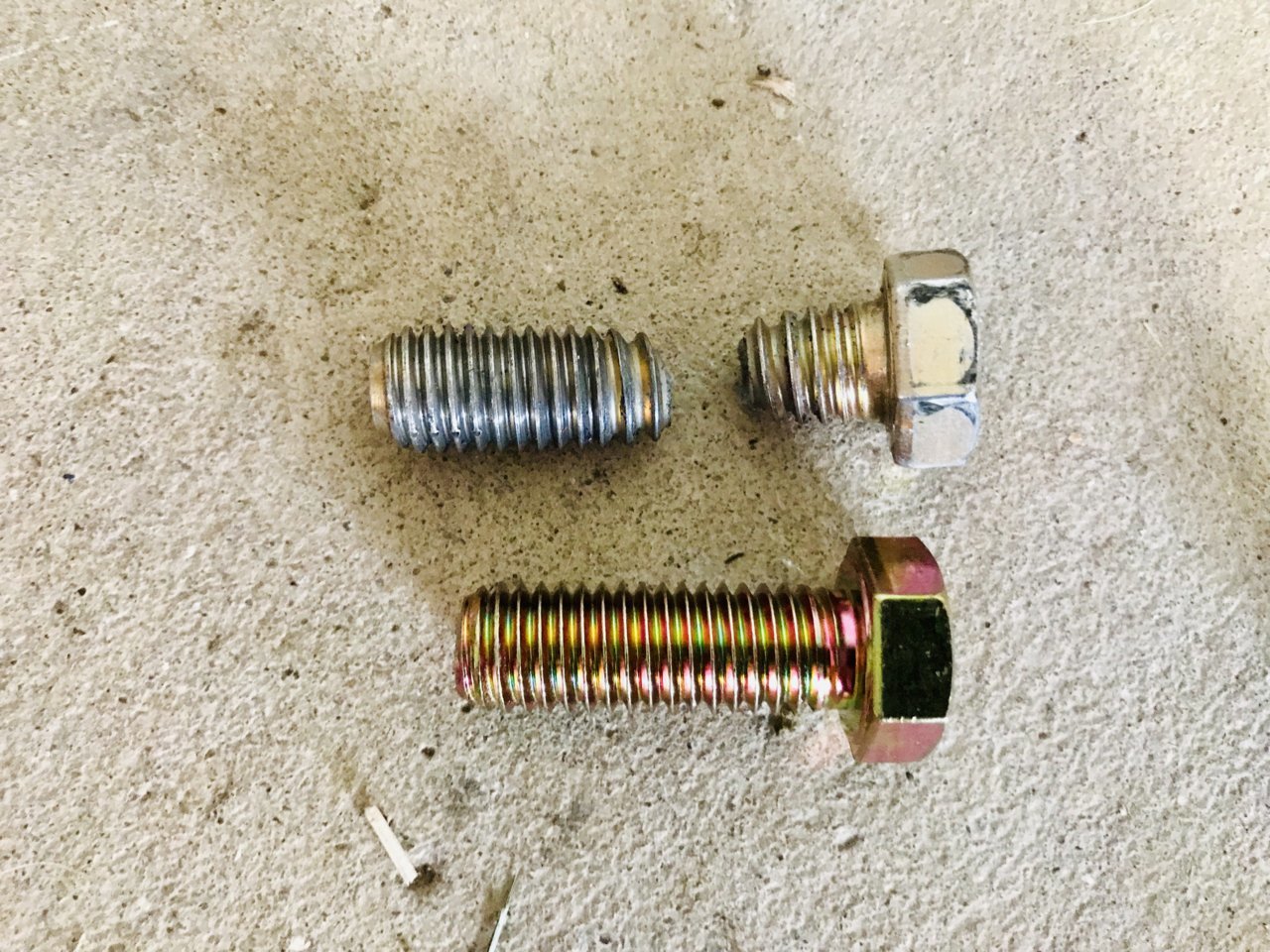

    - get replacement grade 8 bolt to replaced the one from BAMF that snapped in half; this Milwaukee impact is BEEF :muscleflexing:

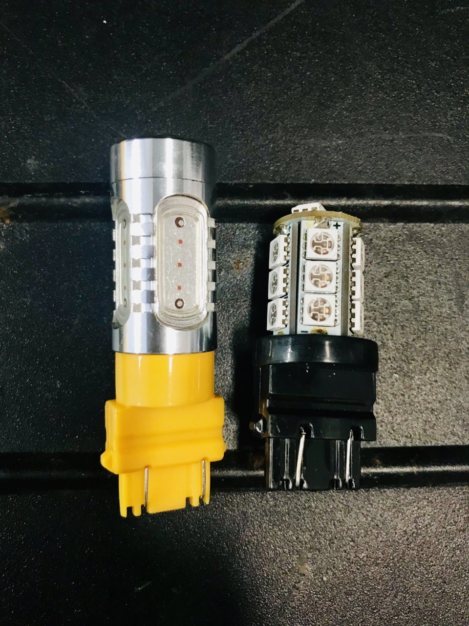

    - Install rear Diode Dynamics rear turn signals

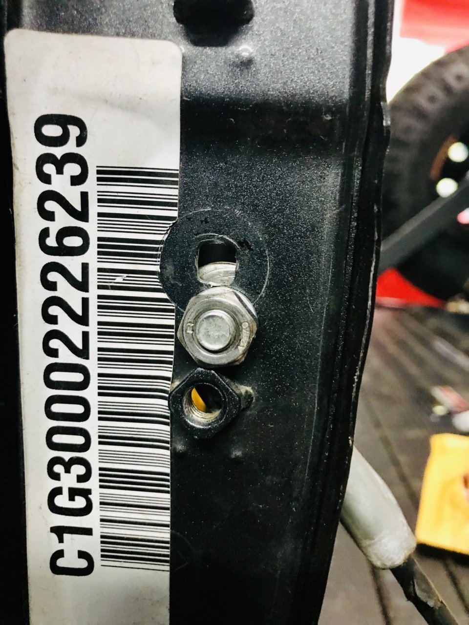

    - finish DIY tailgate cable mod
    - SPINDLES!!!!!!
    - retorque BAMF hanger bolts and test flex
    - re-attempt replacement bumper hinge pin removal and swap for a good one; old one is seized
    Was able to get the above in red completed today:
    Replacement grade 8 bolt and torqued everything again. Everything is tight and right:
    Rear Diode Dynamics turn signals are in and they are BRIGHT! No hyperflash either!
    Tailgate mod COMPLETE. Tailgate is much more level now although that could be because of the shackle flip.. everything is lower in the rear now..

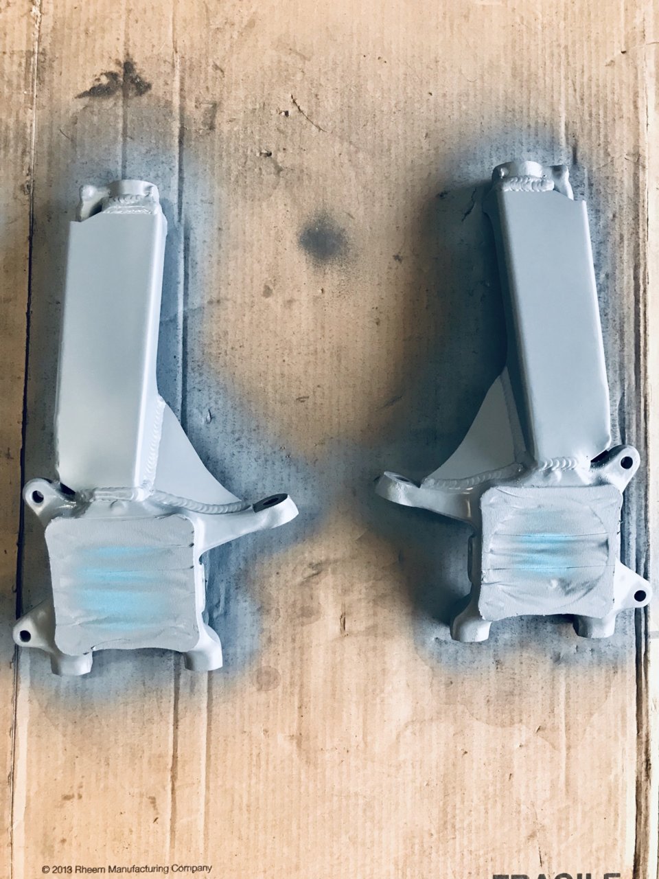

    Got the spindles cleared up, brakleened and laid down 4 coats of primer:
    I'll let them cure for a few days and then start the enamel coats.
    Here is a side by side comparison of the SOS shackle flip with stock length ATO shackles versus the BAMF hangers and ATO shackles:
    It's amazing to see how these changes make all the difference. It no longer rides like a dumptruck in the rear and everything feels more planted while driving; especially on expressway on ramps.
    Still need to flex her out but I look forward to running these BAMF hangers for a long time.
