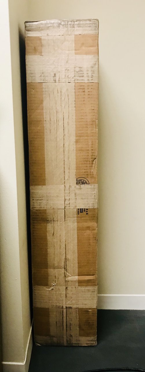

  17. Jun 28, 2019 at 7:55 AM
    #4457
    geekhouse23
    geekhouse23 [OP] The "Liftman" - @DrFunker
    Jul 14, 2013
    #108251
    15,716
    2GMGMDCSB4WDTRDFTMFW!! TL;DR
    mostly stock, grocery gettin' Prius
    First of, hopefully, a few deliveries today:
    Had some of these made up.
    I have one for free if your name is @jberry813
    Gunshot-6A and jberry813 like this.
