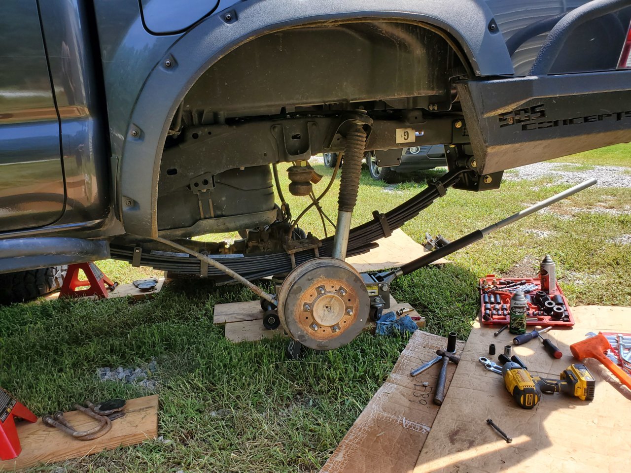

    Did half of it. Had a few hiccups....u bolts too short. Center pins too short...missing 2 nuts in the hardware pack. Luckily my garage is a taco graveyard and I had extras:thumbsup::rofl:
    I'm gonna finish the rest later. Its 100 degrees and I'm beat.20190822_124636.jpg

    Double wrap to the front and they are passenger and driver's side specific.
    :thumbsup:
    :yawn:
    Looks good man. I need to measure my Dakars and Deavers to make sure the ubolts will fit. I am glad I didn't cut them after installing them.

    I think the ones in the deaver kit would have worked if I didnt put 4 degree shims in. I had driveline vibes before the shackle flip and didnt want to go through that again. Same thing with center pins would have worked without the shims. Looks like I'm going to have to get back at it sooner than I wanted. Rains coming:rain::sadviolin:

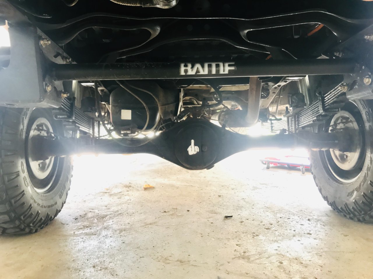

    Done! @TaKoToy @JHEAL77

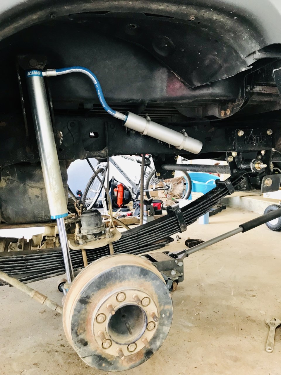

    Took a lot longer than I hoped for, a trip to the hardware store and I should probably get a new ubolt flip kit and center pins, but it's done.
    - Deaver U402 S3's
    - BAMF shackles
    - put the old CB drop kit in
    I gained about 3/4" back in the rear too. All grade 8 hardware used and anti-seize on all the threads. The rear suspension is finally "done". Only thing really left is frame plates for the rear and a new frame crossmember.
    On to the front finally! (Need to order)
    I hope my TW dad is proud @jberry813
    :cheers:
    4WDTrout, Gunshot-6A, JHEAL77 and 2 others like this.
