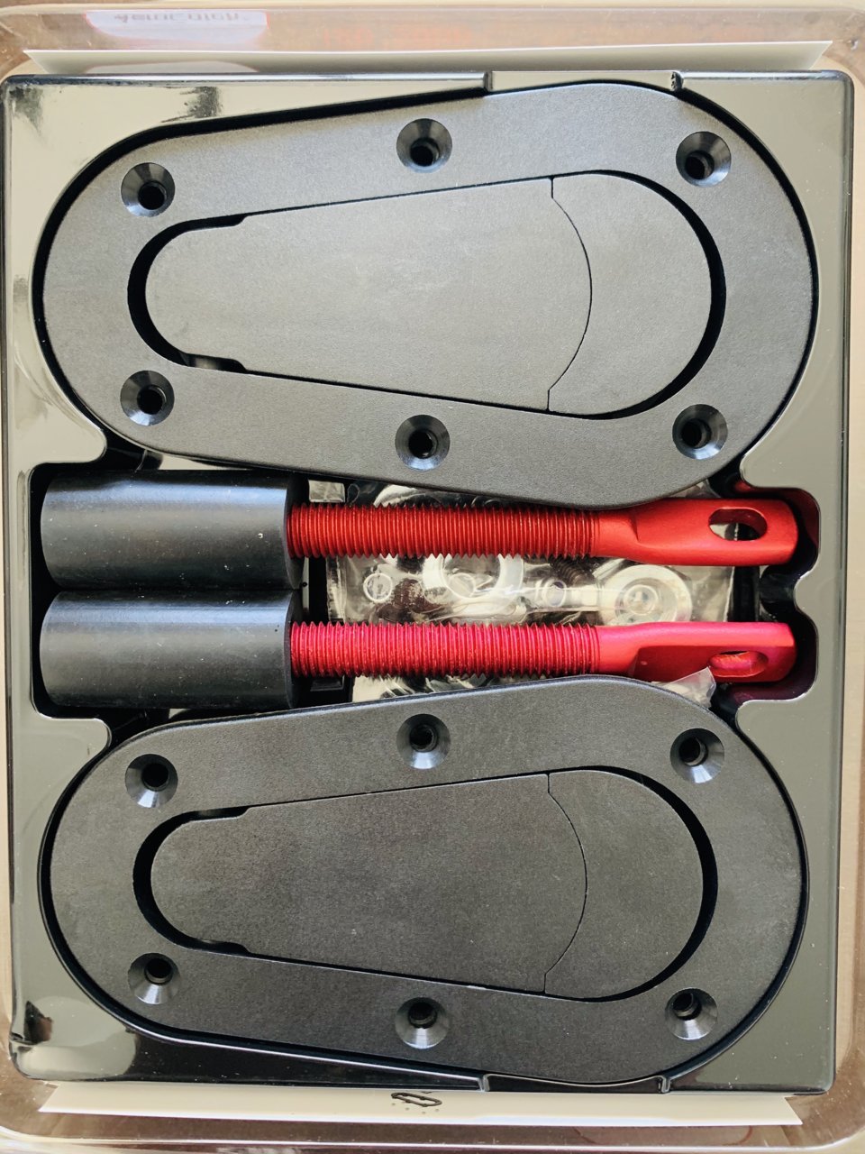

    Also, racetruck shit:

    love my aerocatch's in my truck!

    Glad to hear it. I am looking forward to running the Baja 1000 next year lmao

    If I could offer some advice:
    when you install those through the radiator support, add a piece of metal a few inches long from the underside to act as a washer and spread the load a bit. I’ve seen two sets of those tear themselves out of the radiator support with hood flutter. The radiator support being so thin, it’s easy to stress the metal enough to crack and with severe hood flutter it’ll stress it and eventually fatigue it to failure.
