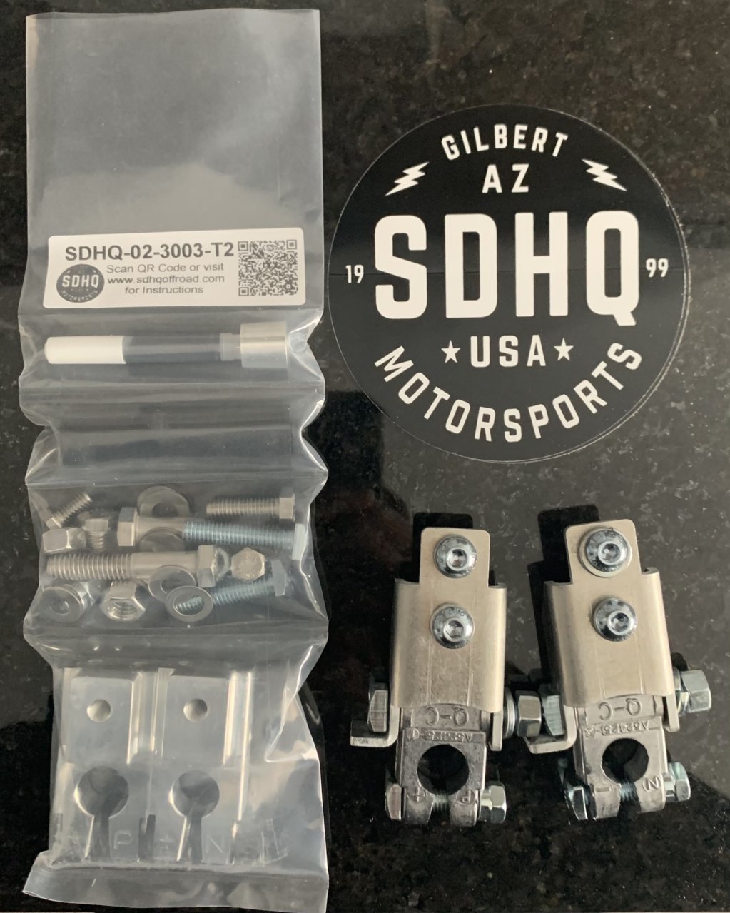

    Got the battery accessories in:

    I've got the same kit to install.

    I need to sell my dual battery goodies and then I can grab a 31M that will be offset by said goodies. Looking forward to it. Also, I have to get my core support welded
