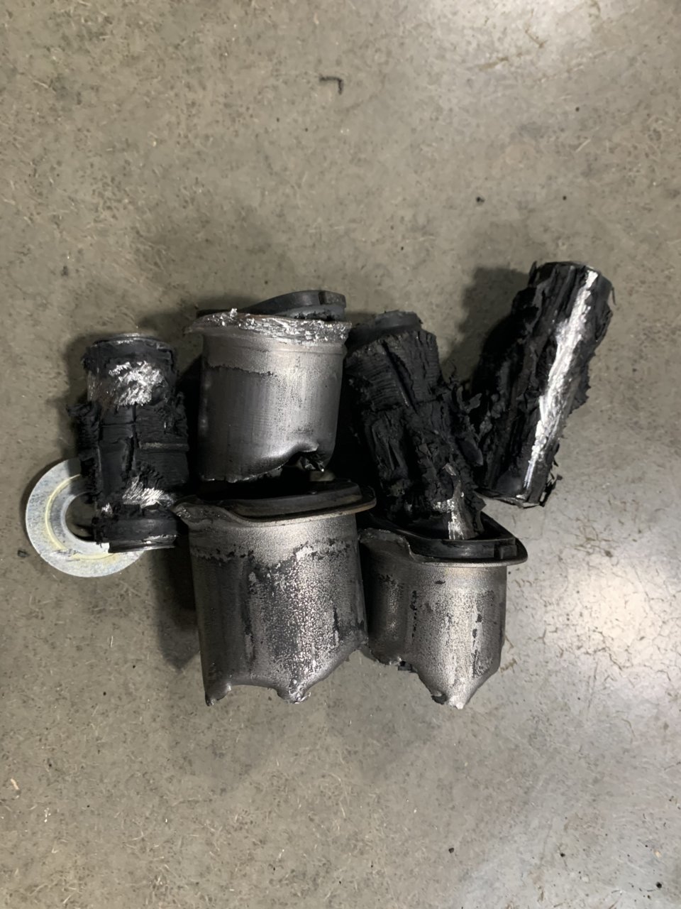

    Carnage
    Complete

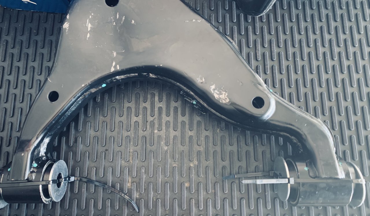

    Air hammer the washers off, use drill bits (make sure you have a ton) and drill out the rubber bushing. Once you have a good amount of holes drilled in the bushing, use a hole saw to get the sleeves out. Take the air hammer with a wide spade bit and fold the collar inward to compress the sleeve. Take a small tapered bit and start pushing the sleeve out.
    You can also make relief cuts in the metal sleeves using a sawzall. The air hammer made it pretty easy. It totaled about 3 hours; first control arm took about 1.5 hours (gathering all the various tools from around the shop and developing a method of attack) and the last one took 45 minutes and then 20-25 minutes to press the new ones in and clean up.

    I used JB weld

    There was a packet. Since I was at the shop, they had stuff there and I saved the packet for the sleeves
