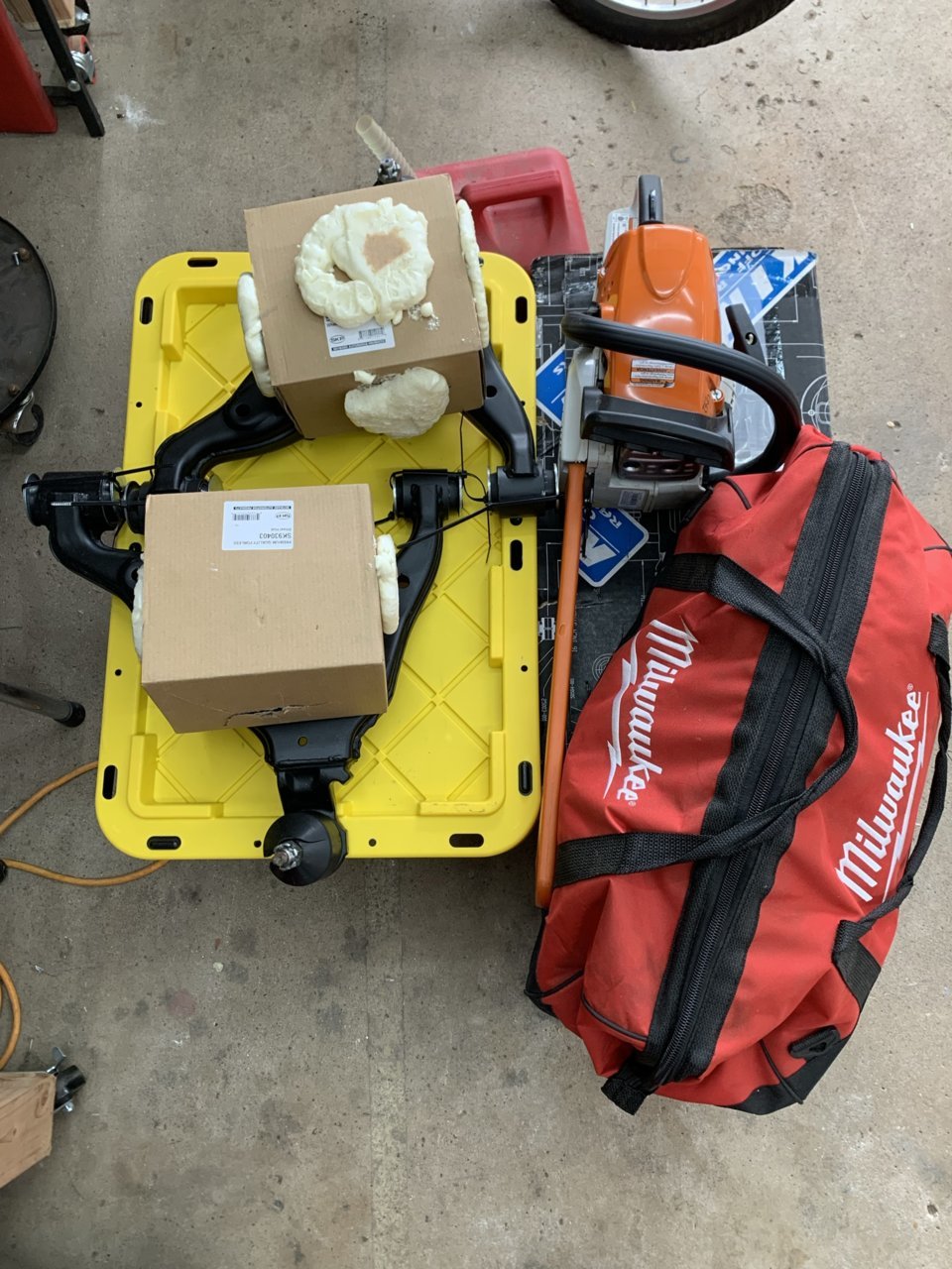

    whatever you do, dont use a chainsaw to cut the lower control arm bolts! LOL. buy some good carbide sawzall blades, makes a world of difference cutting out the old LCAs.

    I was gathering my tools to being to my buddy's weekend and I found some and three them in the bin. Had to use one last weekend to cut a shackle bolt on my buddy's Jeep. Like a hot knife through butter.
    I have plenty of wheels and discs.
    Really nervous about heading into the unknown with this "project". Lots to do. Luckily I have two days if I need it. I just need to get it done and aligned before Monday. Glad to have a few buddies that should make it go more quickly. We can hopefully get both sides going at the same time.
    Just nervous about the LCAs, getting it aligned and the knuckles and wheel bearings. The swaybar mounts shouldn't be too bad. Just worried about being able to mount the reservoir brackets. I can cut the swaybar off if push came to shove. Everything else should be cake.

    you should be fine. Just go slow, don’t rush the cutting. And LOAD THAT BOLT AND ECCENTRIC CAM WITH ANTI SEIZE.

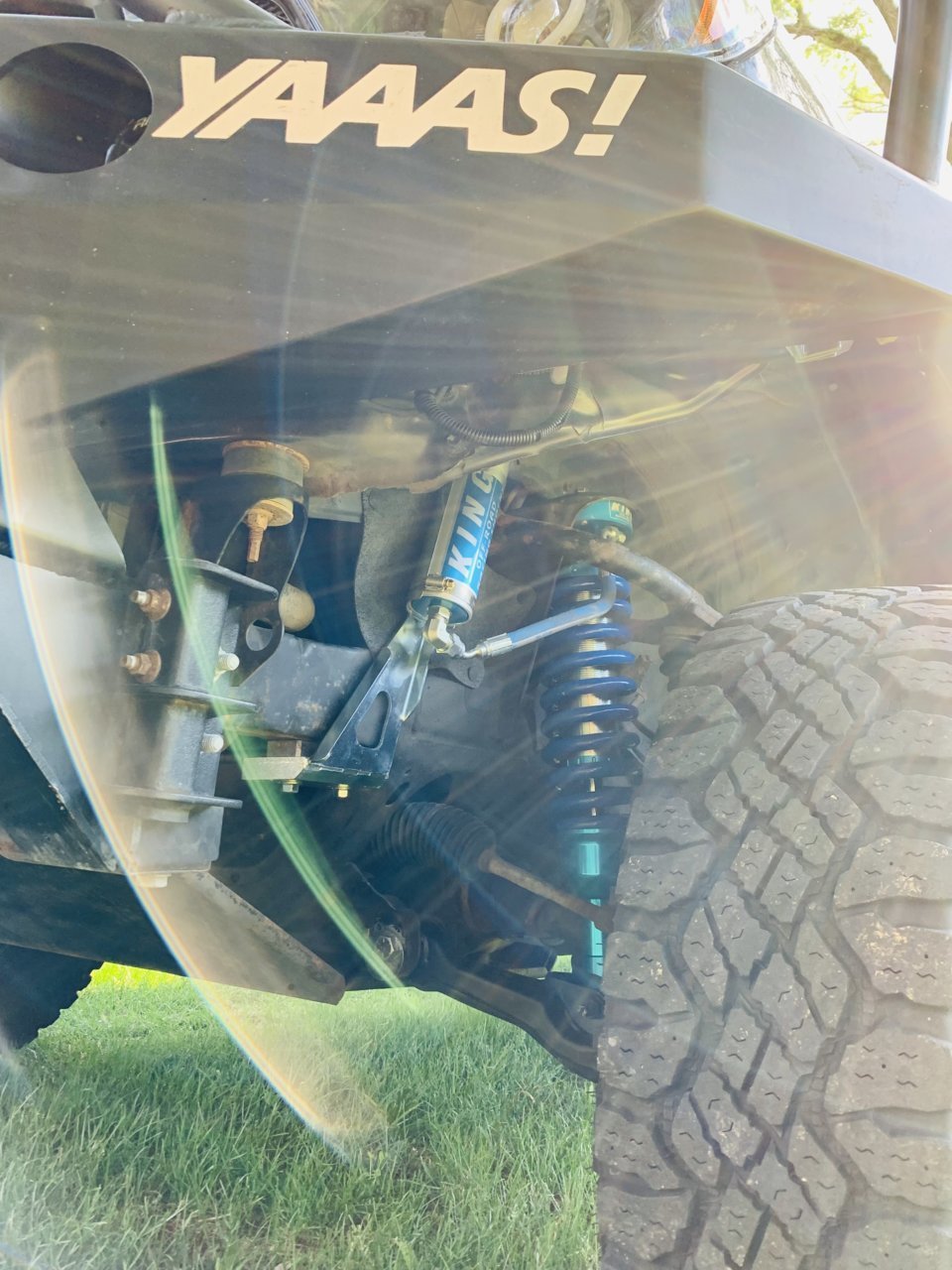

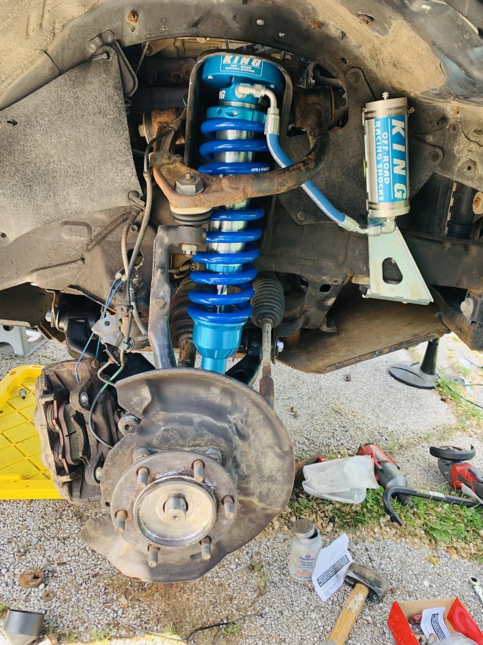

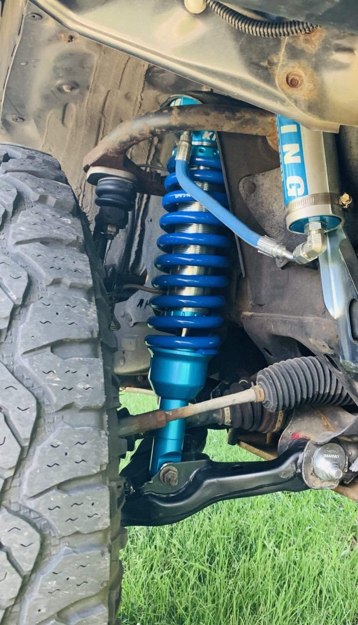

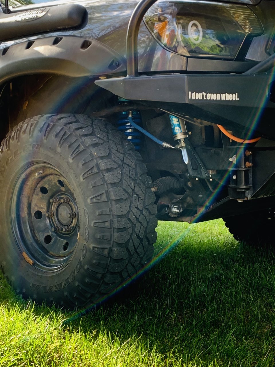

    Well, things went sort of to plan and sort of not to plan:
    - New LCAs in.
    - new shocks in.
    - swaybar off. Party time engaged.
    What's needed next:
    - bushing for the knuckles
    - ABS sensor
    - clean up and paint BAMF LCA skids
    Then I can install:
    - knuckles
    - new wheel bearings
    - new dust shield
    - BAMF LCA skids with new stainless hardware
    Summary:
    - Absolutely SHOCKED and beyond stoked the swaybar bolts came off. I need to look at removing the swaybar relocation brackets.
    - should have done more research on the knuckles and what was needed.
    - OME shock top bolts were rusted and busted when I tried to remove them. Had to cut them. The rear bolt nearest the engine bay SUCKED butt.
    Glamour shots:
    Came home and realized the driver's dust shield was rubbing the edge of the brake rotor.
    Today was a great start to THREE YEARS in the making.........
