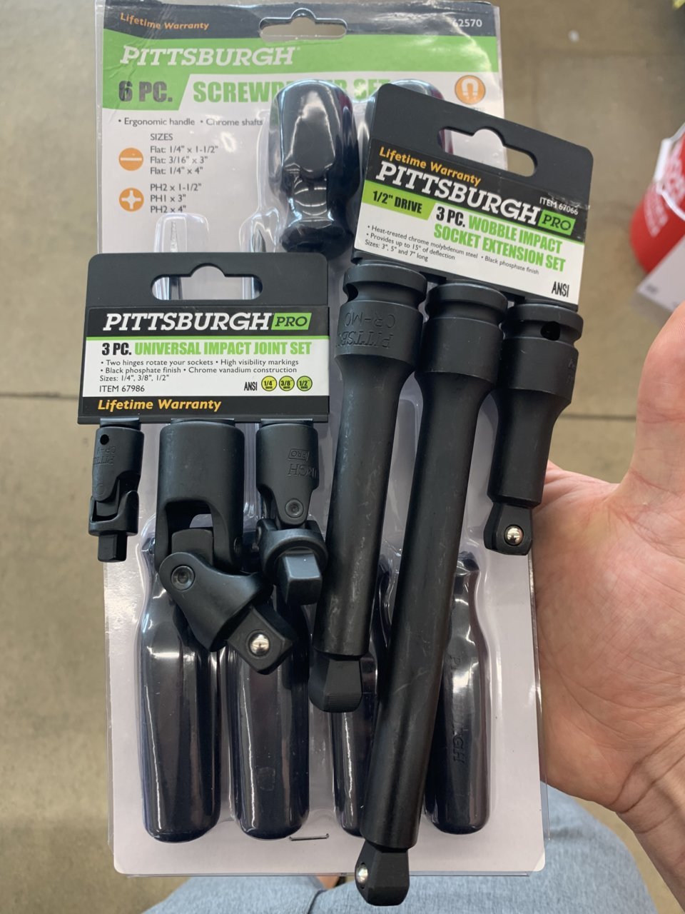

    After this weekend, especially, I have been looking into some punches. After the alignment shop Sunday, I stopped off and got some extensions and "cheap" punches (screwdrivers)

    I have a Milwaukee set that will never be used as prybars or cheap punches. At $3 a set, the harbor freight screwdrivers work for what I need
