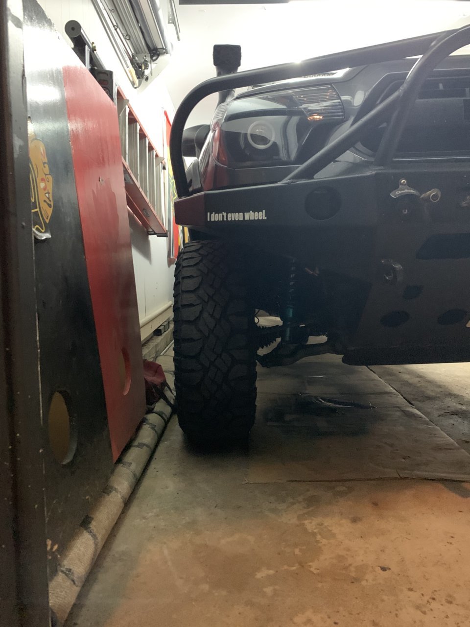

    I was just going to comment on your LCA angle.. but then I realized your wheels are probably on.

    Just walked out and took that in my driveway

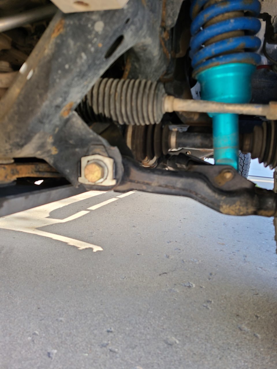

    Definitely non-ghetto. Just my LCA bushing sleeves are ghetto

    Oh lawd Jesus. At least tell me you greased the sleeves when you installed them today.

    Have you driven it at all since you reinstalled the lowers? Because not having sleeves in is sketchy af. Your lowers are literally just flopping around on the bolt and it could definitely damage the polyurethane, making it a much more expensive headache since you’d need new bushings. Idk if those gainz are worth that.

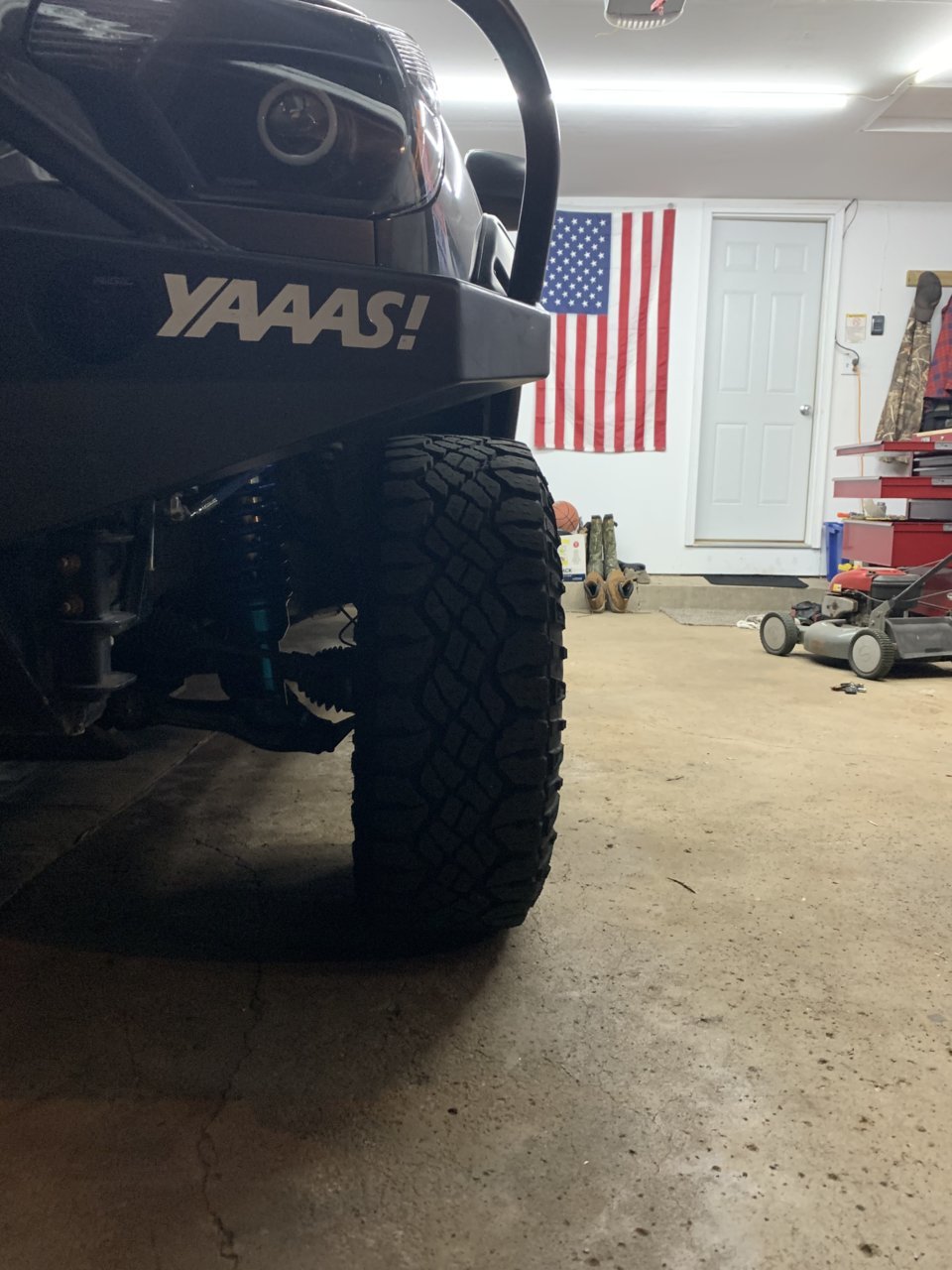

    Wouldn't say incredibly easy, but it's done.
    Calling Firestone in the morning first thing and moving my appointment from Monday (I was going to do this Sunday) to tomorrow after work. If not, I have a buddy near by with access to an alignment rack.
    I want it aligned tomorrow.
    I feel really accomplished. Gave up on the driver's side alignment.
    Time for another shower and a shower beer.
