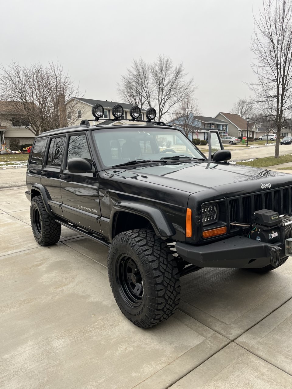

    A buddy of mine got an XJ..so now there's another person to hit the trails with! Starting to be outnumbered with jeeps...

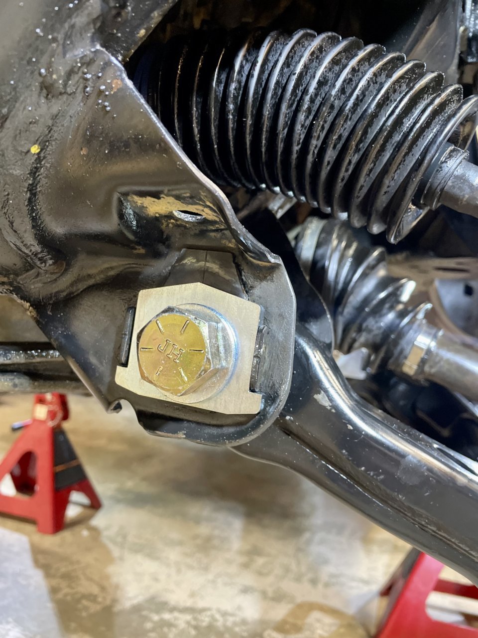

    I like these more than my Bison tabs that i have.

    Thanks for the information. It's a great, cheaper alternative than $100+ kit and all the work to get the stock ones off and installed.

    I have them and have not reinforced anything as they lock it in to a point where unless your stock tabs are completely mangled that it’s not going anywhere. I like them a lot though and haven’t touched caster since install. I have them set to max.

    Why not put those tab things towards the top?

    Yeah I have the taco tabs ready to install but I was wondering about the video of him reinforcing the tabs with key stock. Seems like a great, cost effective option.

    I actually watched this the other day at work. I guess key stock could work, but so would a fat weld bead behind the stock tabs?

    It’s just how the manufacture recommended putting them so I followed it.

    I love my taco tabs, but I would def keystock reinforce or run a fat bead behind the tabs if I had the means. If you wheel mildly-hard, they will shunt your tabs out and make some wiggle room.

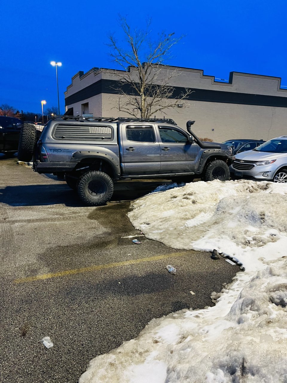

    Some things never change...even when almost EVERYTHING has changed....
