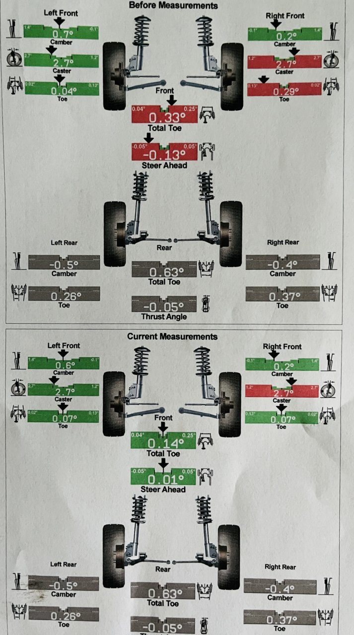

    3" lift? A.R.E cap 285/70/17 moto metal 955 17x9
    Did you look at the caster, one side is 2.7pos and the other is 2.7neg, going wander all over.

    Did a bunch of driving this weekend. Stayed straight between the lines.
    I've been thinking about changing up the control arms recently. Maybe a good black Friday sale will appear.

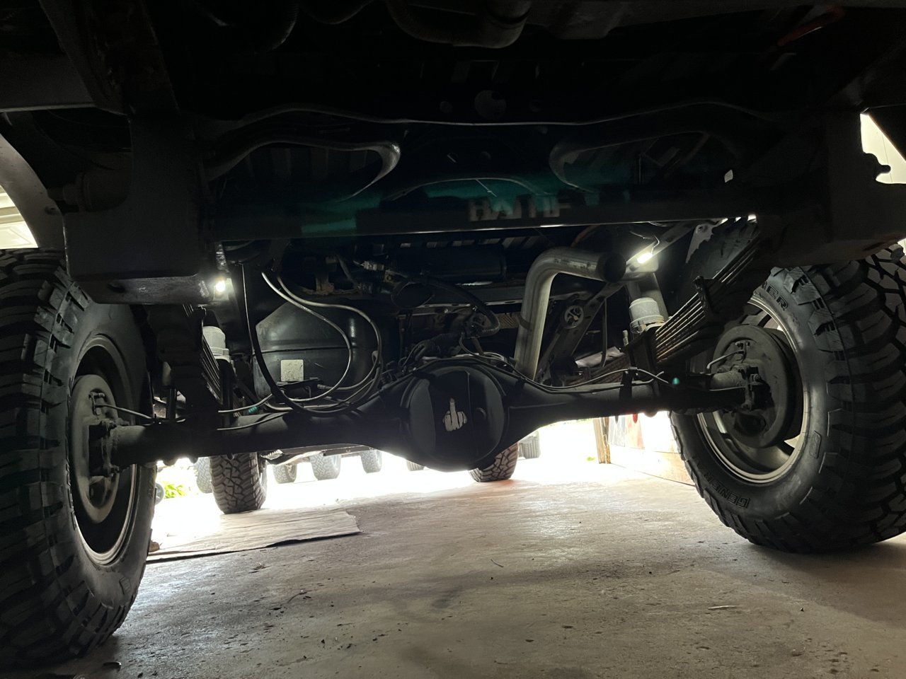

    The rock lights harness took way longer than I expected; usually how this shit goes.

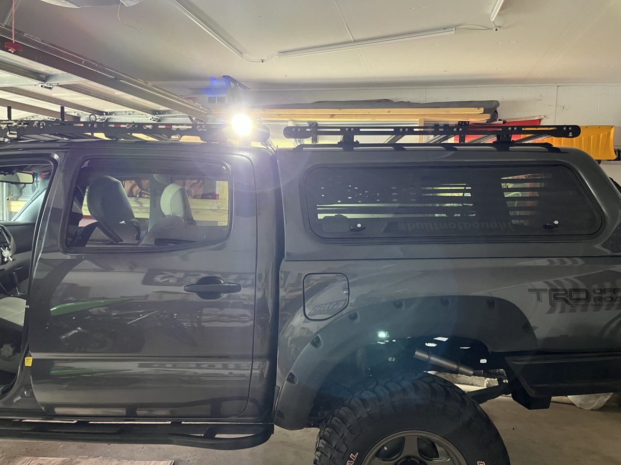

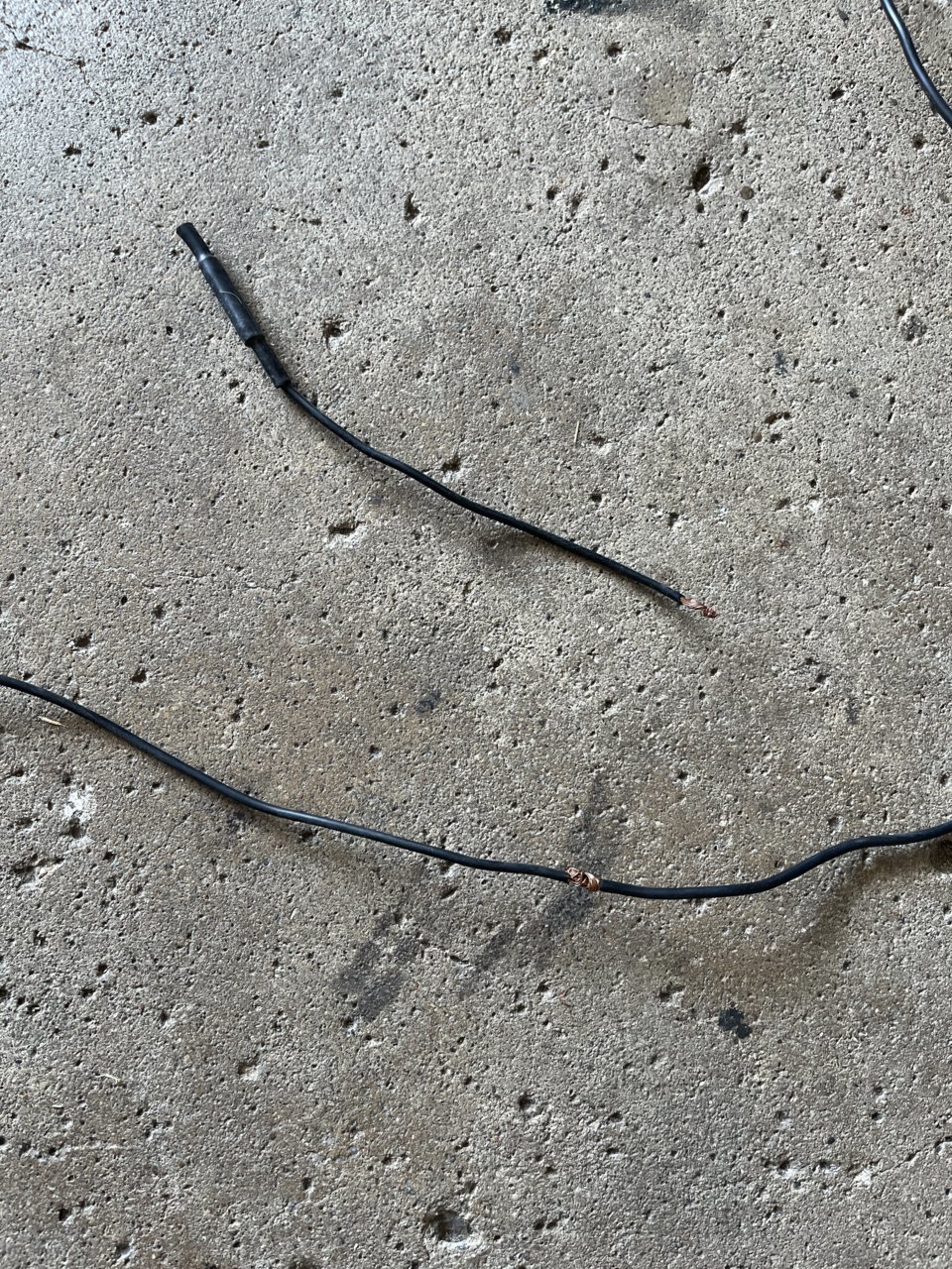

    First up, was repairing the roof rack lights. I bench tested them on Thursday and they worked so I knew it was the harness. I pulled the wiring down this morning first thing and as soon as I brought the harness down from in between the cab and the topper, the issue was found:
    Easy fix. Cleaned up the wiring a bit. I'm not sure when I got these heat shrink solder fittings, but the roof rack lights didn't use that. They do now.
    Since the old mounting location was pretty much useless when my RTT cover is down, the lights are useless on the driver's side. So I relocated them:
    Really happy with that.

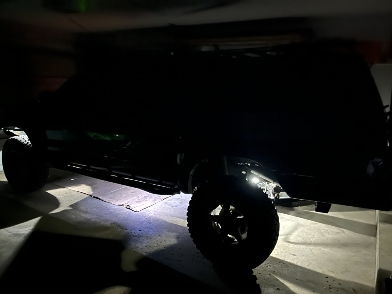

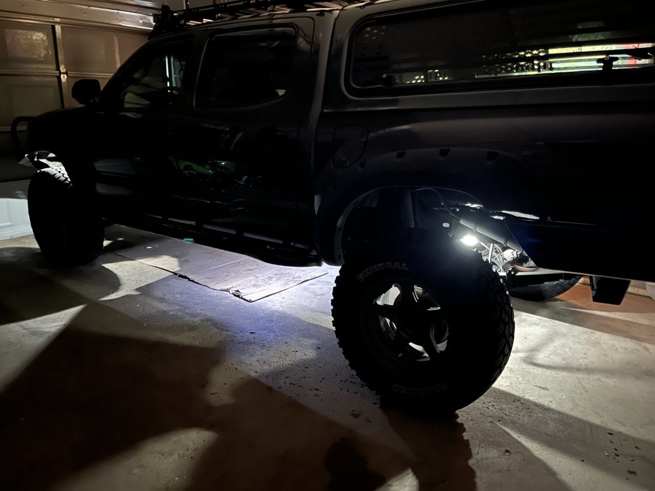

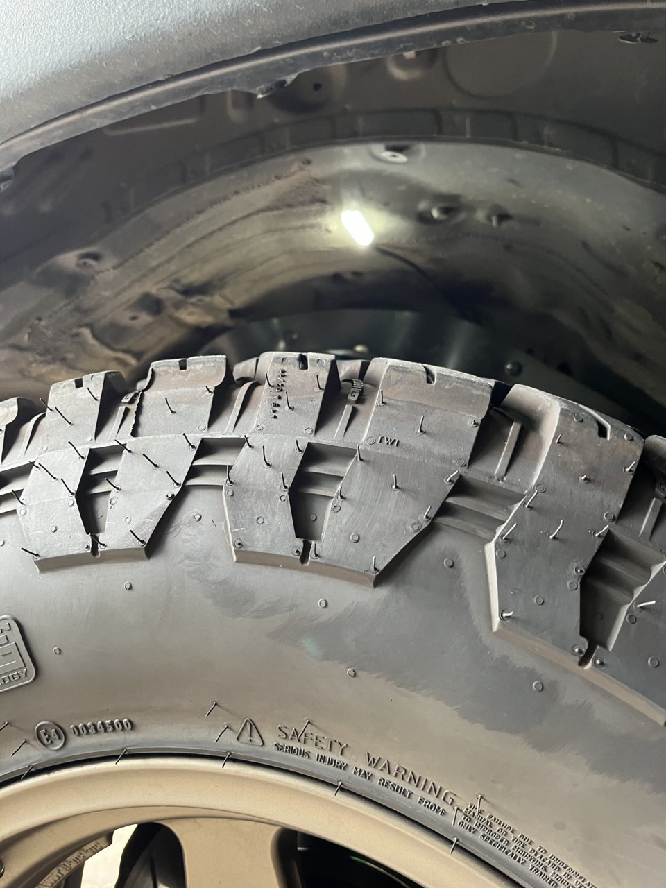

    Next, I move on finally mounting the new rock lights. I've had these sitting around for 2 years. The old harness still worked after I taped it off and wrapped it around a leg of the slider for a year (?) Not sure. It just had to be extended. I used waterproof deutsh connectors for each light and each section of the harness. This means that if a light goes out, or a section of the harness goes out, only that light or section has to come out. Again, using the waterproof shrink solder fittings.
    I only have 6 lights; two of the old ones and 4 of the newer style ones. It was still light outside so it wasn't totally dark:
    Not terrible.
    Overall very happy with today and the progress. It was so hot and the heat took my brother out a bit. He's feeling better luckily.

    Pitch black out:

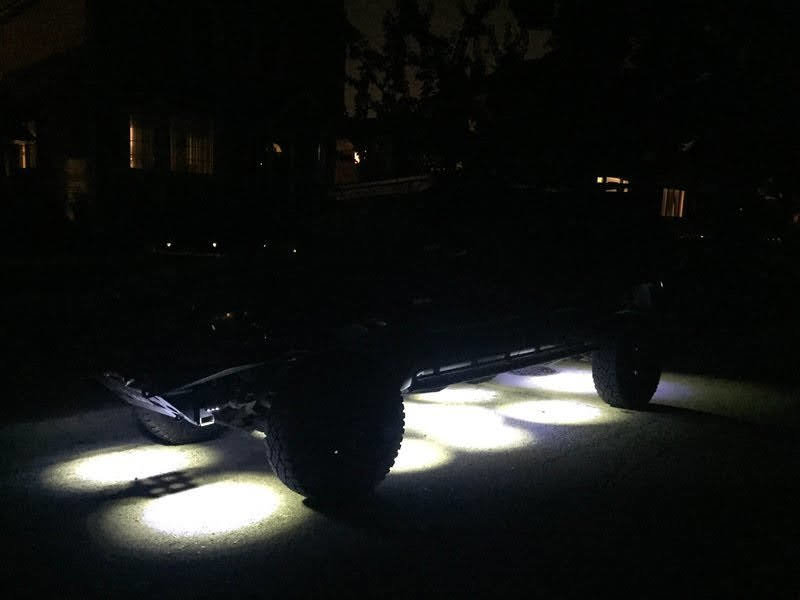

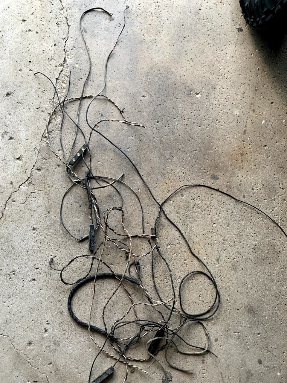

    Throw back to when I took the Tacoma to the dealership for the frame coating recall and they cut my old rock light harness. There was also lights missing; at least 4:
    Old setup at night..
