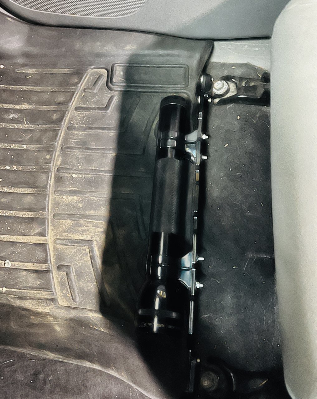

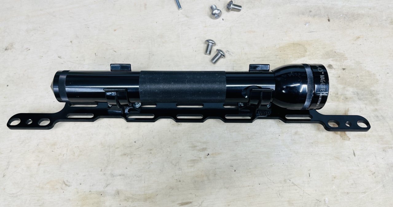

    Passenger side DDI molle panel and maglite mounted:
    DAC7991D-7A17-4887-A13D-27B4FD5E8BE0.jpg 88DD0D06-36CD-42BE-A139-1F1547D9C78B.jpg

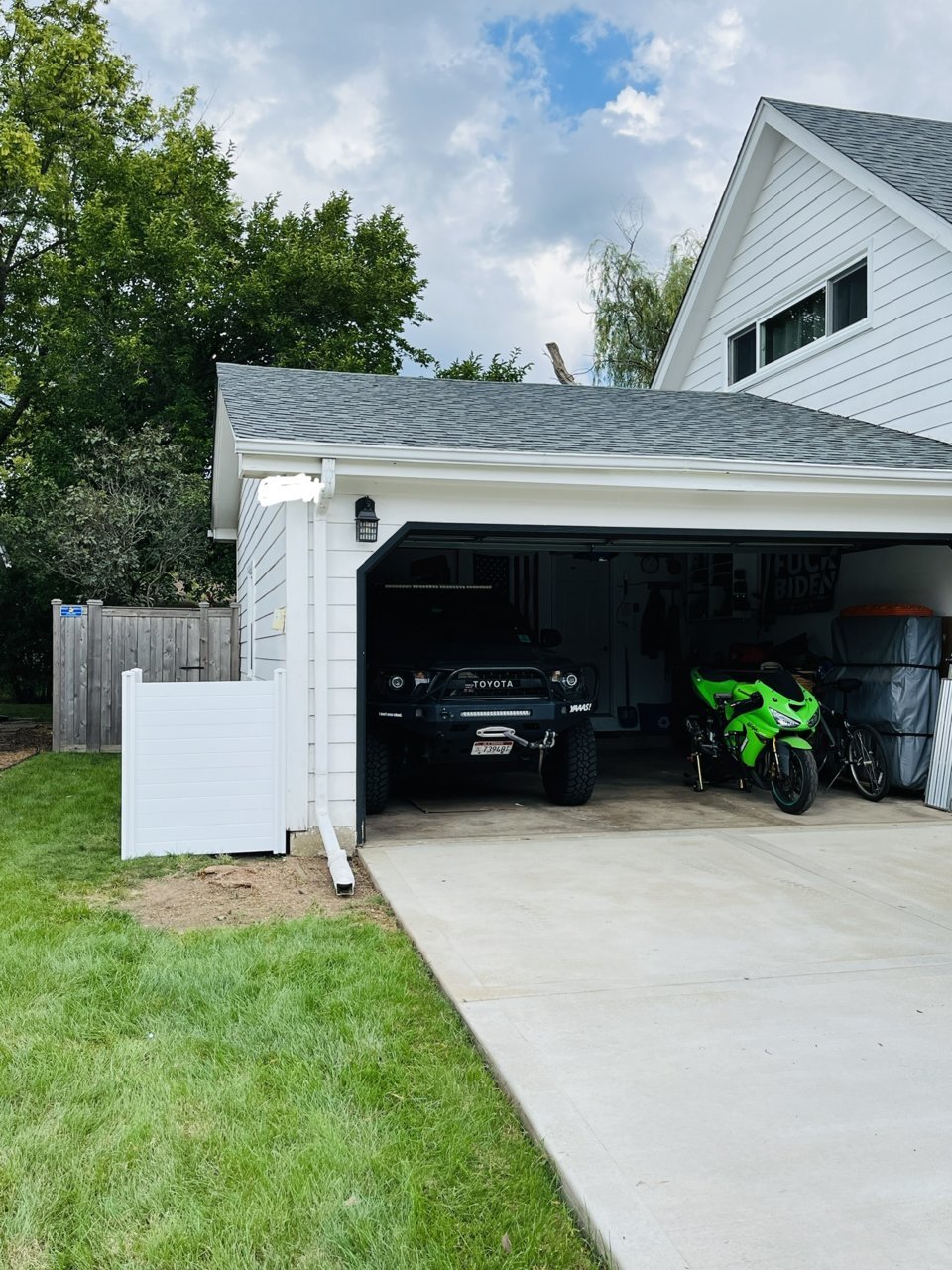

    Last weekend; truck mods. This weekend; house mods:

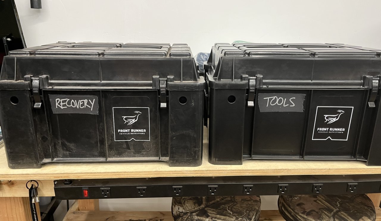

    Starting to consolidate and organize:

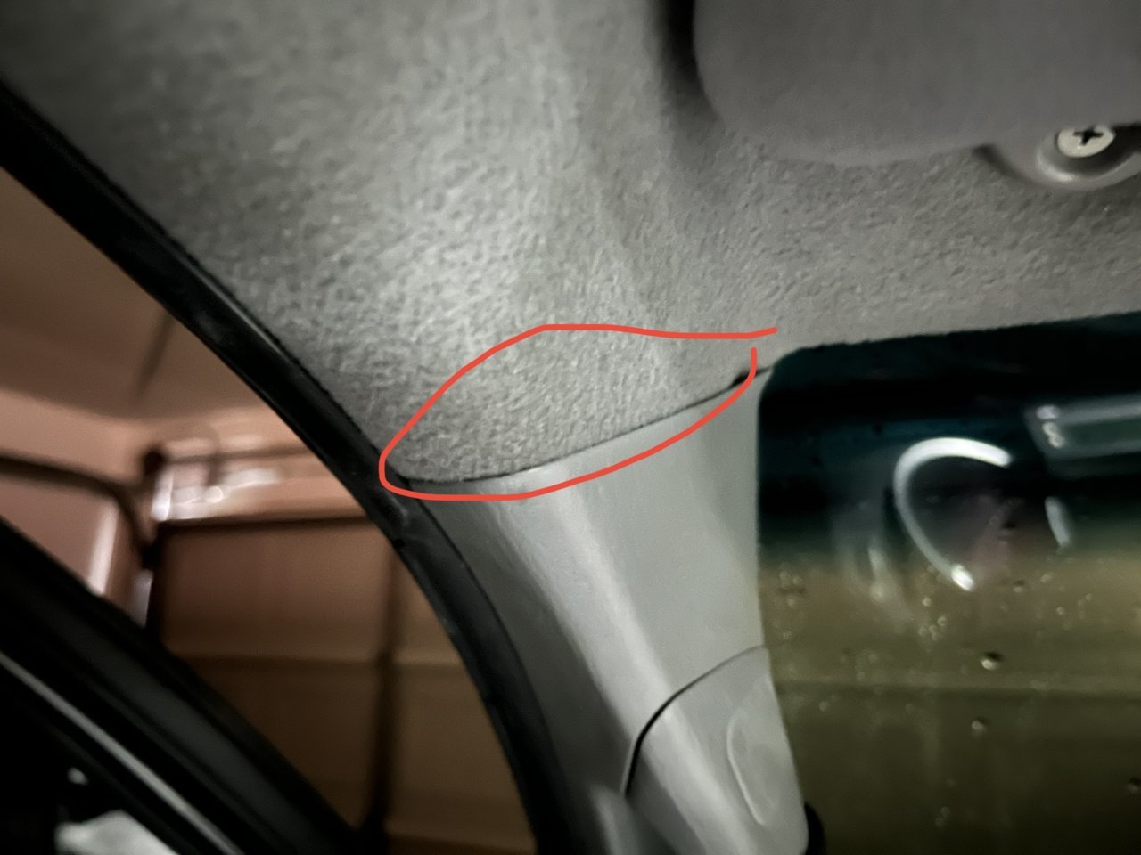

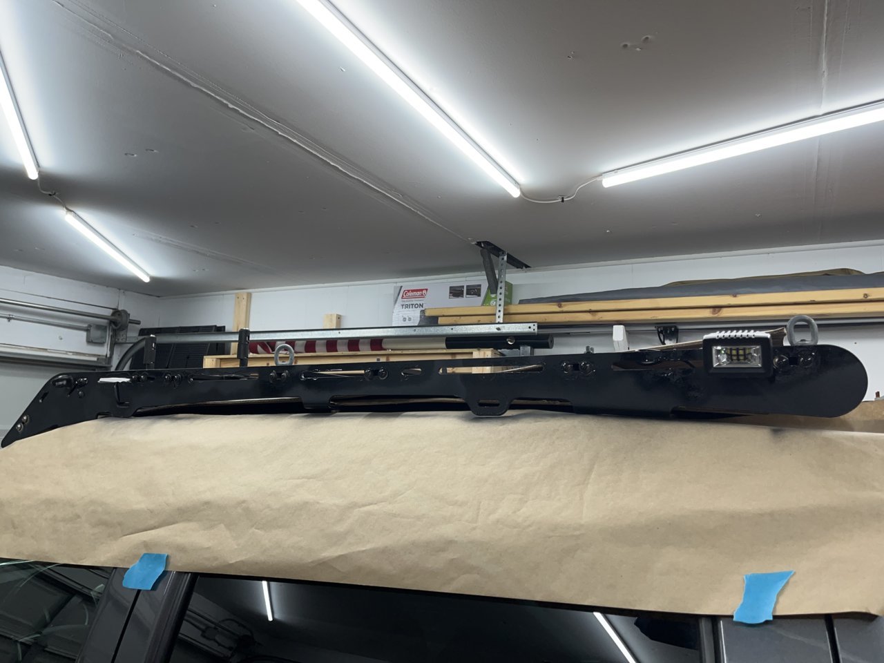

    It has been raining so much and so hard for the last 18 hours or so that there was two damp spots in the headliner this afternoon.
    First one right by the driver's A pillar:
    Second spot was the passenger side B pillar:
    Driver's side was just a little damp. The passenger side was a little worse but neither were dripping.
    Got home and got to work. I let the truck dry off in the garage as best as it was able to. Used towels and the leaf blower so that water wouldn't pool or pour into the factory holes. Started removing the bolts (one at a time) and blew them out with compressed air. Cleaned up the bolts once I got them out, put more silicone on and a dab in the holes before tightening the bolts.
    Using a hair dryer, I dried the headliner and tested that it was dry by using a shop towel and using a good bit of pressure until it was bone dry.
    Finished up by going around the entirety of the headliner and made sure there were no other damp spots. There were none.
    A bit irritating, but, considering the fact that I've had this roof rack installed for 8 years and this is the first time there's been moisture isn't bad. The silicone I used back them might be reaching end of life. Luckily, this week will still be pretty warm so everything should dry and cure well.
    When time allows, I will probably do the same thing to the remaining bolts just to be safe.
    Got lucky.

    The $5 pencil pouches from Walmart about that size are amazing as well. The Magpul Daka pouches work great if you have the cash and need them to be water resistant.
    Always a great feeling of having your stuff organized.
