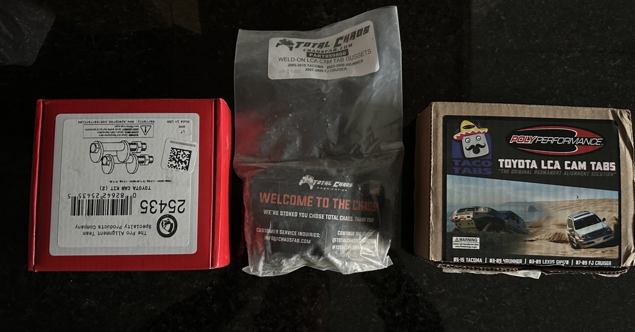

    Temporary until the taco tabs can be swapped in. Got a spare set in case there's a chance they seized from August of 2021. Doubtful they are seized? Yes. Cheap insurance in a pinch? Also, yes.
    I have both; in boxes. I've heard the Marlin kit is a PITA and doesn't clearance all skid plates/LCA skids.
    The preference seems to be the TC kit. Plus I plan on going with the taco tabs and I don't think those work with the Marlin kit (based on interweb photos).

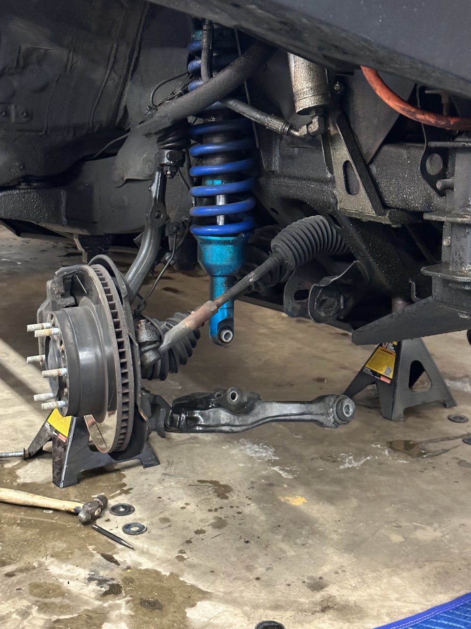

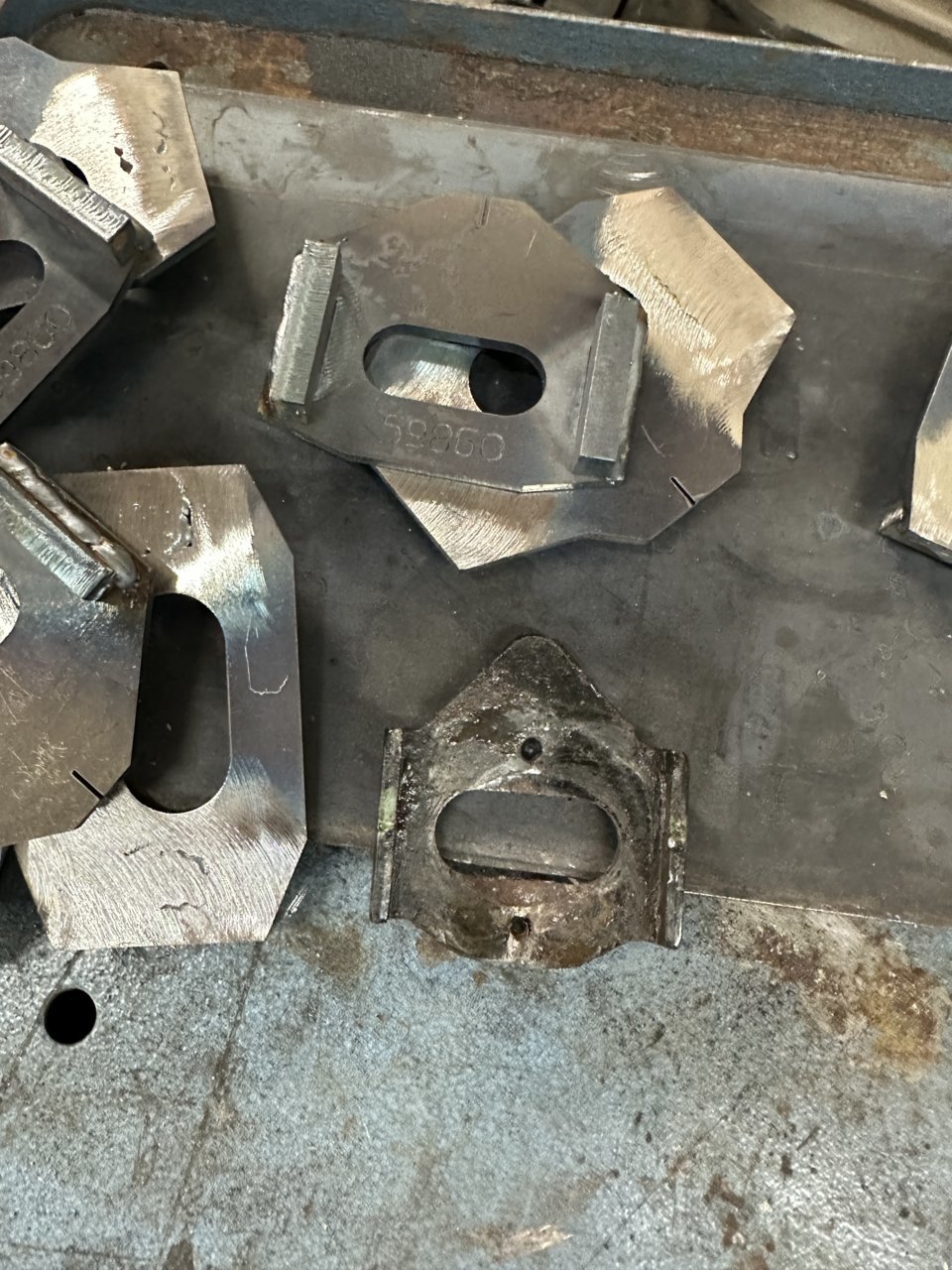

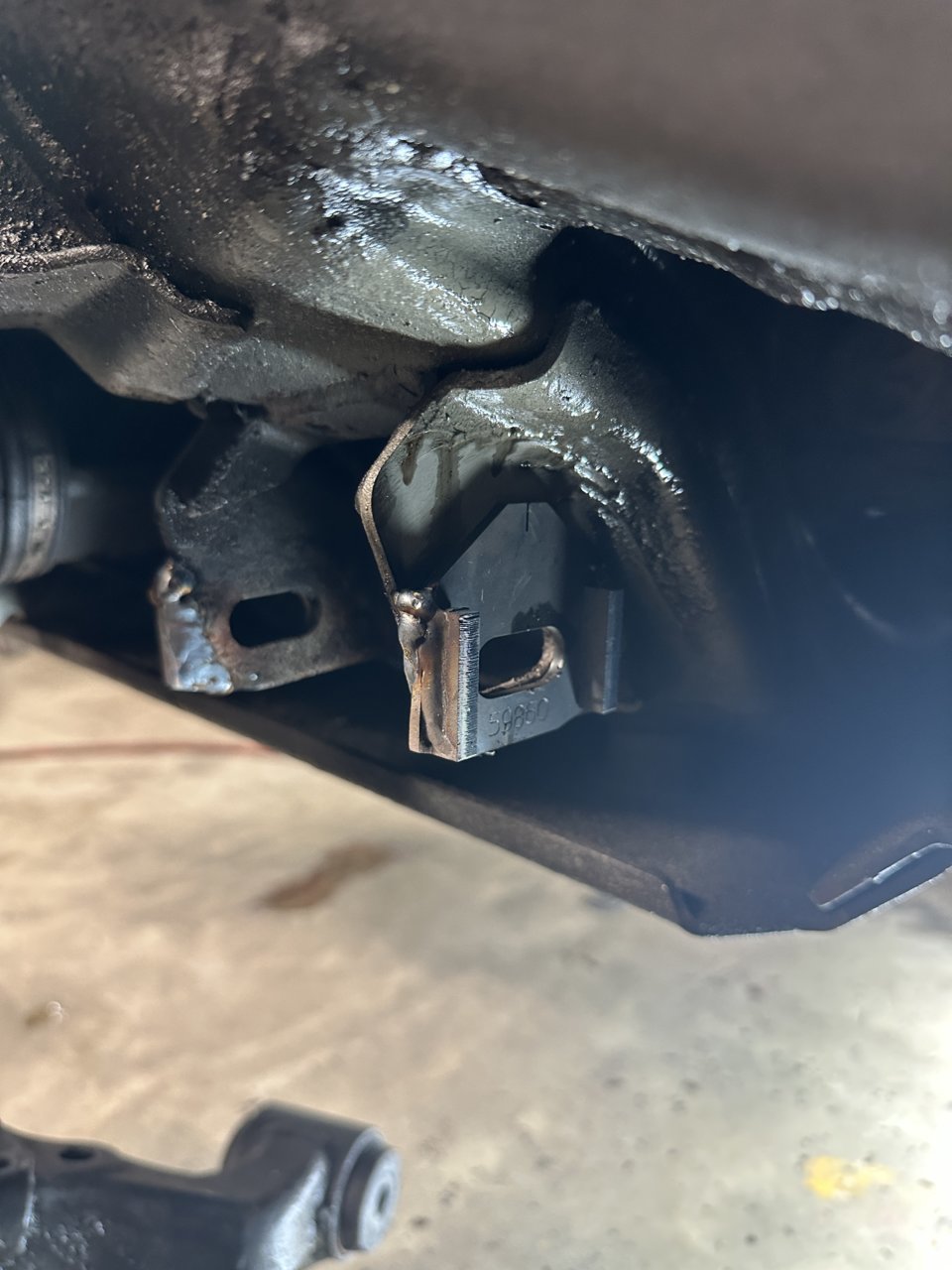

    What a weekend in general..managed to get some work done on the truck today and it's something I'm happy to have done and behind me. Got the TC gusset kit and taco tabs installed:
    750A731C-B980-464F-9A65-B821696F3313.jpg 0B0955E9-E28C-45DE-A54E-36B3279302B4.jpg 687A21E3-F24C-4C82-BF23-3F4EB8A5C4BC.jpg CB03EBE5-F553-4239-89BC-F474940B9B28.jpg 004841D8-3D46-47F0-8B09-AED72FAB594F.jpg
    Neutral fronts; max caster in the rear.
    The steering wheel is still just a little bit off, but I have an alignment scheduled for tomorrow early afternoon to get it just right with the lasers.

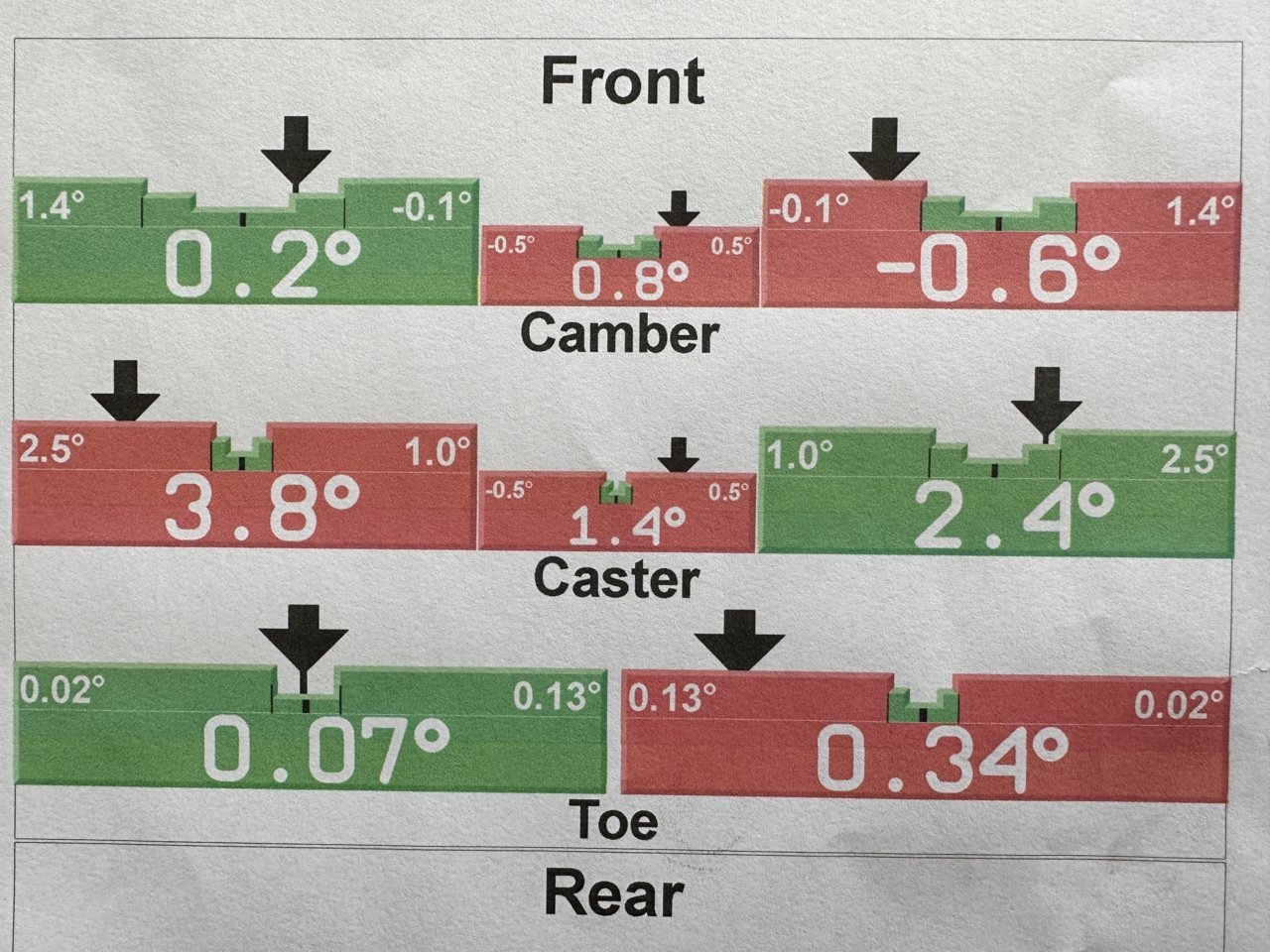

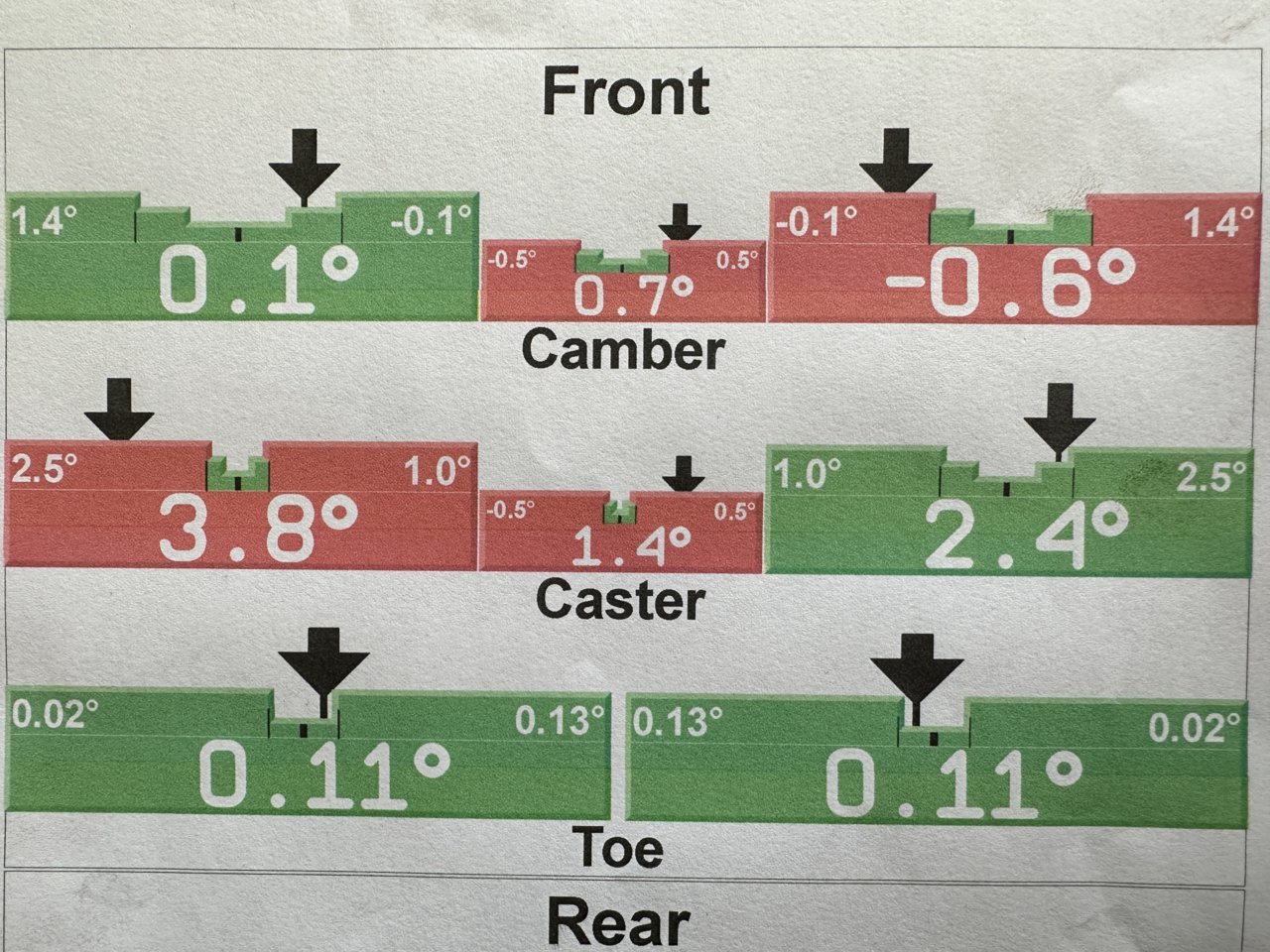

    Can't seem to catch a break with Firestone.
    I called Firestone Friday to schedule my appointment and made sure that the master tech was going to be working. Schedule confirmed. Appointment booked.
    Show up today and they start working on it and low and behold, the master tech is NOT there like I was told Friday. I get a half apology from the techs that are working and I get them to at least get the steering wheel dead straight but the truck still pulls to the right when I let go.
    I am going back Thursday morning and I will be sure to call ahead of time and make sure the master tech is actually there.
    Below is before and after for now done by two techs that half know what they're doing.
    DC0C356C-F8AC-4DDA-A13C-7A5141B57434.jpg 25A4F99A-63FF-4038-9346-85AADAECEA9D.jpg
    Firestone doesn't want to work on the truck anymore and wanted to refund my lifetime warranty but that's without even having a master tech look at the truck.
