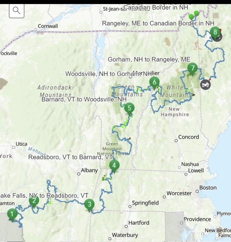

    I think im going to be in western MA. Also on 2 wheels. But ill definitely hit you up. Im not sure how many sections we can do in a day, but this is the route.
    Offroad on a motorcycle is much different than offroad in a truck. Less luxuries (aka no rtt or fridge :rofl:)

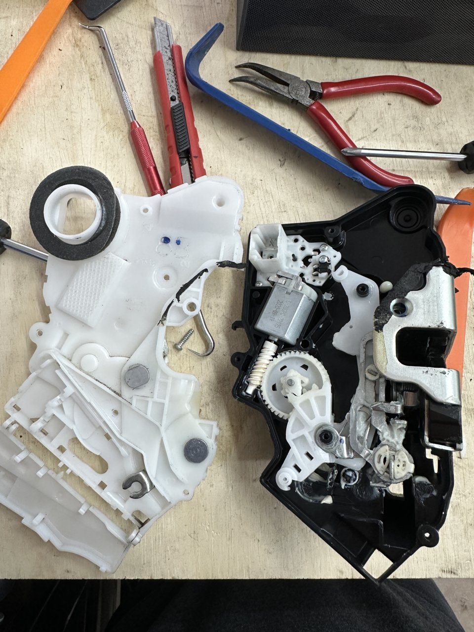

    how hard was it to do? my driver power door locks no longer work so I have to manually use my key to get in. Been meaning to buy a replacement and just swap it out but maybe I'll try taking it apart first and seeing if its a simple fix.

    Oh shit. I must've missed a thread or whatever. I'm not as active as I used to be and definitely won't be as active over the next few months. Although I'll try my best to.
    Once you do it once or twice, you get the hang of it. I've taken apart the rear driver's, rear passenger and front passenger twice (?) now. The only one I completely swapped was the rear driver's from a seller on ebay and I sent my core back. I tried fixing it because I thought it was the actuator, but the whole unit was too far gone; maybe wiring or something else.
    The one in the photo is the front passenger so the driver's side is the same but obviously reversed.
    Swapping the actuator is the cheapest option, but when you take it apart, you have to make sure everything lines back up before you snap it back together. But make sure you test it in the door first, and make sure it shuts and works as intended. And then make sure the screws go back in before you button everything up (learned the hard way).
    It's probably a 6 out of 10. It's a tight space, getting everything internally lined up but then back in the door lined up and making sure the doors lock/unlock and the window goes down and back up. I would rather do this all day than do any type of wiring project. Hate wiring (more than a positive and a negative).

    sweet. thanks for the info. One day, I'm going to stop being lazy and actually try to fix it.
