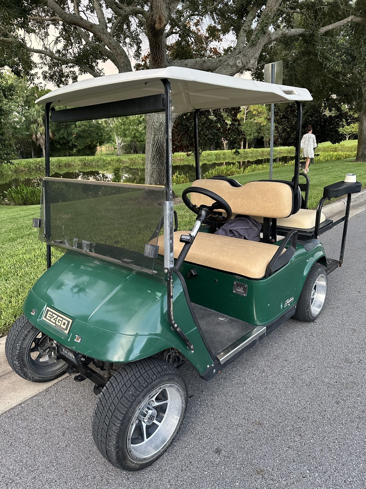

    Went farther than any other night, tonight. One loop around the community is about 30-35 minutes. We went around twice.
    We're pretty certain that there may have been a front impact of the wheels and the wheels in bad shape moved to the rear so as to not violently shake the steering wheel. That or something in the suspension/wheel bearing is bent/severely worn. Our next plan is to remove all the wheels and put it up on jackstands and inspect those components. Might even consider taking the wheels into a shop and have them give them a once over; if they do that.
    That will kind of give us an idea of how to proceed, next. A new steering box will be ordered soon and I would prefer to do the steering box and lift kit together while everything is apart once.
    New seats, steering wheel, battery meter and rear seat armrests are being delivered tomorrow.

    New seats, steering wheel, rear arm rests with cup holders..and a sunset cruise through the neighborhood.

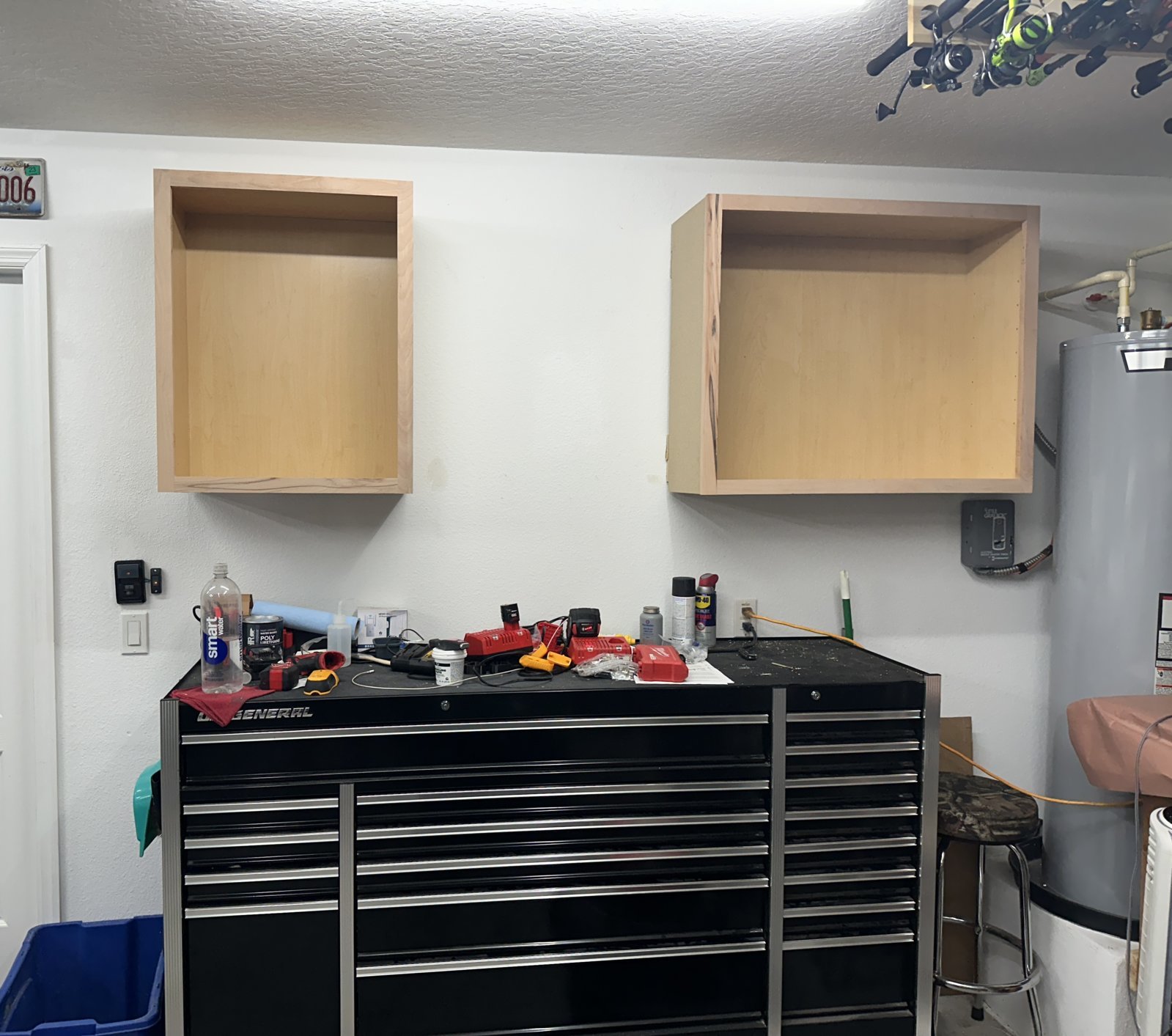

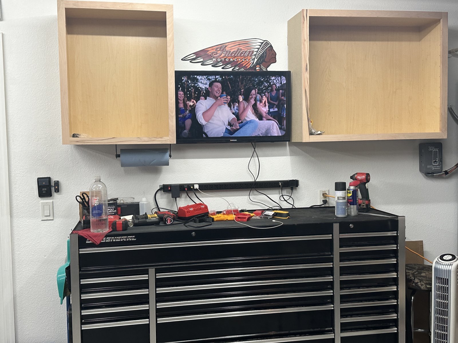

    Garage update:
    Getting sick and tired of staring at the "mess" in the garage. Had the cabinets on my workbench and the plywood laid out for cutting and the plywood became a temporary workbench for working on the golf cart because the 72 work top is filled, too.
    During my lunch break today, I was able to get the plywood ripped down into strips for the french cleating for the cabinets. I made sure to keep each piece together and labeled them. Having the foam board backing to support the wood all the way through the cut was a game changer for smaller pieces. The one annoying part with using a circular saw is having to switch the angle and blade depth back and forth for each cut. That and having a left hand saw. I am considering picking up a right handed circular saw and perhaps selling this left handed one.
    I have to get the mitre saw out for cutting the cleats to length but I prepared for that tomorrow by moving the cabinets off the workbench. I will probably make those cuts tomorrow and likely start securing the cleats to the wall and cabinets.
    I hope to have the cabinets hung this weekend and do the polyurethane and final fit and finish once everything is mocked up, first.

    Felt like there was a lot of typing in here today:
    Hard part is done. Thanks to help from the wife.
    - TV fits in between
    - reclaimed some workbench space
    - going to look into under cabinet lighting
    Stoked for this to be moving along, finally.

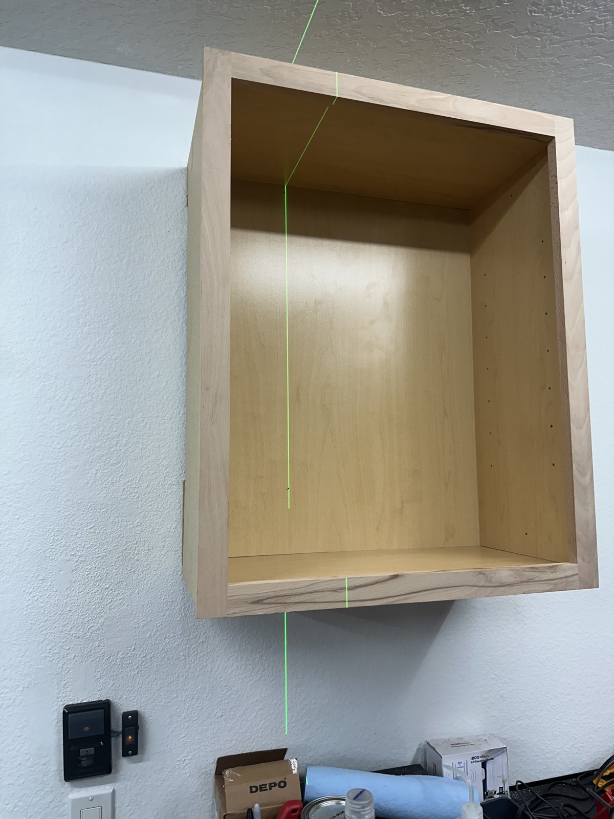

    Not terrible, considering:
    Cut down the 24" top wall cleat flush with the cabinet so that the coming shelf across the middle will fit right. Then, I got the laser back out to drill pilot holes so that the cabinets can be mounted through the cleats to a stud to be able to hold some good weight. Probably better than relying on the inch and a half screws holding the cleat to the cabinets. The 36 has 4 and the 24 has 2.
    Ready for polyurethane and fit and finish.

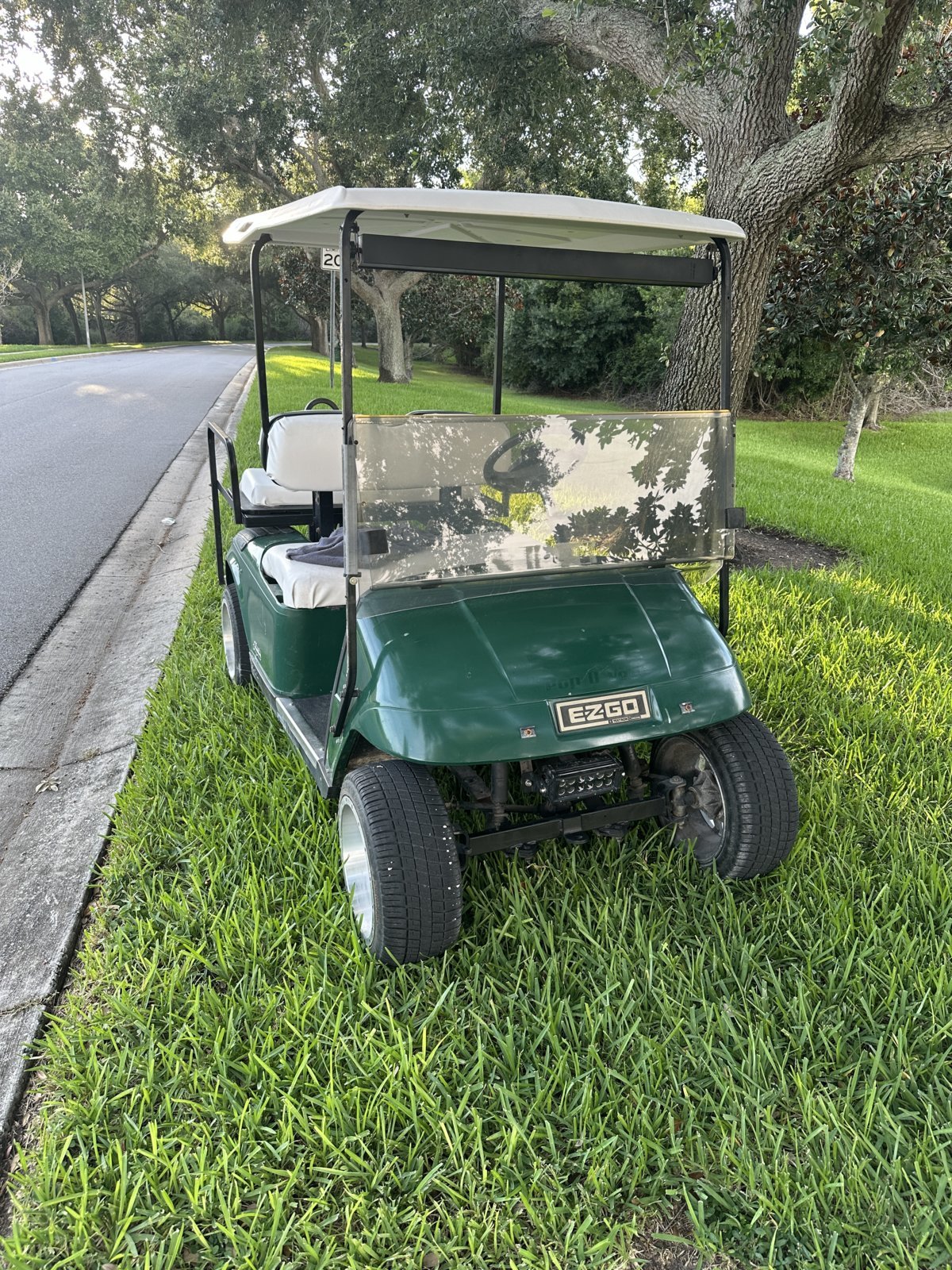

    Tonight's progress:
    Quick drive around the neighborhood in the golf cart due to lingering thunderstorms in the area. The wife wanted to help make more progress on the back wall.
    Tv was free and left by the previous owners. Chromecast from don't know what year streaming YouTube. Works for a garage. Stoked.

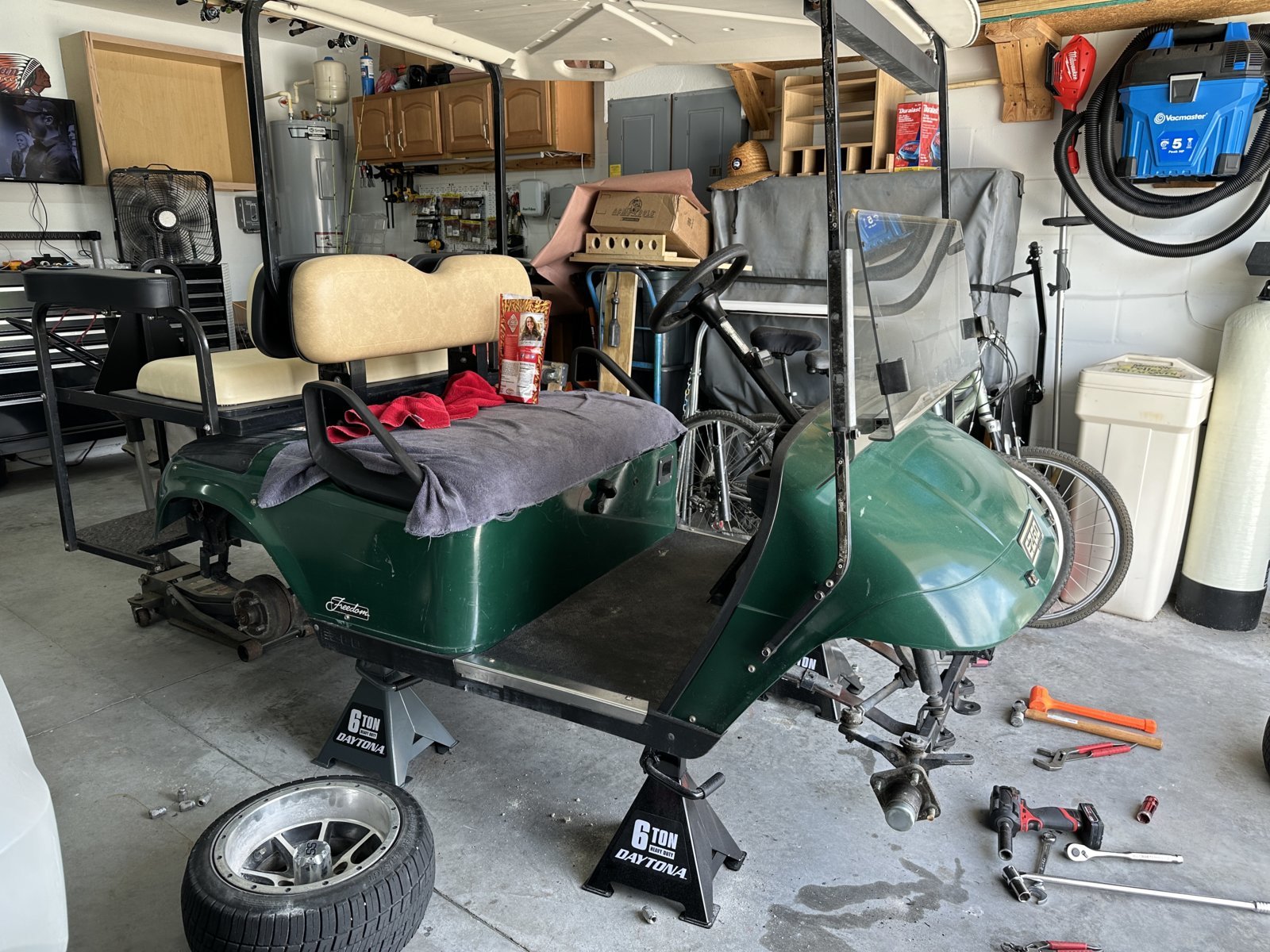

    But you ain't got no legs, Lieutenant Dan.
    Inspection completed. Wheels seem straight. Tires need replacing; which we planned on doing with the lift kit anyways. The tires are mounted weird on the wheels. Best way I can describe it is somewhat egg shaped like the tires sat flat for a while.
    The front spindle bushings seem bad but I was able to shim them a little bit for the time being and it feels better. I tightened up the front driver's side axle nut, too. I also threw in a few cotter pins up front as some were missing....
    It seems the wife wants wheels AND tires instead of just tires because these wheels are "scratched and gross". Further discussion and research of agreeable wheels and tires is needed.
    Definitely going to swap out all shocks (the ones on it seem blown) and I will probably get new tie rods and front hub bearings/bushings as well.
    Going to order everything in the beginning-middle of next week.
