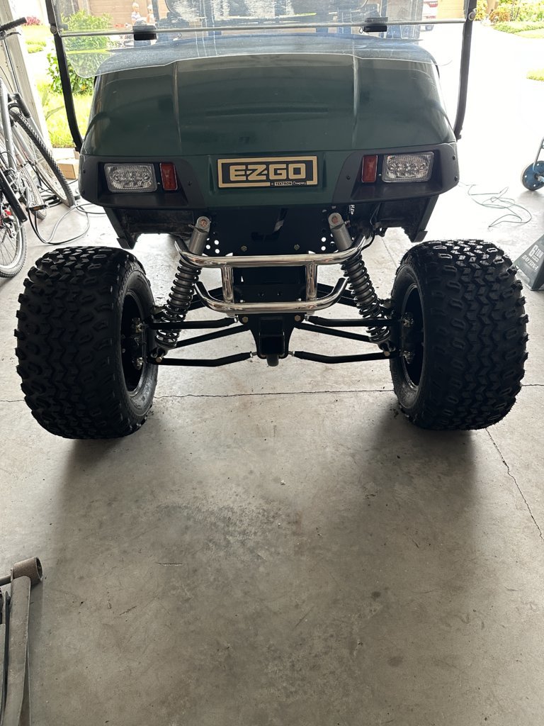

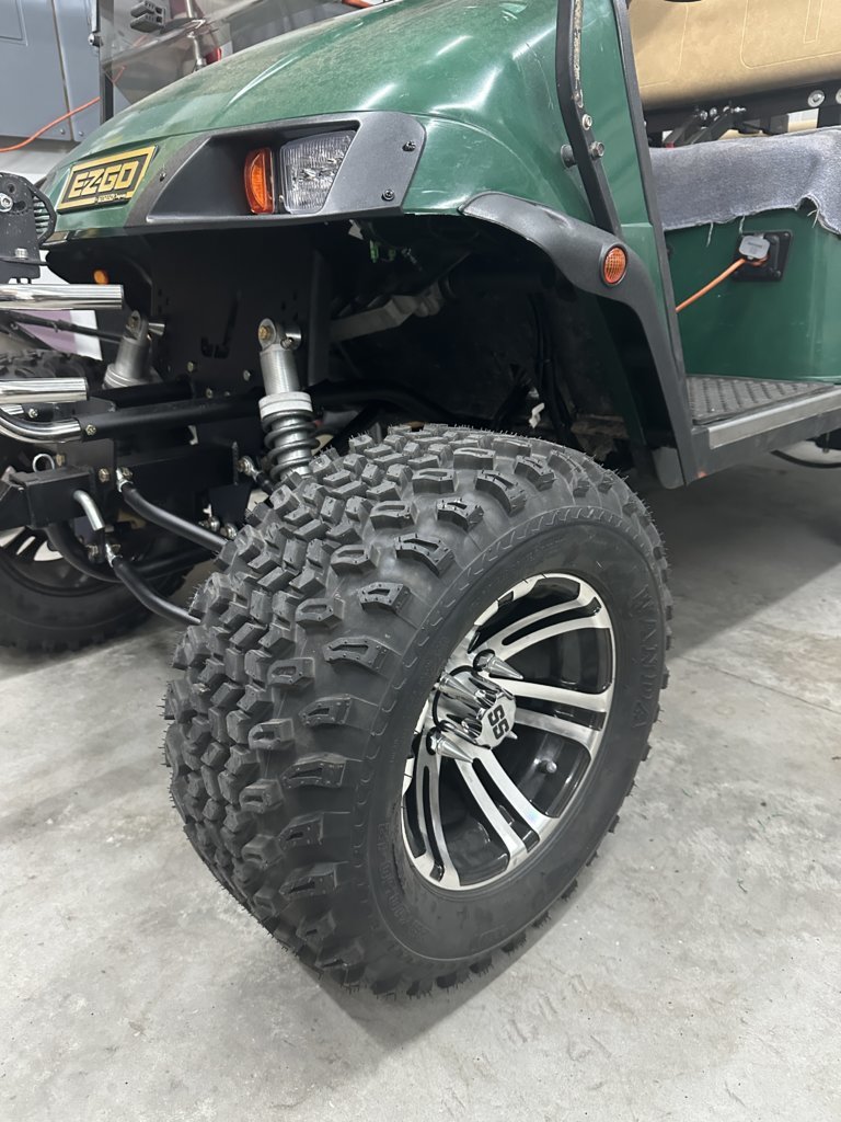

    Spent an hour or so yesterday getting the front lifted about an inch to an inch and a half higher. Then, I got it toed out about 1/8". The install instructions suggest toe in, however, this thing barely hits 20mph and is only used for inside the gated community. Once I decide if I want to give it some more juice, I will probably change to toe in. I used these settings based of automotive recommendations. Rear wheel drive and lower speeds = toe out.
    Pretty happy now that it's done.

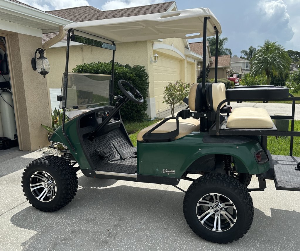

    This is a GEM cart, thats lifted? I don't think its an EZGO like Brian's

    So similar it's completely not the same.
    The honda civics of the golf cart world...

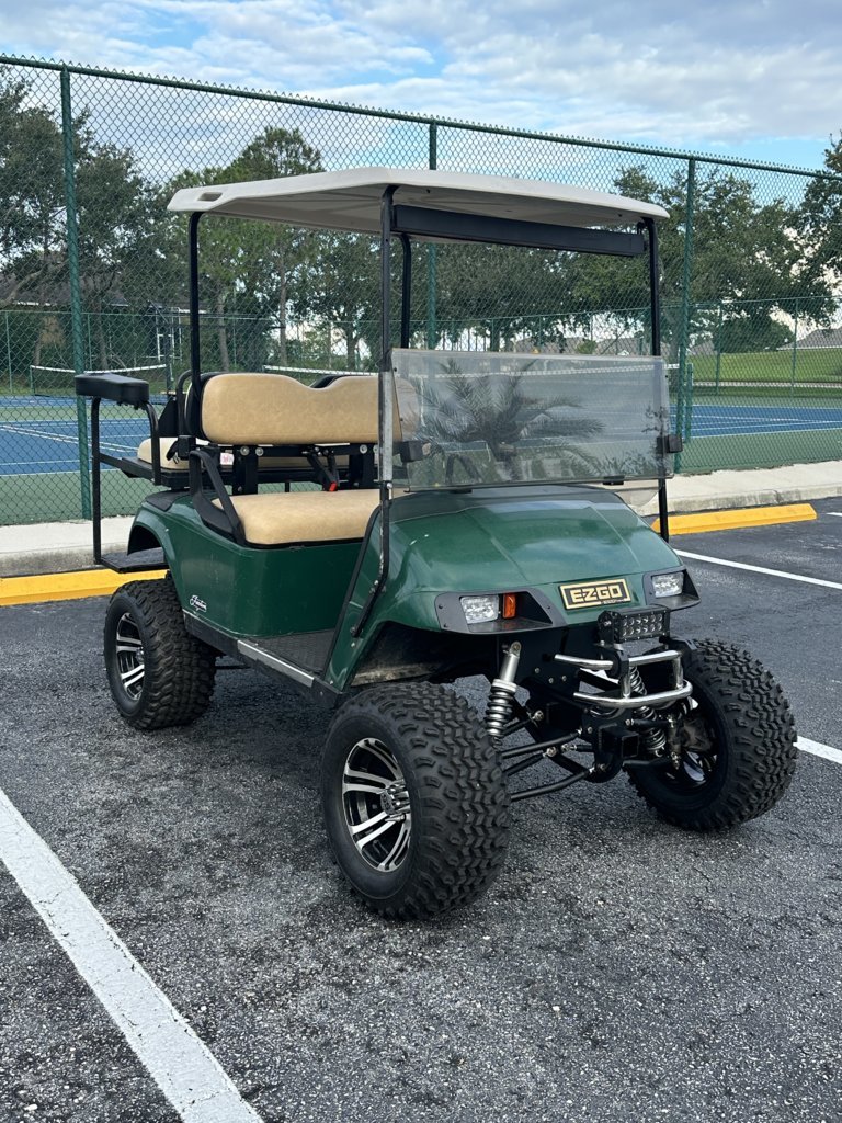

    Spent quite some time in the garage this weekend.
    The pool pump failed us after the storm. Not sure what happened but a new one is on it's way.
    Golf Cart: the never ending project...
    - New brake cables
    - new brake assemblies
    - new rear axle bearings
    Still experiencing a slight wobble in both rear wheels but I think that it's due to the rear hub assembly. I checked the axles today and they seem straight. The new axle bearings in the rear are definitely noticeably smoother.
    I have a few things coming this week:
    - fender flare kit; wet pavement kicks up a good bit of water and debris.
    - rear drum/hub assembly; new pads aren't quite grabbing right and the wobble still exists. This is all I can think of that's causing the issue. It's not the axle, it's not the bearings, it's not the spacers and it's not the wheels.
    - new brake pedal pad; I think it's why the brakes aren't working right. It's not sending signal to the time delay module which, definitely helps with the stopping power. Everything else works except the brake lights.
    - d rings and cargo net for the cargo area

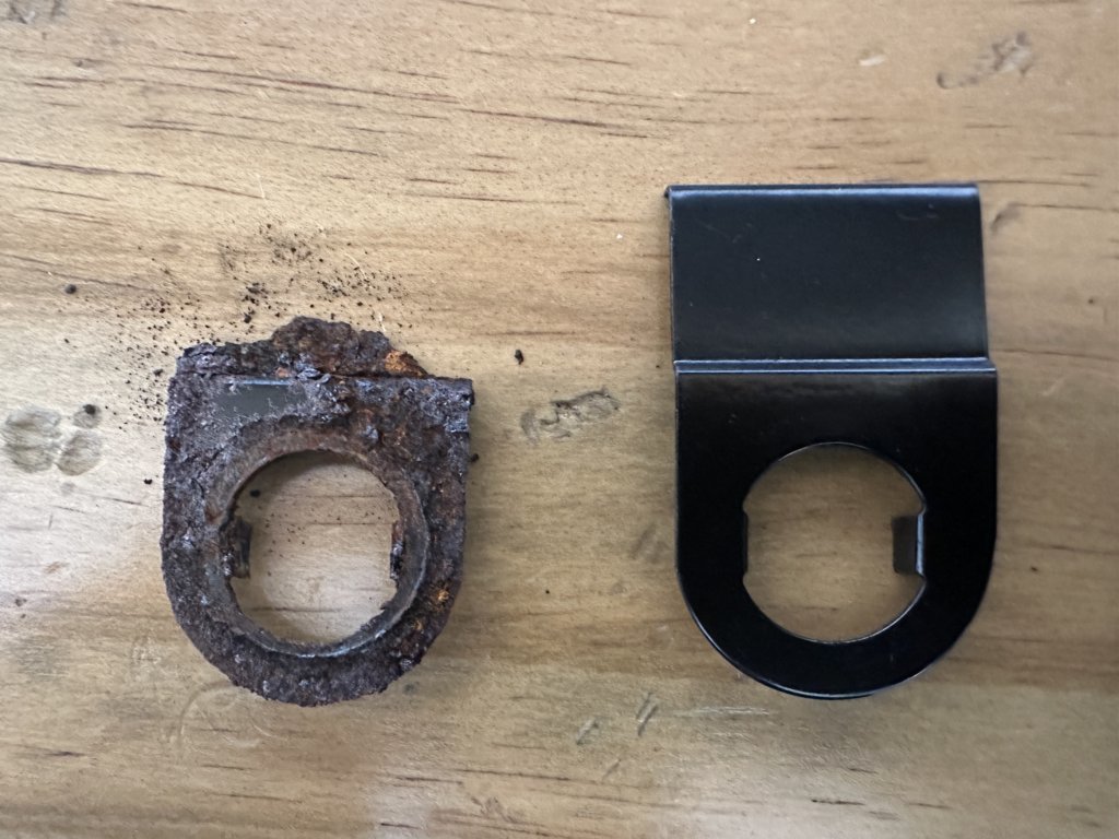

    - topper door lock retainer clips; thought I had one on each side so I had two but the passenger side had both that looked like the following:
    I have two more coming and I have 4 grommets coming to help with the rusting. Simple fix once you remove all the old rusted pieces between the trim and glass.

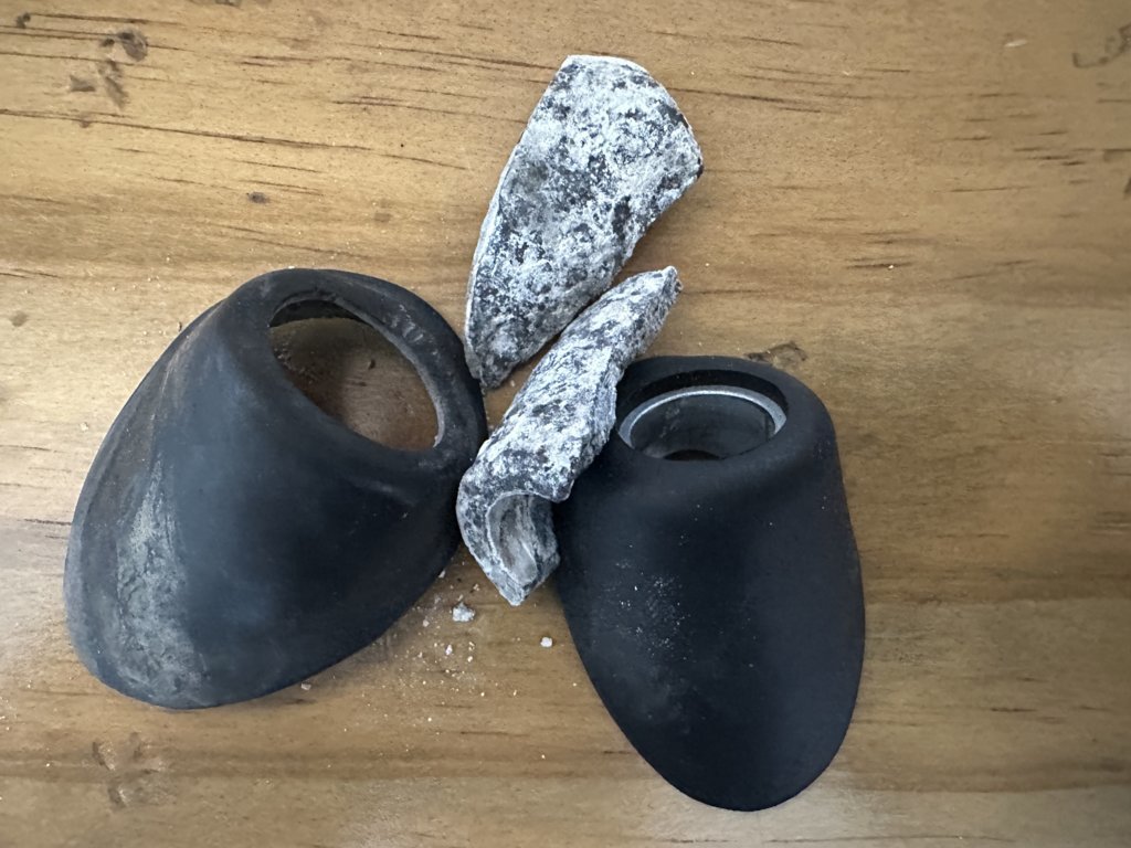

    Finally swapped my antenna base that disintegrated...

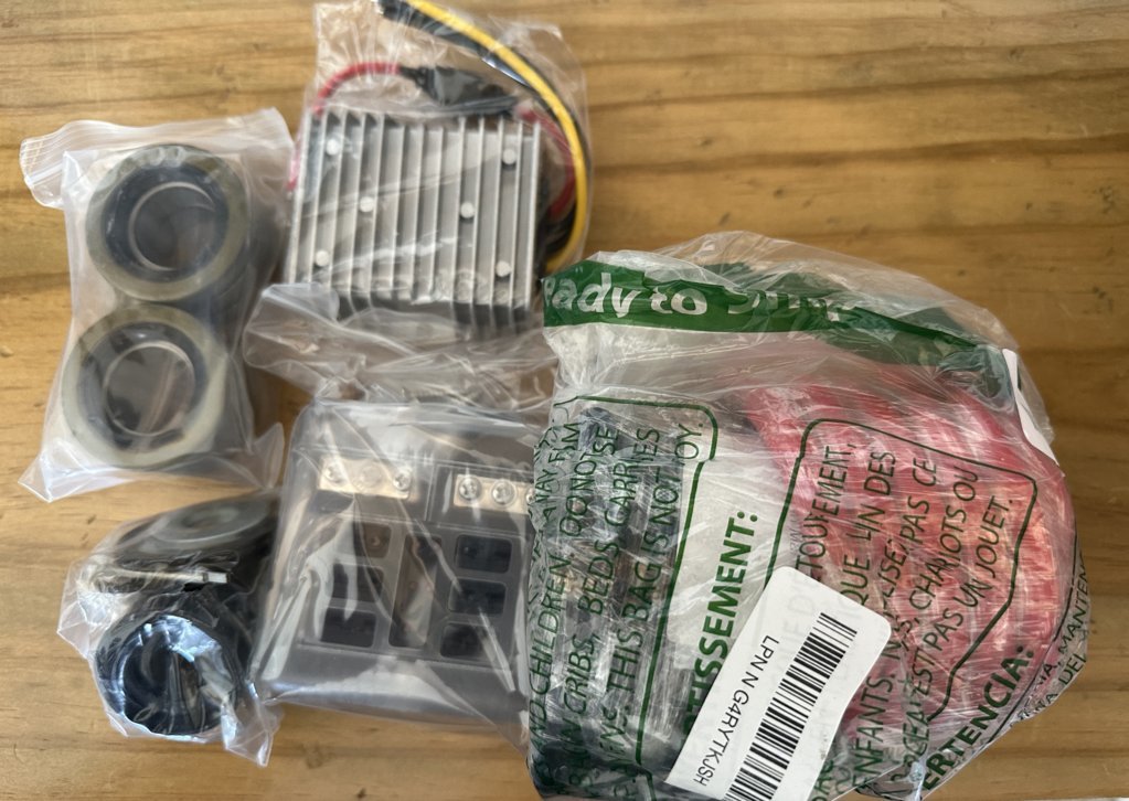

    Received my fuse panel, 12V reducer and cables for the fuse panel. Also got my front and rear axle bearings, too. This stuff was delayed significantly due to the storm.
    I'll get tot he front axle bearings once the rear is finished up and the brakes are set.

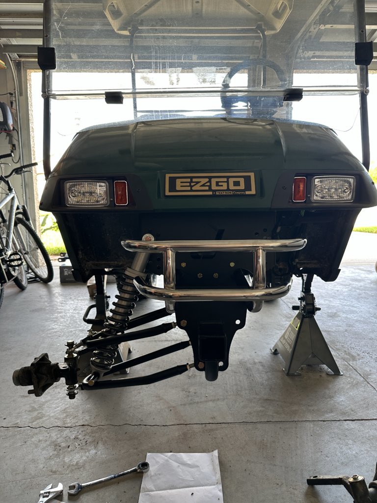

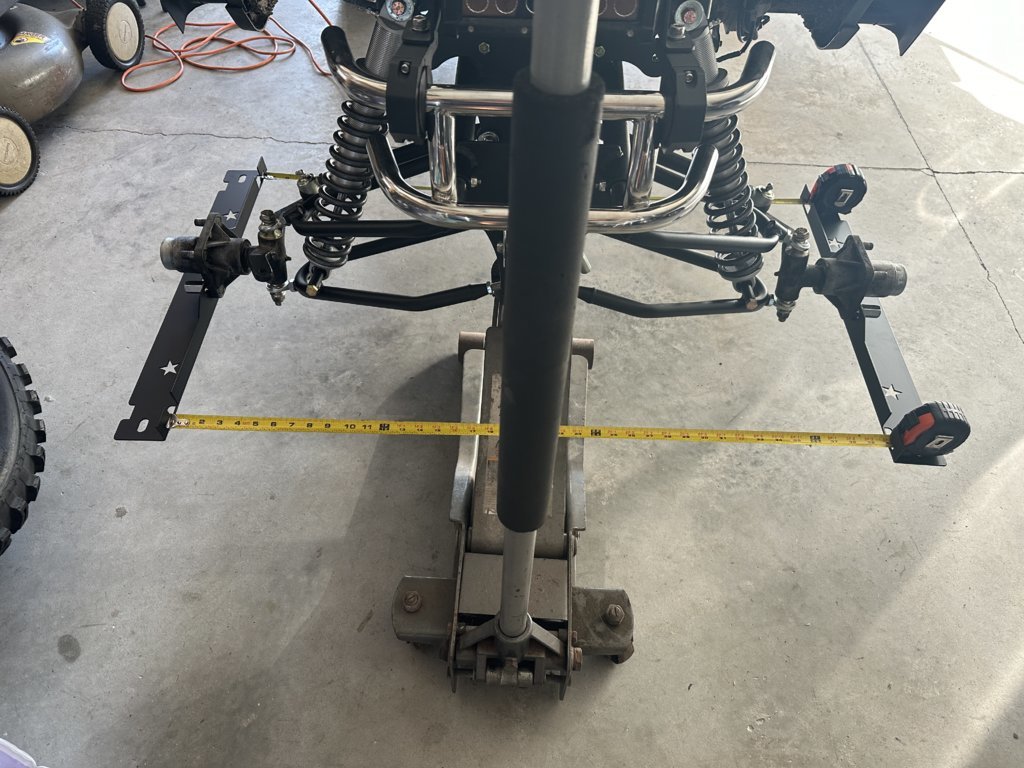

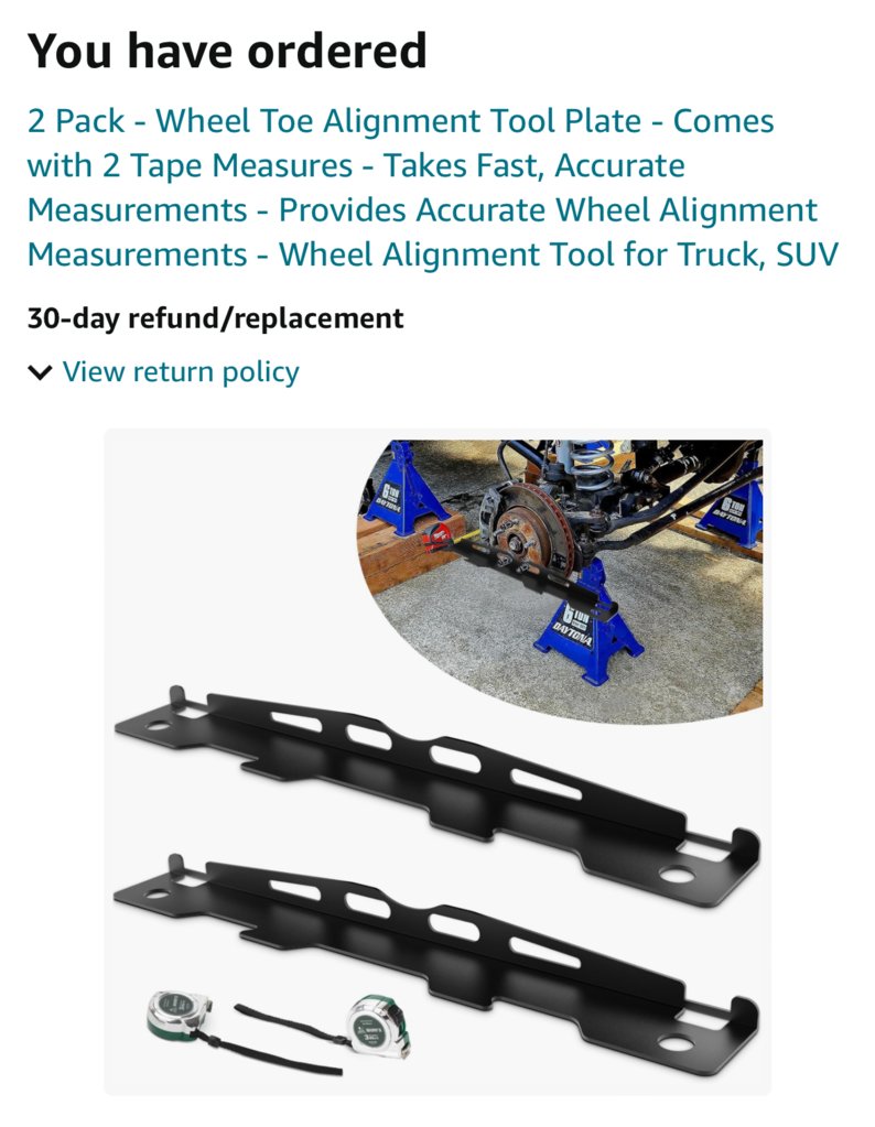

    I have succumbed to science and not "best guess".
    Eyeball alignment is OK. But, this thing gets converted to lithium and get double the juice out of it, the alignment can't be "OK".
    I really like these plates versus the traditional ones. I won't need an extra set of hands.

    1) pool pump is fixed and working! Old motor seized up pretty fucking good. Gonna have it rebuilt and keep it as a spare on the shelf. Had a celebratory jacuzz.
    2) toe plates came in today and the thing was only 3/8" toe-in using my eyeballs. Got it dialed in and drives like a dream!

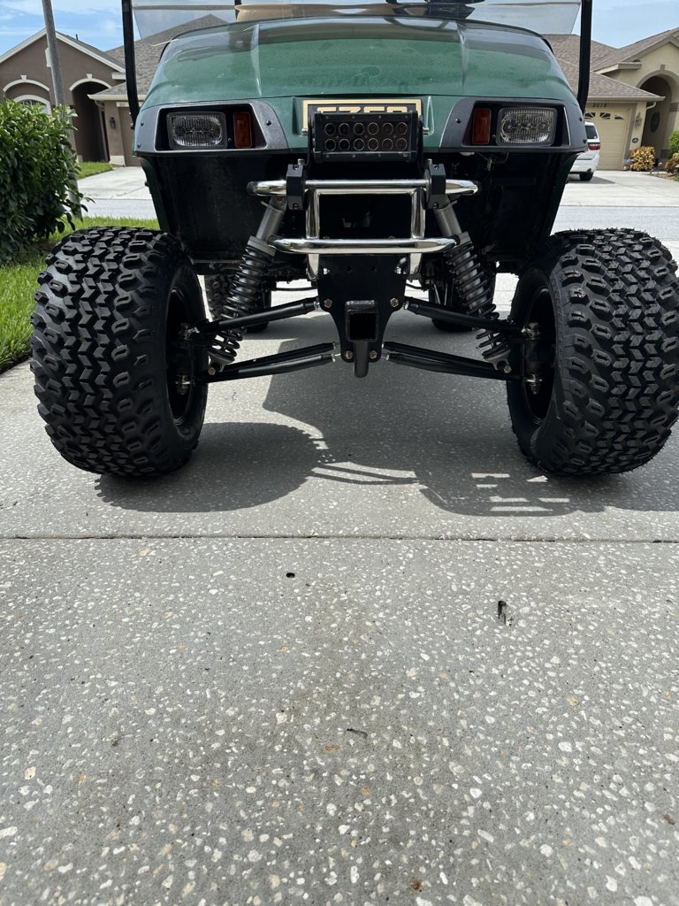

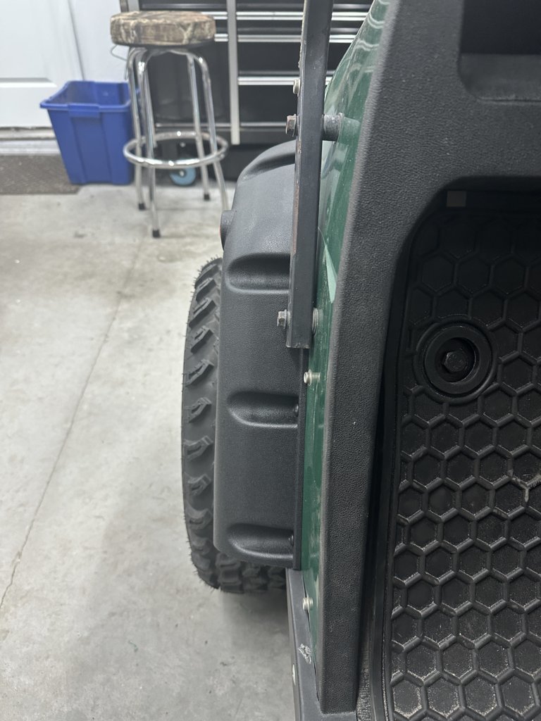

    3) got the fender flares on the golf cart; only snapped a photo of the fronts today that I did during my lunch break. Got the rears finished up after work when 2 sets of hands were available. Took some thought and modification, but definitely happy with them.

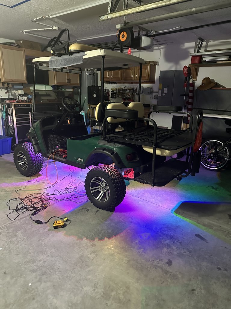

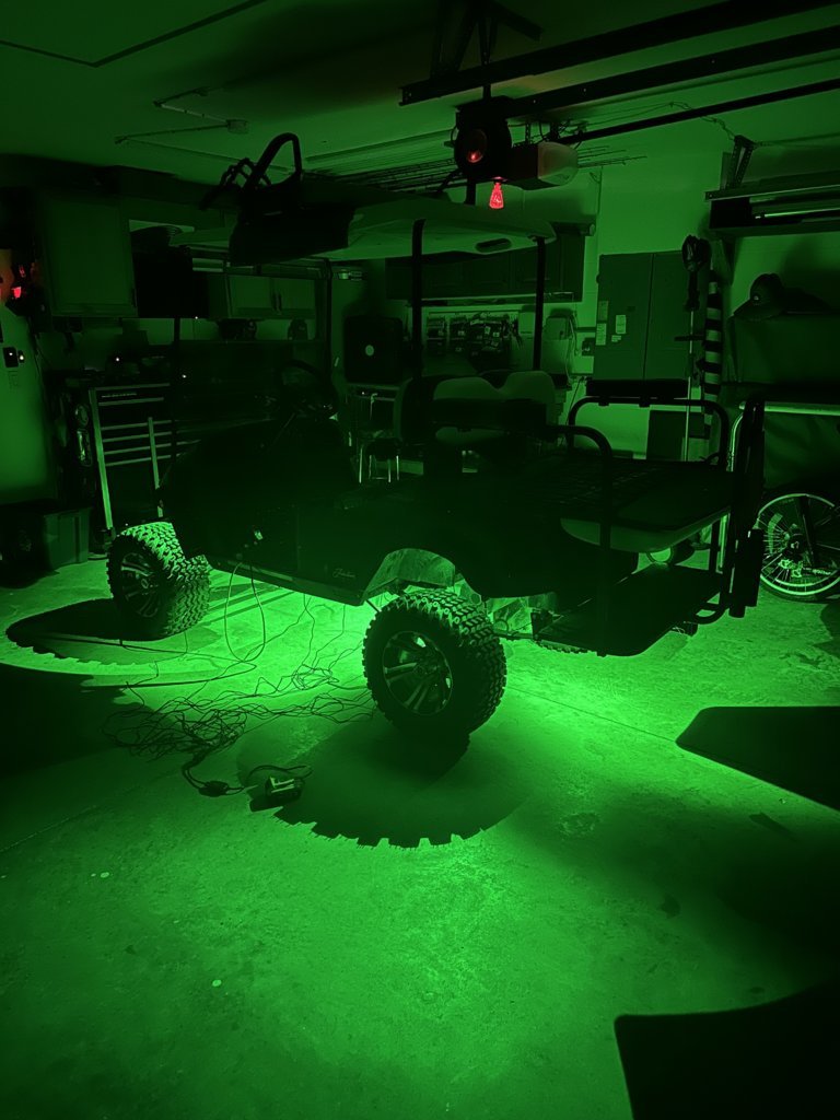

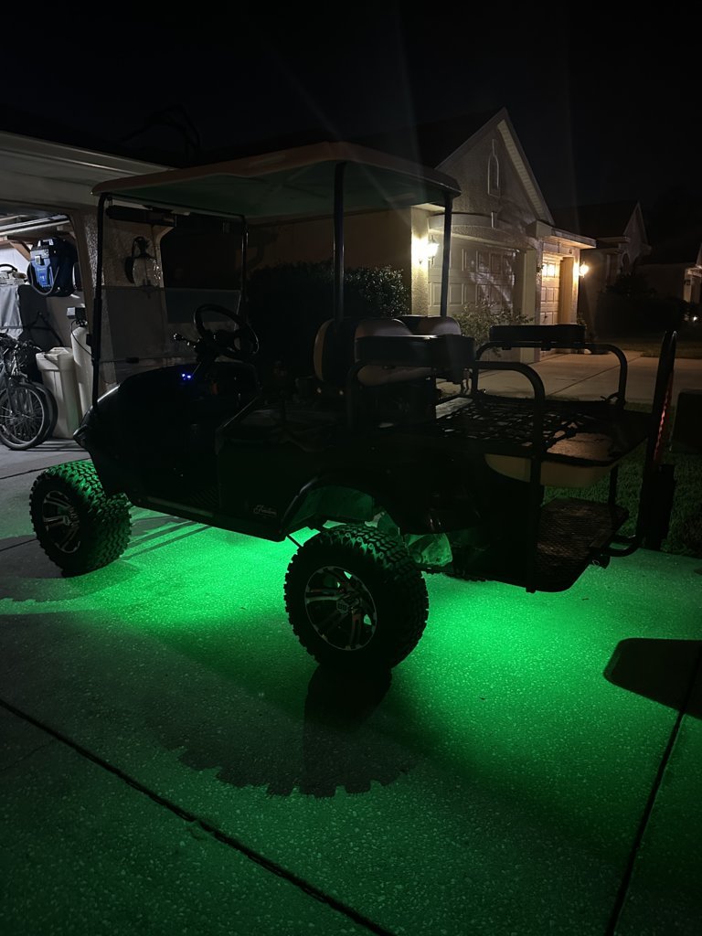

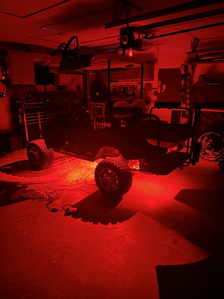

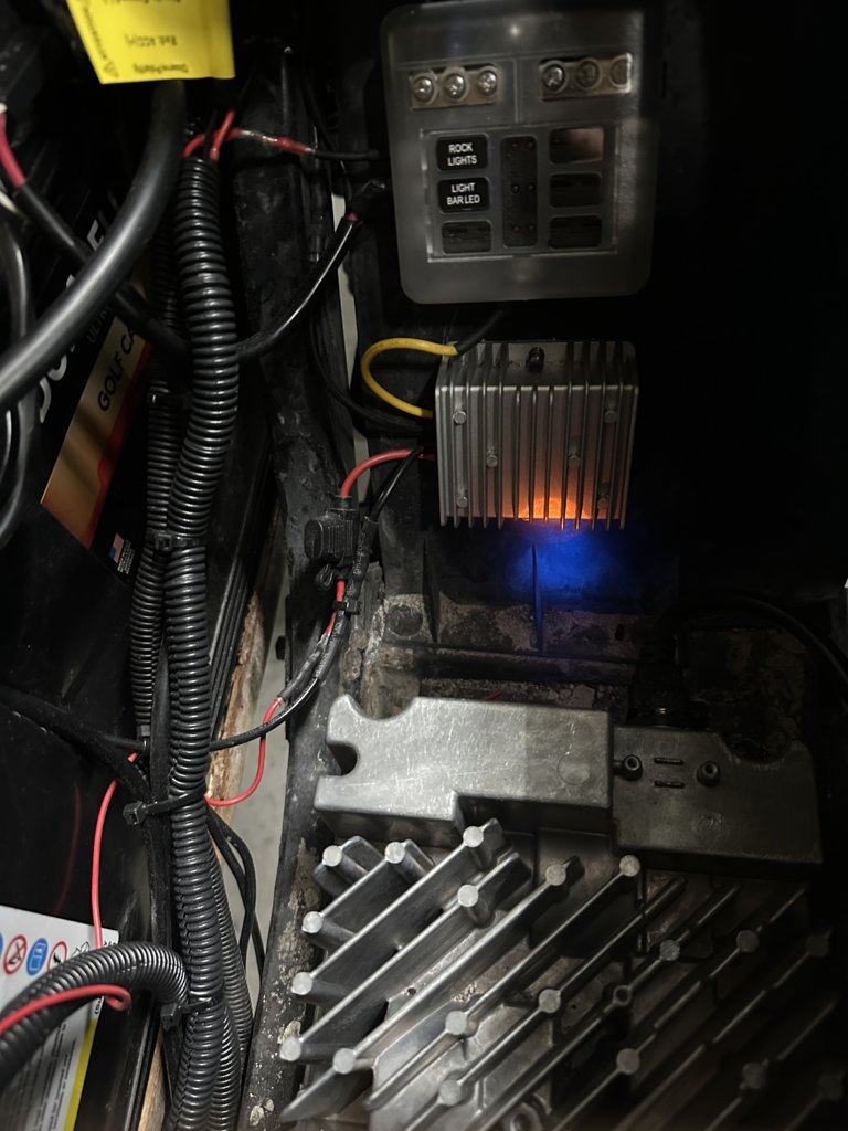

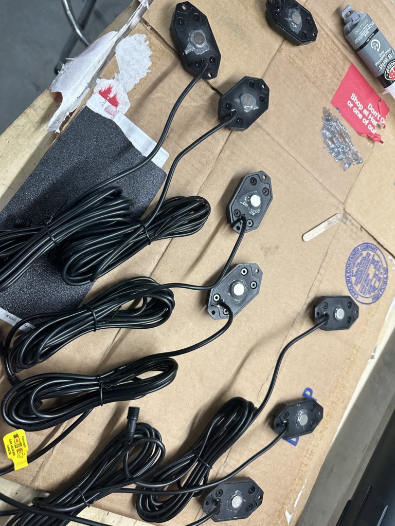

    This was a project that was out of my comfort zone. I absolutely hate and despise wiring.
    - Amazon rock light kit
    - 6 way fuse block panel
    - 36V to 12v voltage reducer
    Got the rock lights fitted with rare earth magnets I had laying around:
    Testing placement and brightness:
    10 pounds of shit in a 5 pound bag:
    I have some small cleaning up to do, but the test drive tonight was successful.
    Currently have the light bar and rock lights on the 12V circuit. It has its own switch so it's not constantly on. I might move the USB ports to the panel, too, but undecided.

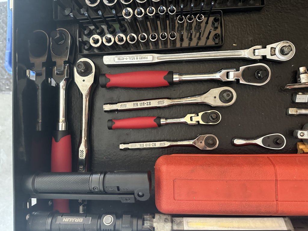

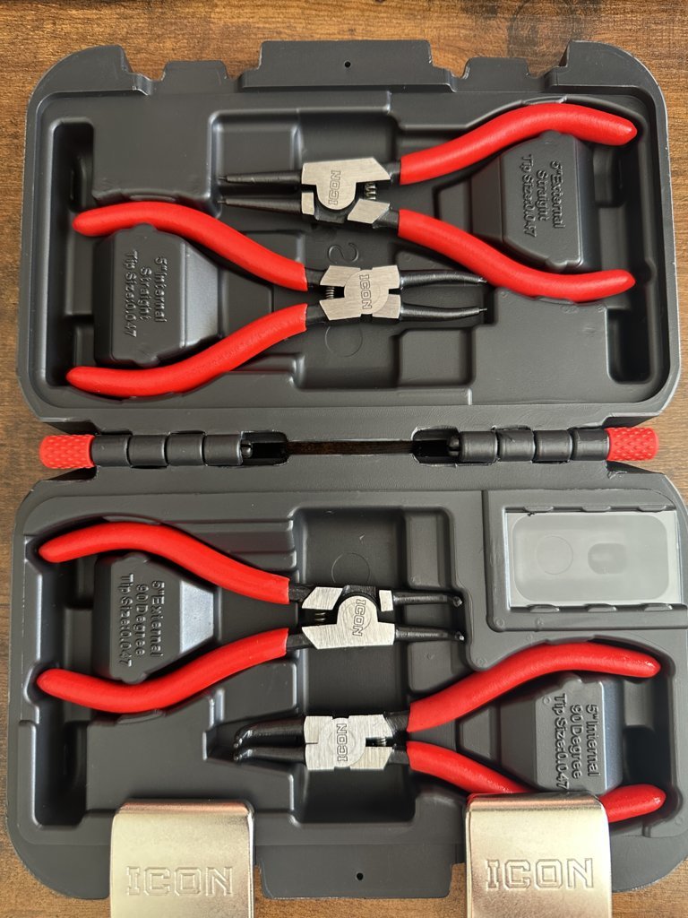

    NTD..
    My HFT adjustable snap ring pliers broke after 10 years..
    Restocking the electrical supplies after the golf cart dwindled my stock..

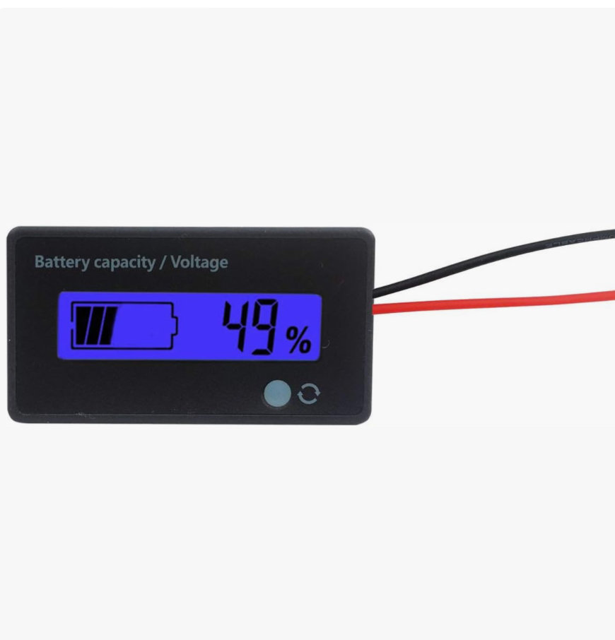

    I want to get the dashboard display LEDs and switch LEDs to all match, too.
    I'm going to move the USB charging port to the fuse panel on the 12v system. The battery capacity gauge above does voltage too, so I don't need 2 meters reading one system.
    Being able to toggle power from the USB port is a nice feature, too. It only needs to be on when/if it's needed. Not 24/7.

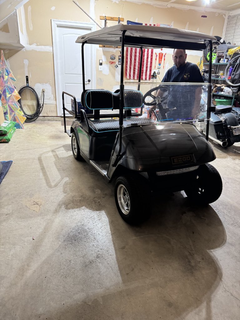

    My neighbors ez-go. Light up seat covers too

    He put a carbon fiber dash and steering wheel, and a Kicker sound system
