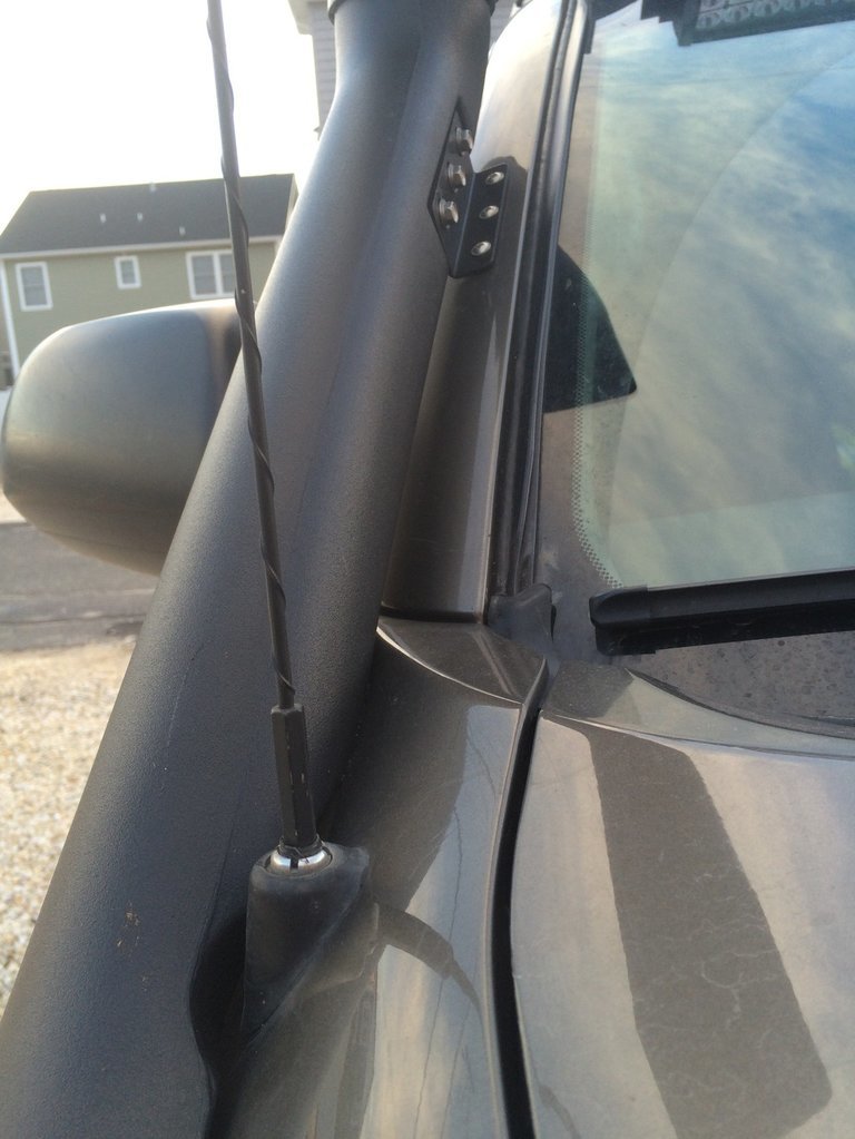

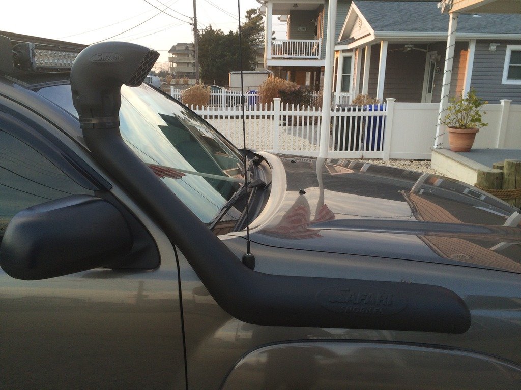

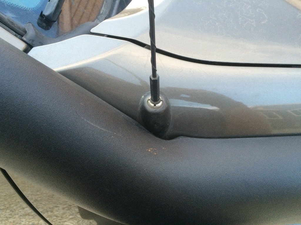

    Dude I just remembered!! STOP!
    You have to put the template on the fender on the truck. We adjusted the template back twords the rear, having the paper template about an inch hanging over on the door seam. This lined up the snorkel better on the pillar. You can not simply line up the template on the fender lines and go by the antenna. I would say the template is a reference source but not an exact fit. Just would hate to see you set up the fender with the snorkel then not have the bracket line up on the windshield pillar. I kept holding up the snorkel body best I can to make sure everything would line up.
    My antenna isn't centered, here's some reference pics
    AE883D8F-10E6-4027-8243-88D617E8A6C2_zps_84dc3ba61fda1d407266b988ec4b1e54dcc75256.jpg
    34870F58-12E8-4DA5-87E9-E33AD6E4F176_zps_376aaa4d9cfeaf37381b11eecc0e6bfffe8ef53c.jpg
    DBA0B313-5617-46F3-83EC-693E8A6268F1_zps_2ca15922c0ea7245b6d665712df89eed2729ace8.jpg
    Everything I said is in my experience, just letting you know there are variables to the install.

    Thanks man! I'll reseat the template tomorrow once the fender is on and before I start any hacking. Appreciate the help Chux!

    No probs. Just set the template then hold up the snorkel in refererance to the template, then eye ball the pillar, antenna, bolt holes, and main intake hole. See if it's to your liking and go for it! Good luck :cheers:
