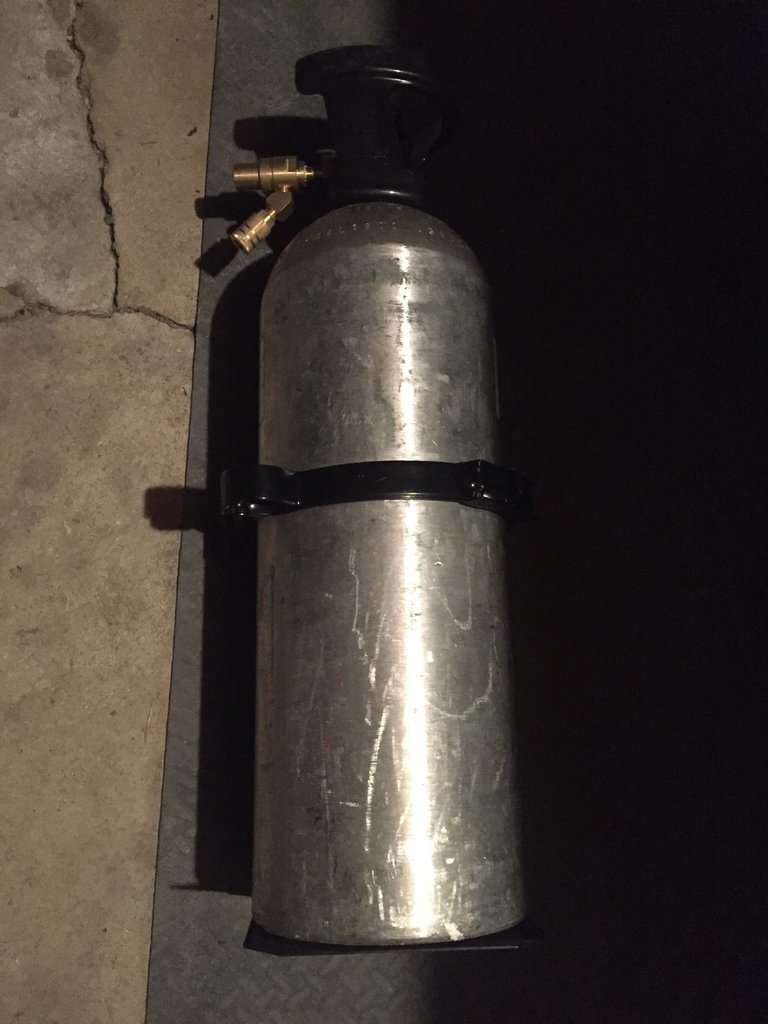

    Well I took a couple hours today and got everything done that I wanted to this weekend:

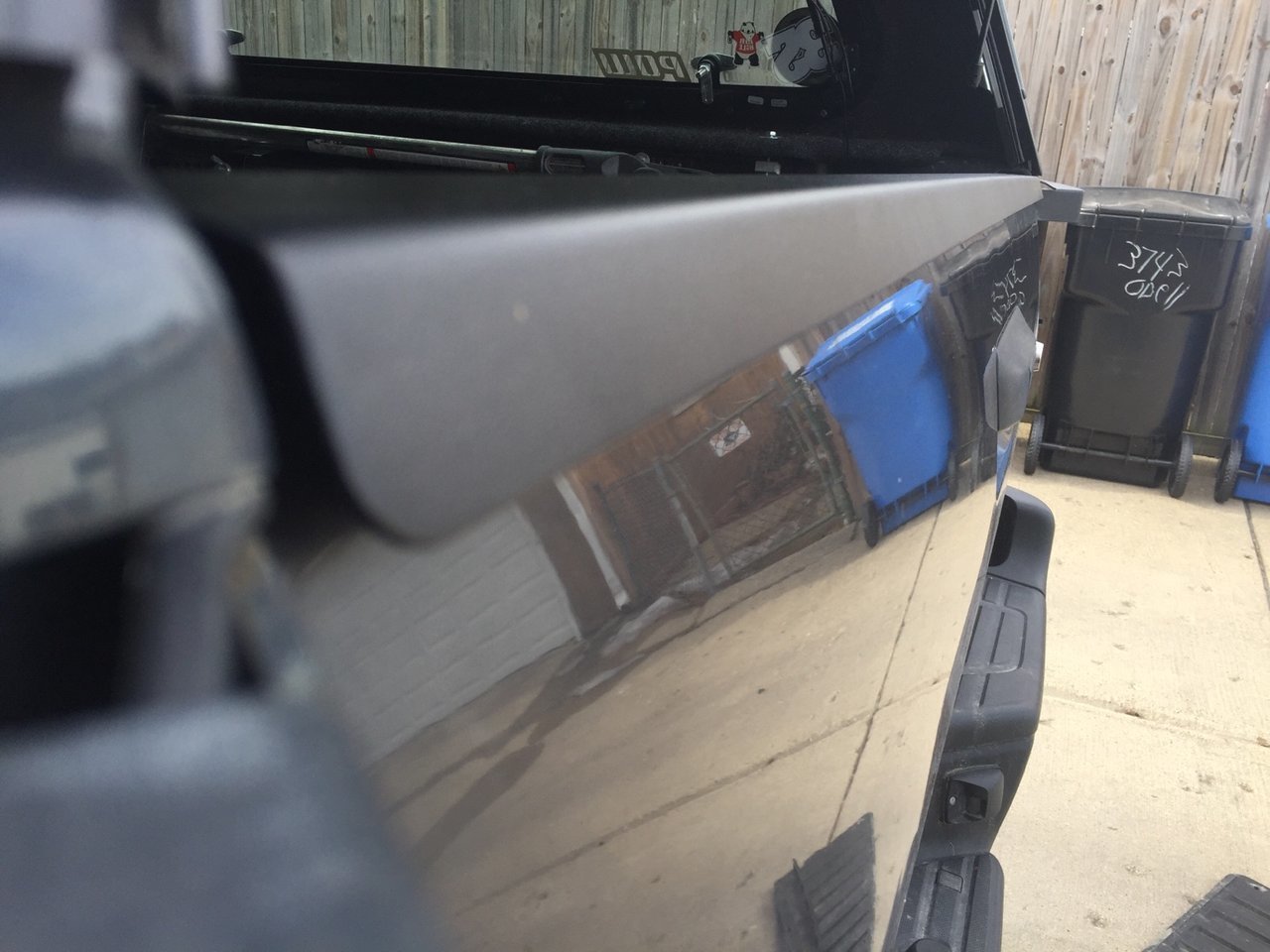

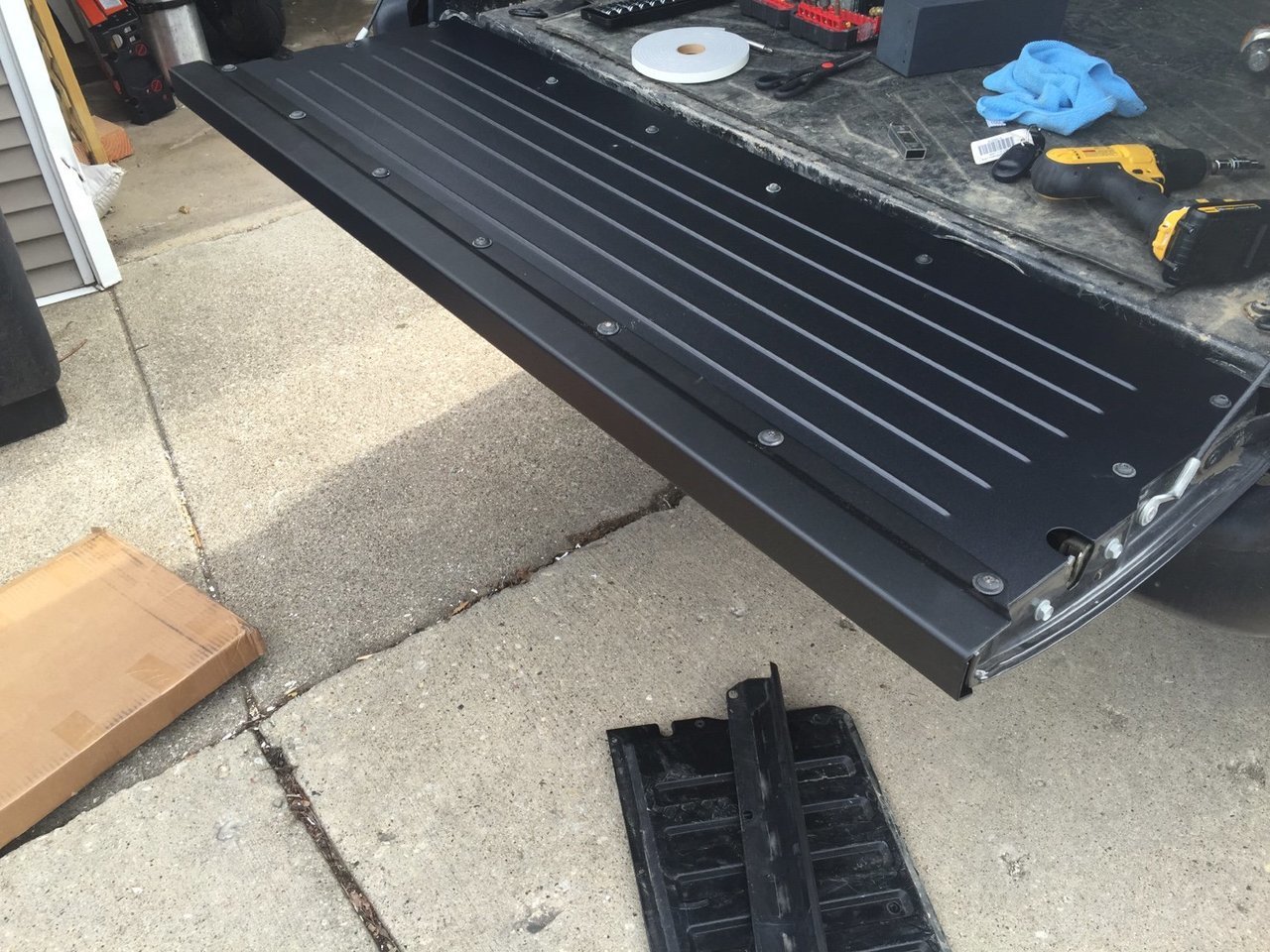

    2. Installed KB Voodoo's tailgate cap from Christmas and Mobtown offroad's tailgate enforcement plate:
    Makes the tailgate so much beefier and heavy!

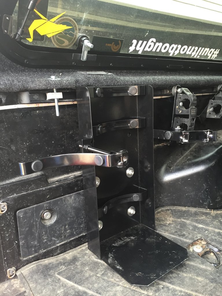

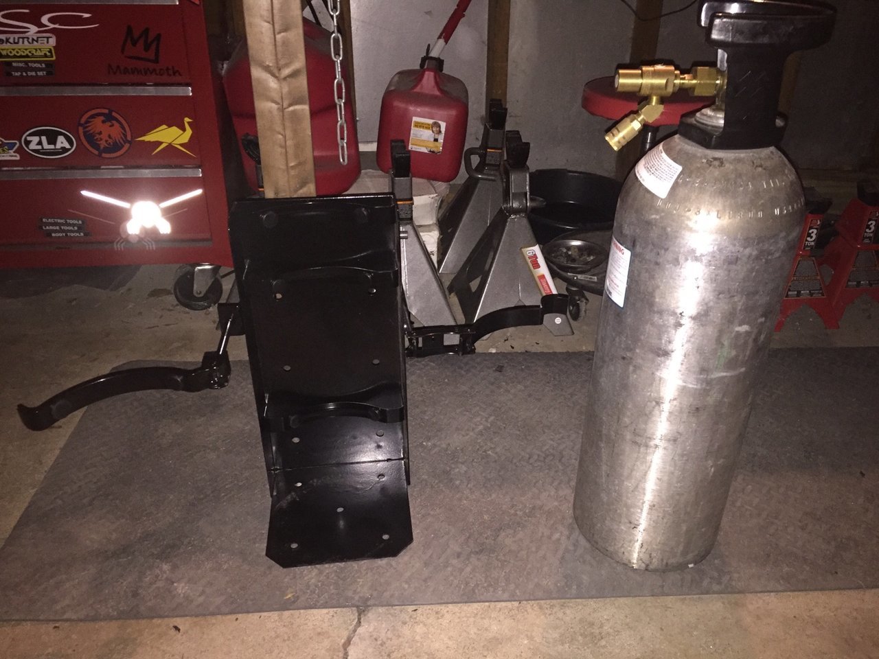

    3. Mounted the Wheeler's CO2 bracket and the CO2 tank for full #EAF points!!

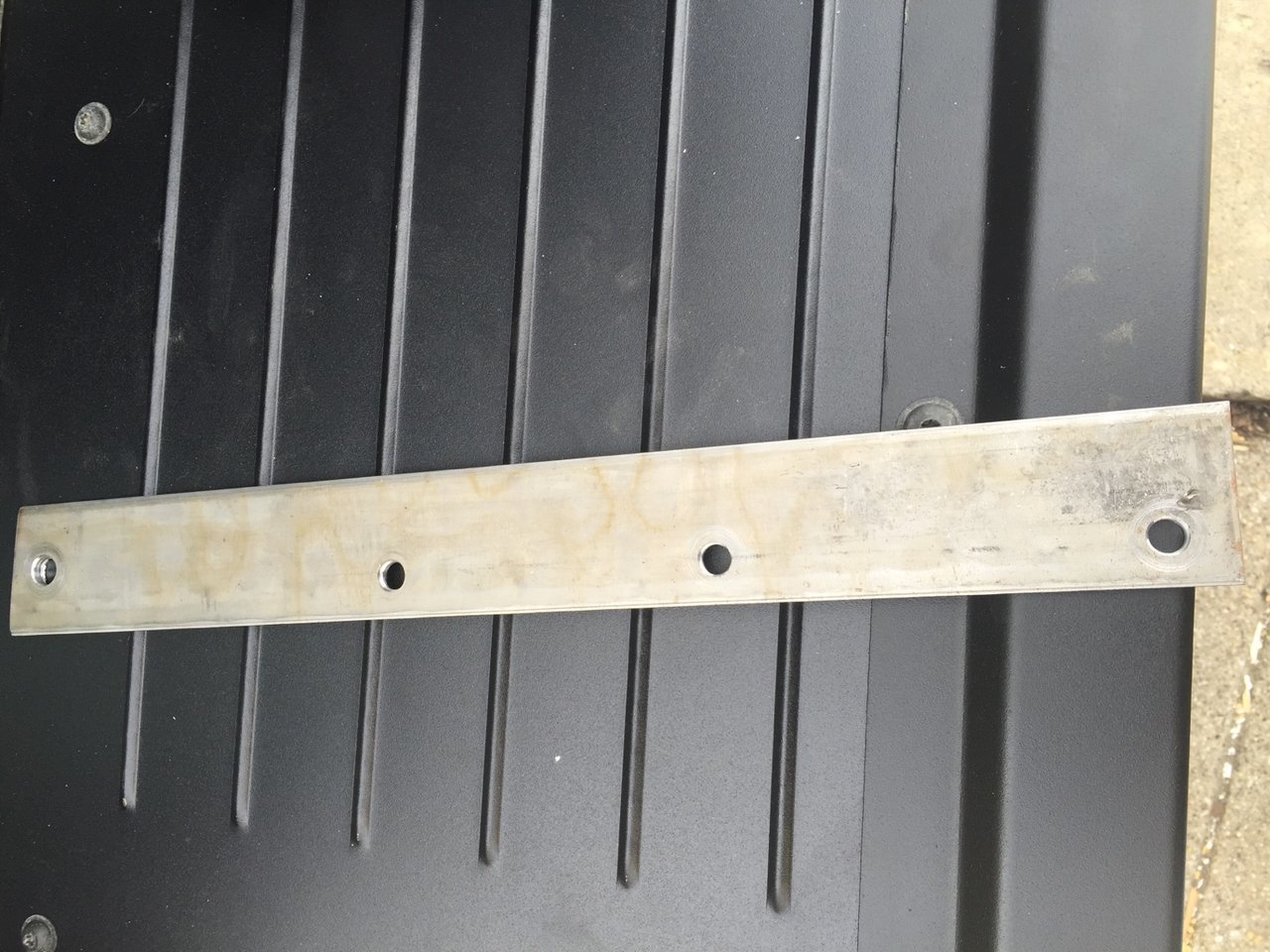

    Took some flat steel I had laying around and drilled some holes:
    Take some nuts and bolts and washers and attach the steel to the bracket:
    Mount the bracket and steel to the bed rails with tslot nuts:

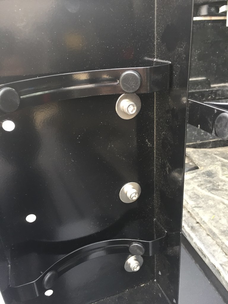

    Mount the tank in the bracket:
    Done!! No issues after driving around for about an hour already! Looks killer!!

    How long of an air hose did you get? Long enough to keep the tank mounted in the bed while filling?
    Also, take a pic of that regulator when you do your 1st real air up from a trail ride. I'd like to see how iced over it gets please.
  17. Jan 31, 2016 at 6:30 AM
    #1577
    geekhouse23
    geekhouse23 [OP] The "Liftman" - @DrFunker
    Jul 14, 2013
    #108251
    15,716
    2GMGMDCSB4WDTRDFTMFW!! TL;DR
    mostly stock, grocery gettin' Prius
    I got this guy: I have heard that with the coiled hoses, you cannot reach the hose to the full length without it being really hard to uncoil.
    I still have the ARB hose for my OBA compressor under the hood that reaches all fours without issues. I'm not sure if that hose can handle the pressure of the CO2 tank? :notsure:
    I'll have to see how heavy the tank is filled and decide from there if I will use the Harbor freight hose or the ARB one instead (moving it around could be a bitch). I guess if I wanted a CO2 rated hose that can reach without issues, I'd get the IAS hose: http://www.instantairsupply.com/par...25-flexeel-braided-polyurethane-air-line.html
    I'll take pics of the first use for sure! Perhaps just a mini write up
  18. Jan 31, 2016 at 6:40 AM
    #1578
    2ndGenJonny
    2ndGenJonny Well-Known Member Vendor
    Jan 3, 2013
    #94306
    18,457
    Jon
    Gilbert, AZ
    The straight ARB hose is probably your best bet even though the clip on end they use is shit. The regulator should be whats keeping the pressure in the bottle and feeding the hose. When I do this I'd like to use a "shop style" hose with quick disconnect. That way if I ever want to run tools, its an easy hookup. Plus shop hoses roll up easy.
