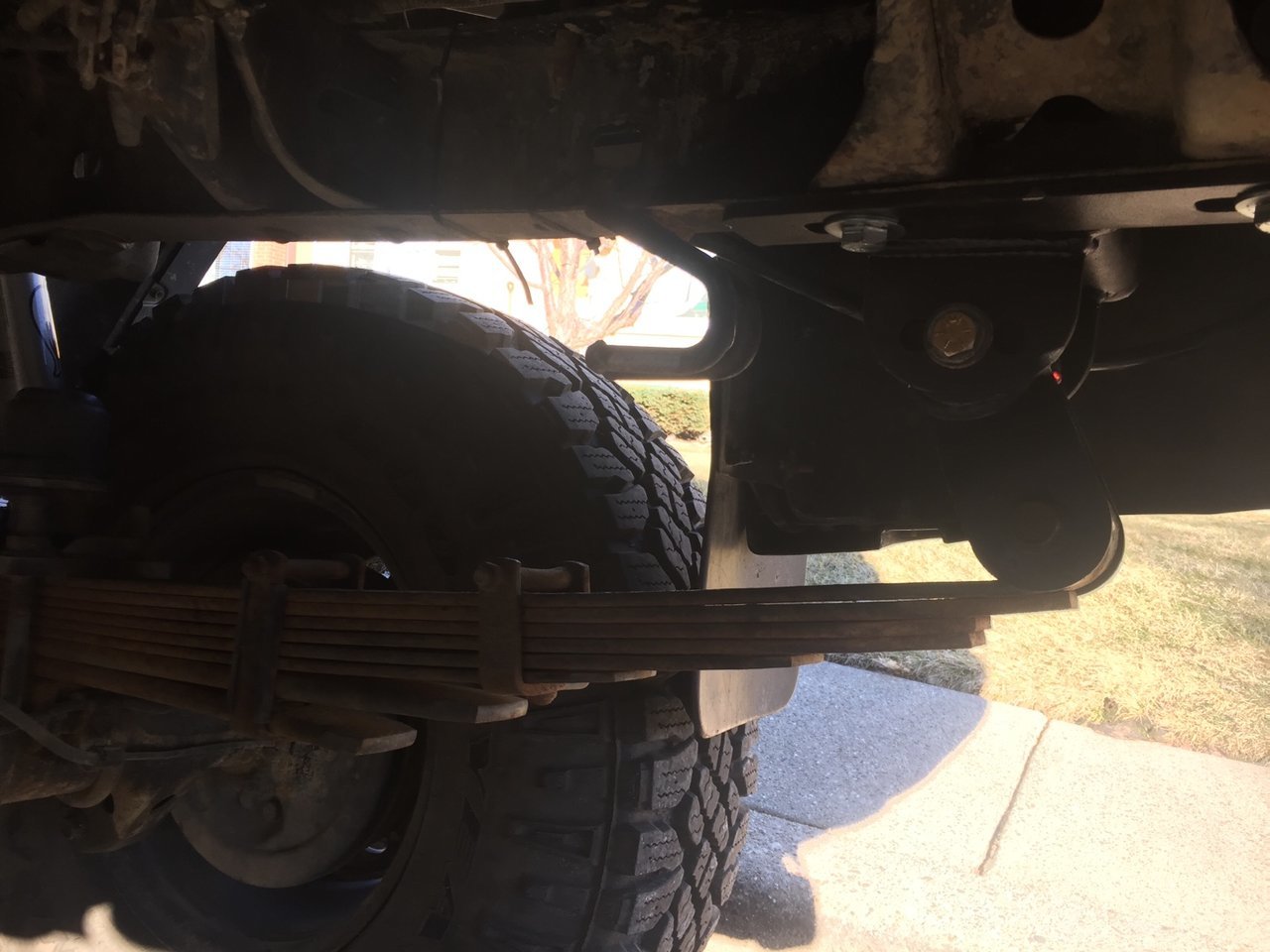

    How come you are bolting the flip vs welding?
  7. Feb 20, 2016 at 8:11 PM
    #1627
    ChandlerDOOM
    ChandlerDOOM International tent trafficker
    Nov 4, 2013
    #115943
    3,838
    Chandler
    STL
    Truck
    37s yo
    Probably for the adjustability since he has different slots, easily adjust it down the road if needed

    This. Adjustability came in handy last night.

    What the fudge why so much rake? Those shackles add that much?

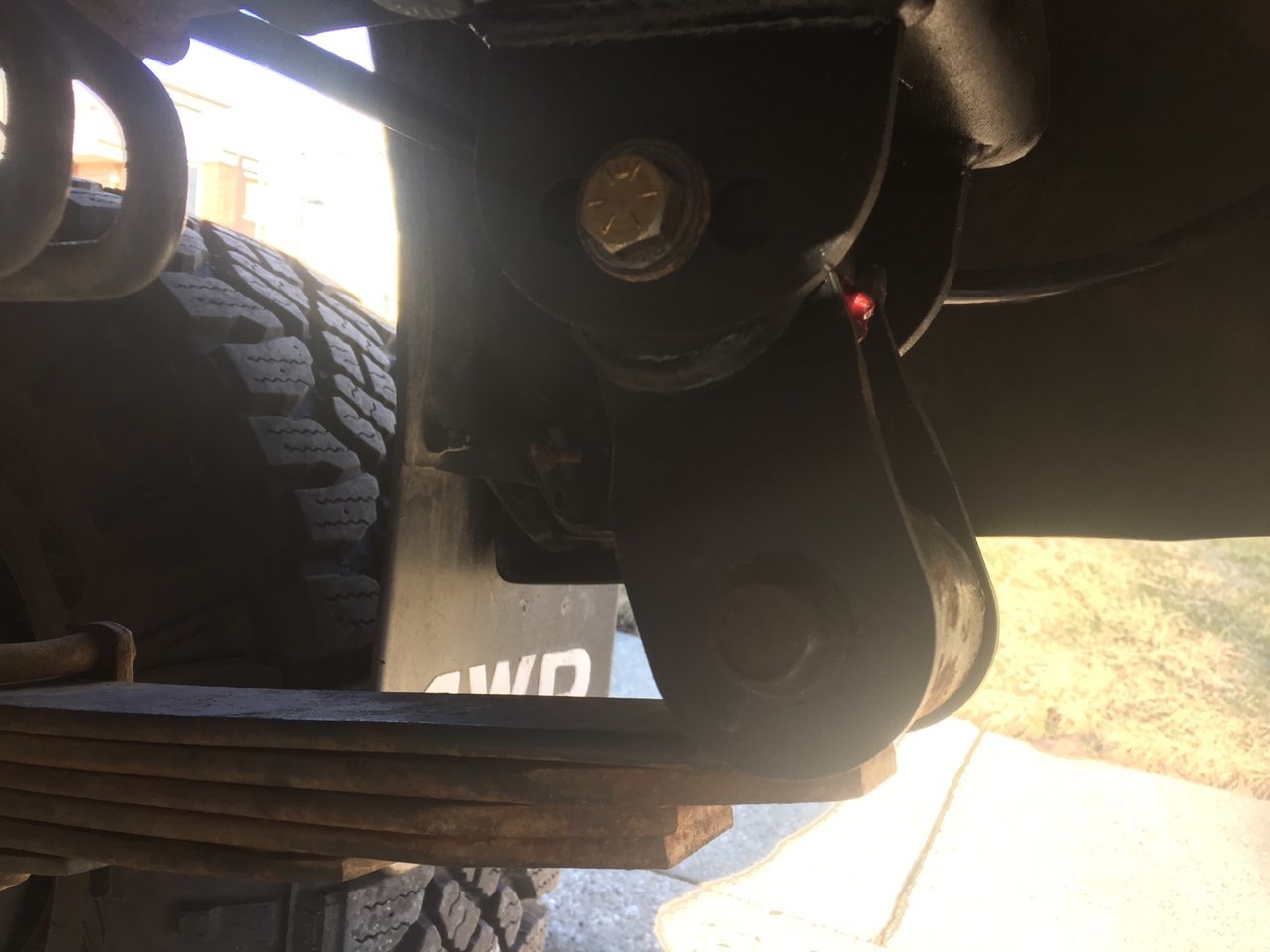

    Am I doing it right?
    They're stock length replacement shackles from ATO...
    I guess @ragincajun35 was right...

    Put the shackle in the most forward hole, shackle flip should only add 3/4" lift with stock length shackles. How much did you get?

    Thats good info ^^. I already have +1" XJ shackles. Im going to weld mine down though

    Started with an air hammer, that failed..bad. I think a deal blew. Then moved to the grinder and cut off wheels and that was working for about 80% of everything. Finished them up with a 3" air cutoff wheel for the tight spaces. We utilized the air hammer punch bit and a BFH to punch the rivets out after using an air drill to drill out the river shafts. Once we got the process down, the rest were easy.
    The biggest pain in the ass was the tack welds Toyota places on the heads of the bottom rivets.
    I know ragin said that with his stock ATO's he was +2" rake..need a Pelfrey steel HC with swing out to take care of that now :wink:
    Weld shackle mounts? Makes sense for you since you're boxing the rear and the bed will be off..
