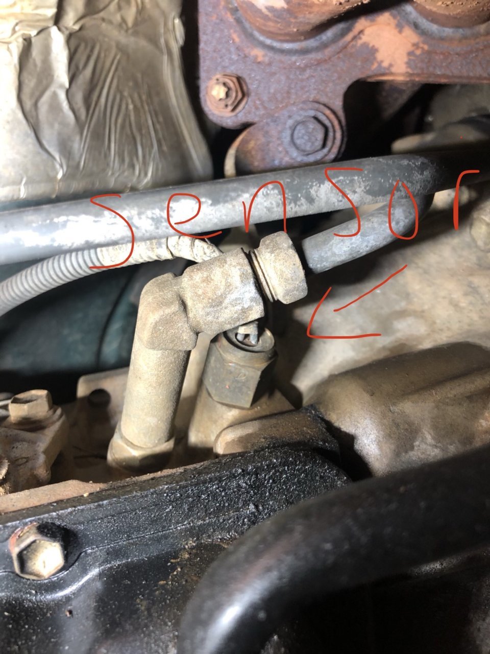

    Also here is the temp sensor location on my 1999 trans.

    Thank you, I’ll have to take a look at my truck.
