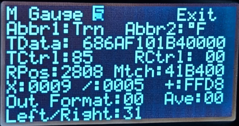

    I recently installed an UltraGauge and noticed they now (instruction revision July 1, 2021) include instructions for monitoring transmission temperature on 1st gens. All of their code is the same as @GLR except for the X and /. He has an X of 0009 and a / of 0005. UltraGauge shows an X of 0001 and a / of 0001. I've only plugged in the UltraGauge given values, but I wonder if anyone has run the OP's values and then changed to the UltraGauge values and noticed a difference?

    if you have the iltragage and it pops up with a code that start with 19 you will have to go to to m gauge and put these codes into all of them I had to put it into 3 different before it finally popped up

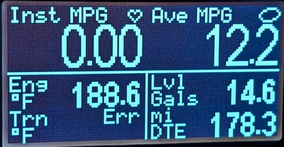

    Hey everyone,
    I have a 2000 2.7 L and I can't get my transmission temperature to work.
    Am I missing something?PXL_20250312_062030932~2.jpg PXL_20250312_062119759~2.jpg

    What transmission do you have? As far as I know this works with 2001-2004 A340E and A340F. Some earlier trucks get it working.
    The code is on your drivers door sticker.

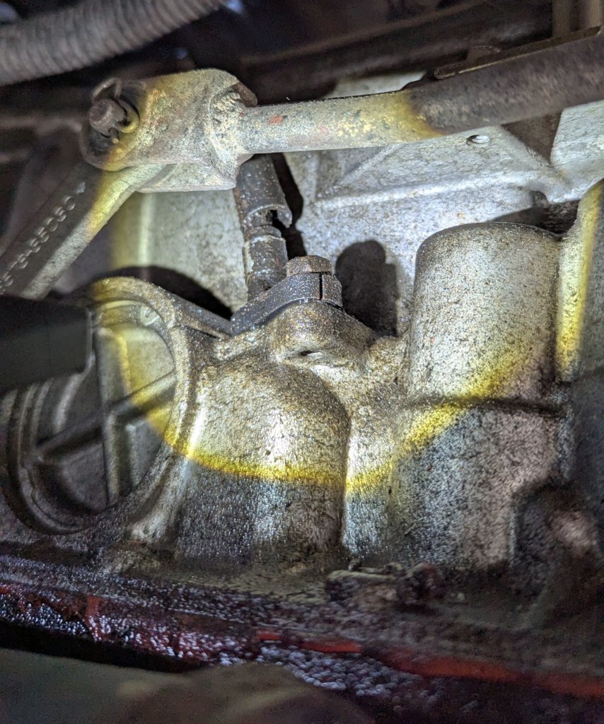

    I don't have a door jam sticker.
    Tried ordering one at the dealership, they told me that mine didn't come with one from the factory.
    When they punch in my VIN, it says not available.
    They said that they didn't always come with one back then.
    We had a 96' in the family, original owners since day 1, it didn't have a door jam sticker either.

    just trans temp, i learned the manual versions didn't come with a trans thermostat

    Heat is not an issue with the manual trans. The autos have a temp sensor because heat is an issue on them.
